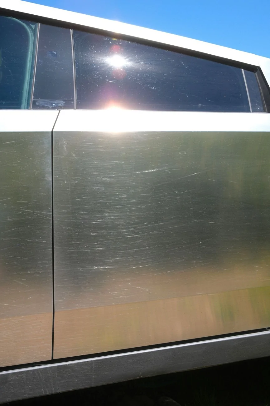

Here is one I took specifically to show the kind of fine scratches I get after driving a muddy/dirty CT through heavy brush. Branches and sapling trunks grinding mud into the finish, often for miles at a time. The light was really good and I optimized the angle of parking and camera angle to show the scratches. This is after I had polished previous scratches out and then bushwhacked for miles.
