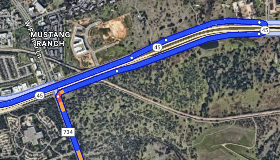

My SO often pokes fun at "stupid FSD" for making crazy navigational choices. One that comes up often is at a highway intersection, where it detours 2.5 miles to make a u-turn, when it could simply just turn left.
I decided to pull up this route in Google Maps, and sure enough:
Tesla Cybertruck FSD in rural areas and unmarked driveways - how I updated mine by submitting Google map edit Screenshot 2025-09-16 at 1.39.24 PM
I'll admit these roads are somewhat bonkers, but the problem seems to be that some of the frontage roads and on-ramps are "unnamed". Even when the dots connect, the Google algorithms seem to avoid such unnamed roads. There's even one place with an unnamed road where Google suggests I get out and walk the rest of the way! lol
I edited this area with names, let's see if it helps 🤷‍♂️
