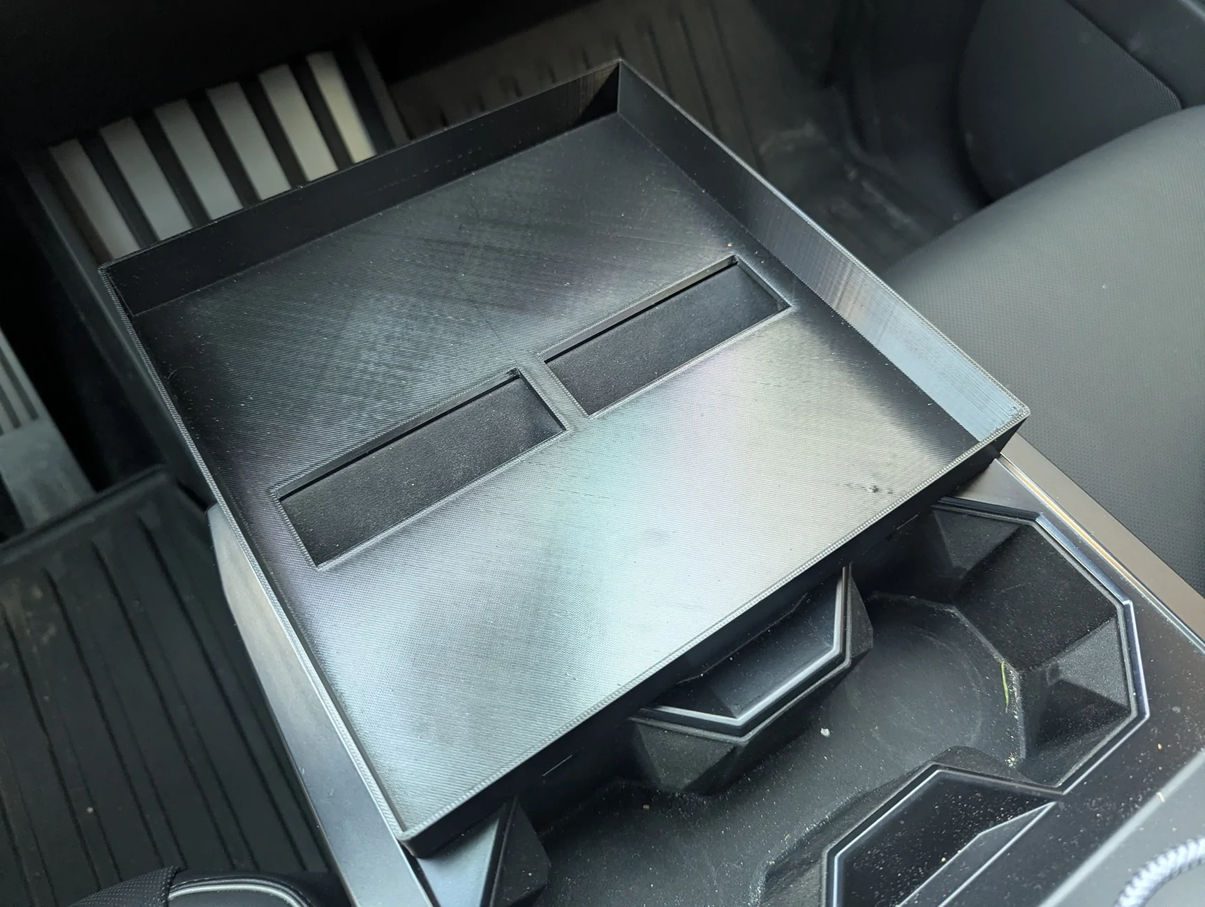

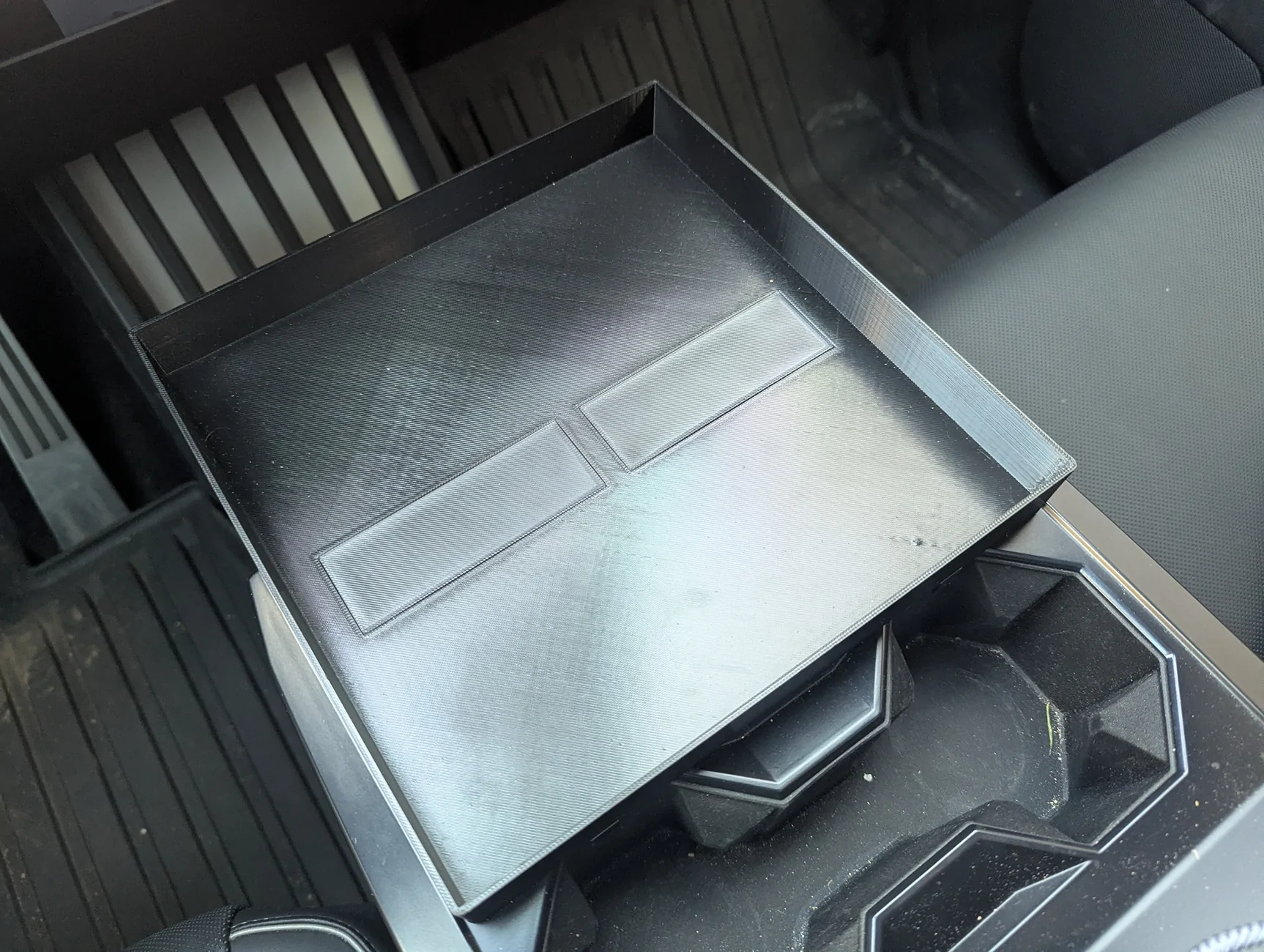

Just finished up my V2 design of a 3D printable Cybertruck Food Tray that clips in and stays put over the phone charging area. There's versions with removable charging covers so you can charge with it installed. Make it it a ton easier to eat and drive. It also has 2 removable bag hooks that hang below as sometimes I like to keep my takeout food from moving around.
Free to print:
https://makerworld.com/en/models/1783579-cybertruck-food-tray
I'd also be willing to ship one to anyone who doesn't have a 3D printer, $20 plus shipping (about $7-10). Paypal Goods and Services is fine so you have some protection. I've already shipped one out that way. Just note that 3D printed items will have slight imperfections. Send me a PM if you're interested.
I also have ideas of 3D designing a phone/Nintendo Switch holder for the seat back of the front seat since none of the current mounts for sale work with the fixed headrest seats. Leaning towards a custom 3D print phone holder on a paracord rope which goes around the seat. Here's that holder https://makerworld.com/en/models/1807833-universal-back-seat-phone-switch-and-tablet-mount

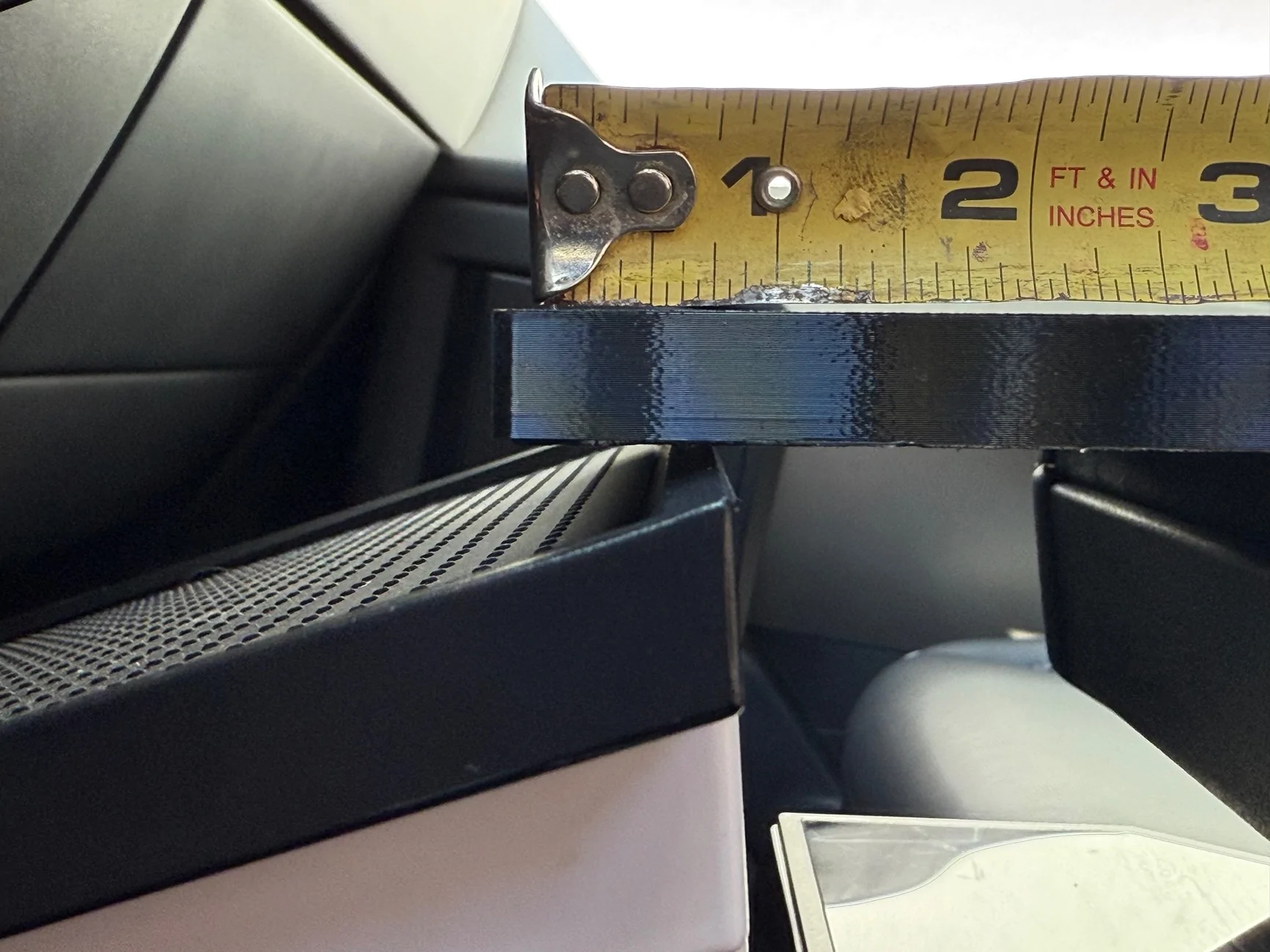

I printed v1 and the superglue made it unsightly when the superglue bled through the seam. I would make another version for a tad bit shorter for those of us who have the center console fridge, but it’s easy enough to remove and snap in.

Ooh. I have that fridge too. Didn’t realize it stuck that far forward. Slightly shorter would be handy.
@TwiztOG43 could you measure how much shorter it would have to be to clear the lip of the door as it swings up?

Definitely let me know how much shorter you'd like it , I can easily adjust it and put it up as another print profile.
Also, do you find the V1's edge height to be too short? I was worried about hard braking where a burger could probably make its way over the edge, so my current design has a 26mm interior edge height which hopefully would be enough to keep most things from falling off and I don't find it annoyingly high, but I'd be interested in feedback.
The glue was definitely unsightly on my V1 too and getting it all printed in 1 piece was my way to fix that. The V2 also fixes that scratchy sound of the print layer ridges catching when removing it since I was able to print the latches in the other orientation. The latches should also be stronger now too. I really like my V2 a lot better overall.
Definitely send me the length you'd like and I'll get it up to print. Only takes me a few minutes to adjust it.
It Looks to be about 3/4in shorter. Is the V2 with thicker walls? V1 definitely could support things, but it felt a bit wobbly when the truck is in motion, as well as the edges being a bit short. Maybe thicker walls for support and a more premium feel.
The V2 is a lot stiffer due to the much taller built in edge. There's almost no bending flex to mine at all while my V1 could flex a decent amount.
Just made a 30mm (1.18 in) shorter one (230mm x 200mm) https://makerworld.com/en/models/1783579-tesla-cybertruck-food-tray#profileId-1924004
Let me know how it works
