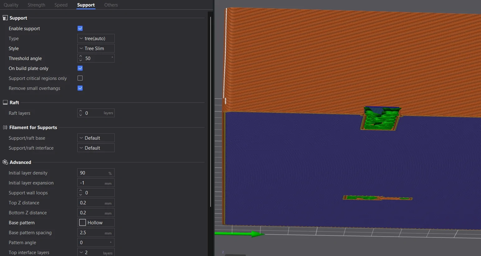

Did you use supports when printing? I don't want to try it without supports and it fails on the print.
Tesla Cybertruck 3D printable Cybertruck Food Tray 2025-09-17 17_57_18-obj_5_Cybertruck Food Tray Base V2 (1) - QIDIStudio
It has a 10mm bridge which should be a piece of cake for most printers as they spec generally 50-100mm max. I don't use supports when I print it, but you can if you feel the need. I also gave that area an additional 0.2mm of room for sag just in case. Might need some cleanup in that area if the supports leave extra residue.
