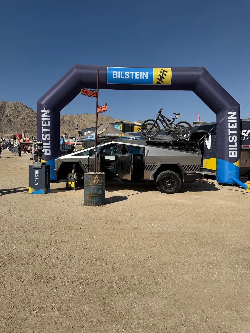

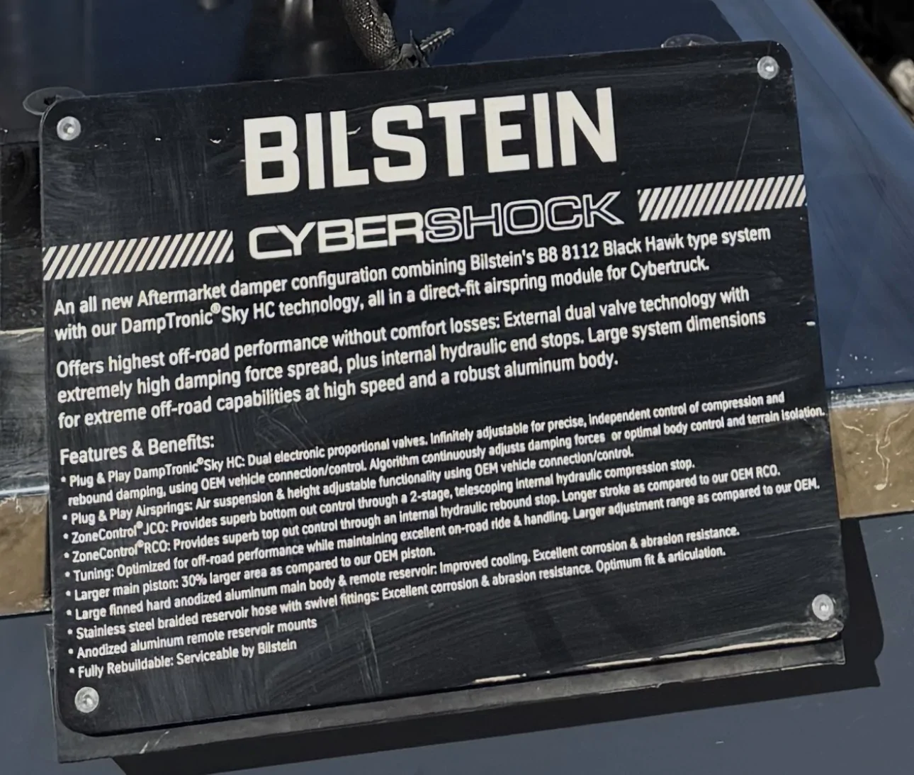

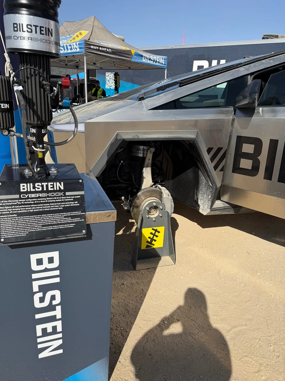

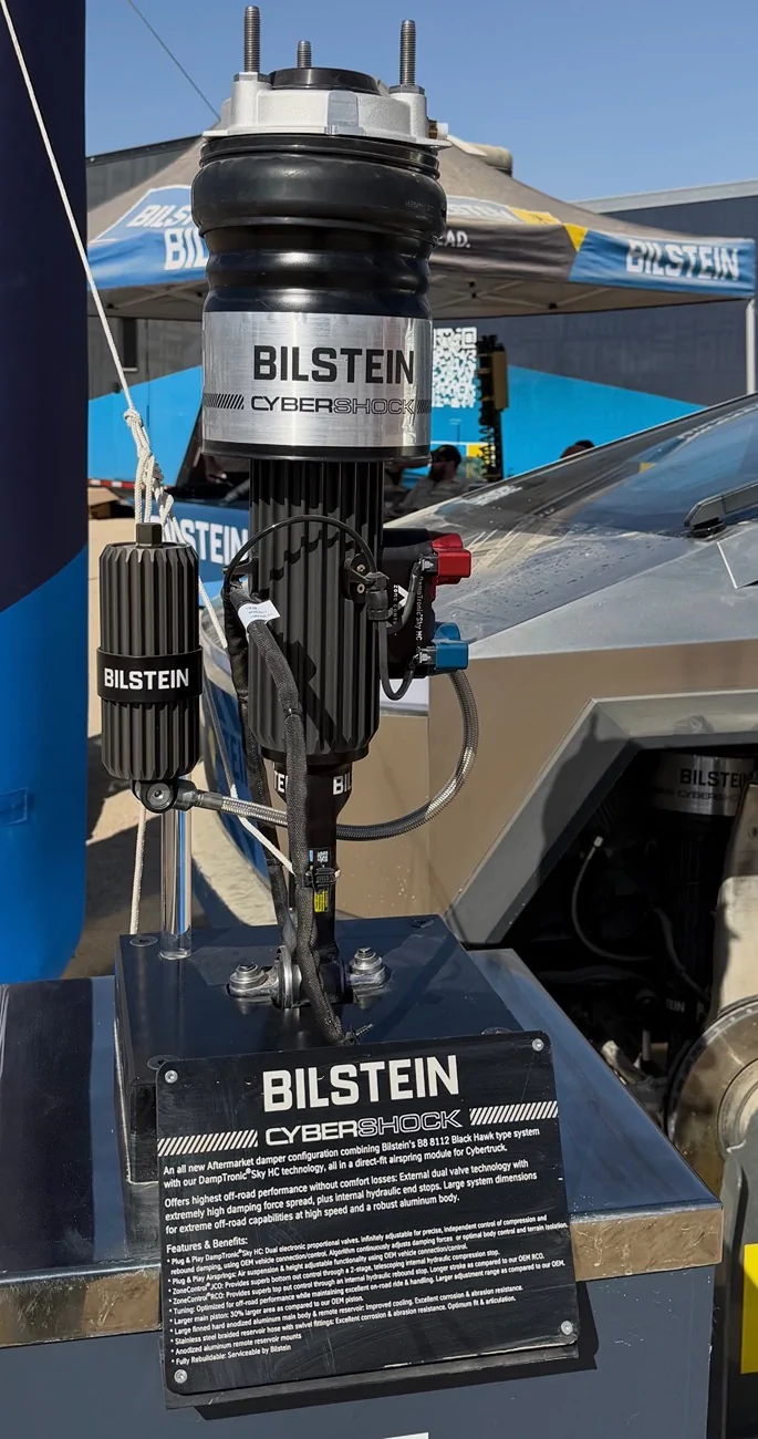

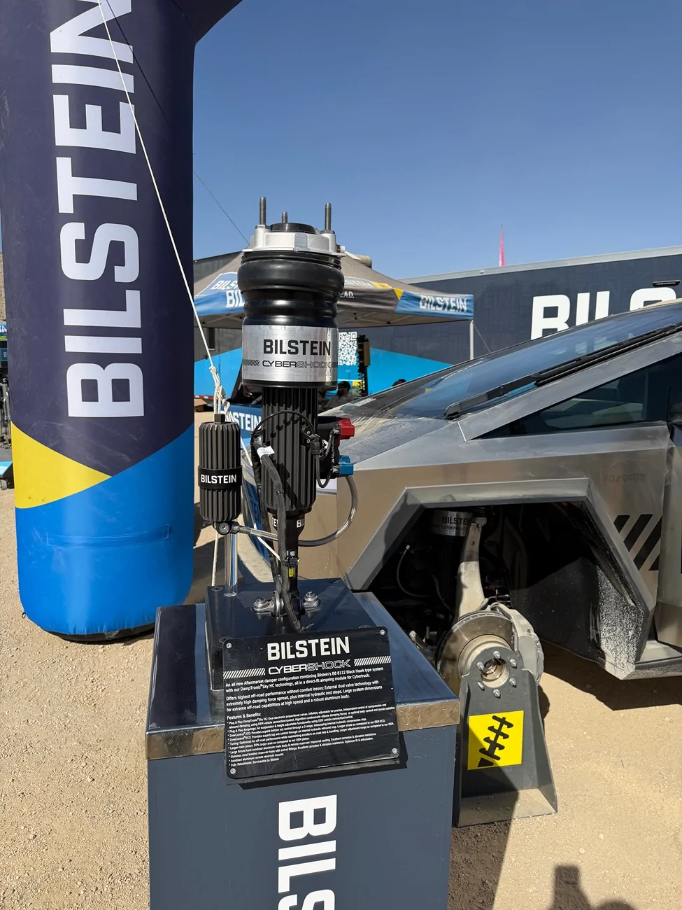

Bilstein Cybershock off-road upgrade for your Cybertruck - still fully height adjustable suspension.
Check it out at the Bilstein booth at KOH through 2/7!
10,426
20,956
In what way is this an upgrade from the OEM part?
It's probably not an upgrade at all.
Both versions of the Cybertruck already come equipped with Bilstein semi-active dampers as standard, which provide variable on-the-fly damping through electronic control via solenoid valves that adjust compression and rebound valving in real time based on driving conditions.
This is one more reason of many that the $79,990 AWD price is already a screaming deal.
10,426
20,956
The cybershock is already on offer to order from Unplugged. It’s a supplementary high speed damper.
