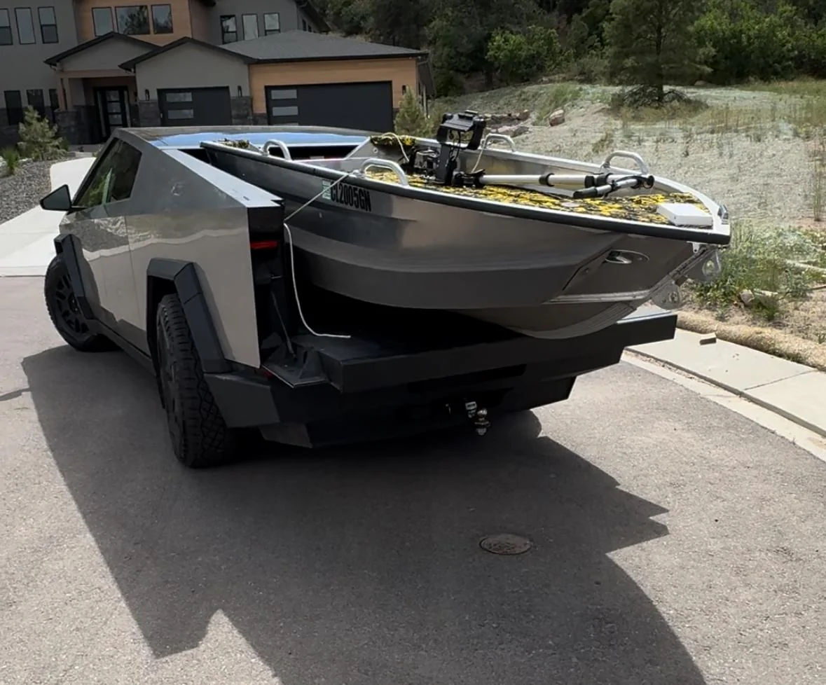

Here's how to squat your Cybertruck using Deflate suspension mode:

It would be good if they created a shortcut for loading (for me its a golf cart) in the bed...
I got mine stuck in squat after exiting service. Tried driving a short distance, and a couple of soft resets, no joy. What fixed it was going back to service mode, then deflating the fronts so it was level, then in service mode switching to "Normal UI, Leveling Available". Then it inflated everything back up to high. Then I exited service mode and was able to set ride height back to Entry. I don't know if every step in that sequence is needed, but that resolved it for me.
