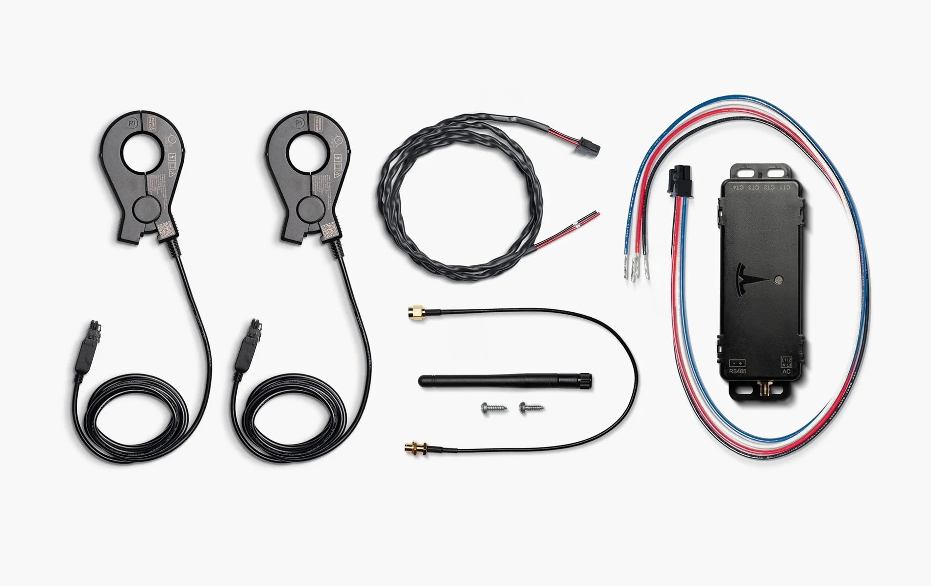

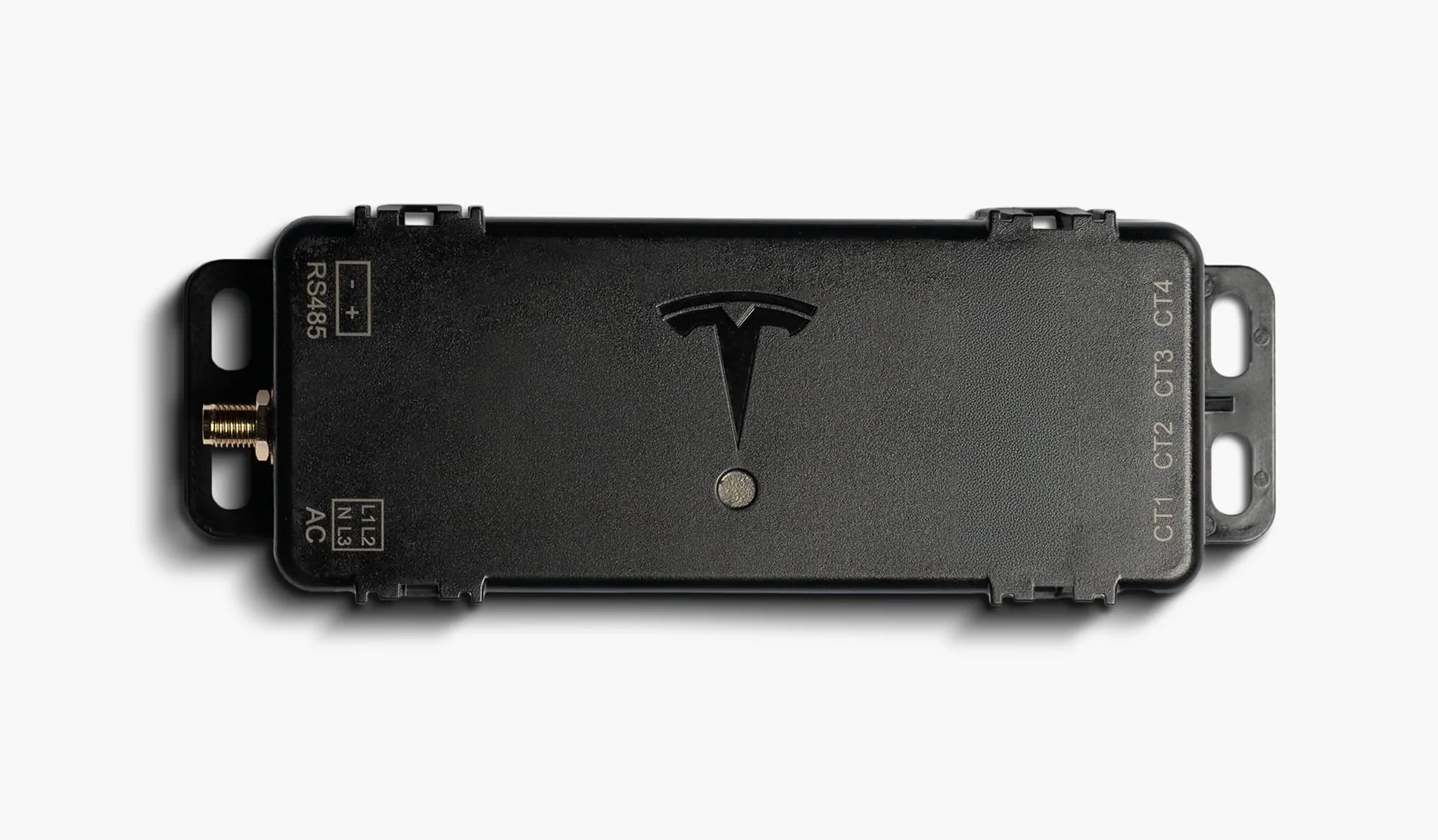

Tesla Remote Meter allows you to safely charge your Tesla at the fastest rate possible with Wall Connector—no electrical service upgrades required. This meter enables the Dynamic Power Management feature in your Wall Connector, which adjusts your charge rate in real time based on the available power in your electrical panel. Tesla Remote Meter is compatible with Wall Connector and Universal Wall Connector.

Group splits X amps across all your wall connectors
Dynamic keeps a single wall connector from overloading the service/ panel.
Air Conditioning turns on? Automatically lowers charge current.

There are plenty of houses that can’t run the full 48amps. I was at a family members house and used a 120v plug to charge, painfully slow. So I was looking at the panel thinking I could install a bigger plug there but they have all electric appliances, dryer, stove, AC, and 2 heater. The panel is 150amps, which doesn’t leave enough for a full 48amp charger. This new meter would work great in their situation. It would turn up the charging amps while appliances are off and turn down while appliances are on automatically. Or they could pay thousands to get the panel upgraded. The new device would save a lot of money.
