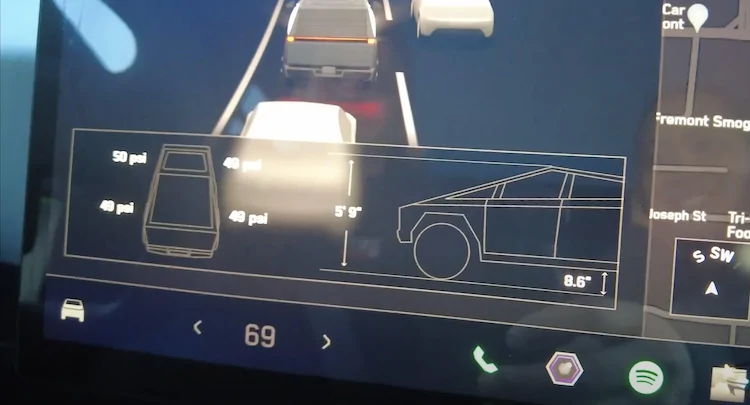

If you swipe-left on the media controls to view the tire pressures, it should display your current height:

Also, keep in mind that the height is based on a level surface; when you're transitioning onto a ramp, it will reduce the clearance.
I have a parking garage at work, and my first trip into the garage had me stopping at low-clearance spots to get out and check, hahahaha
