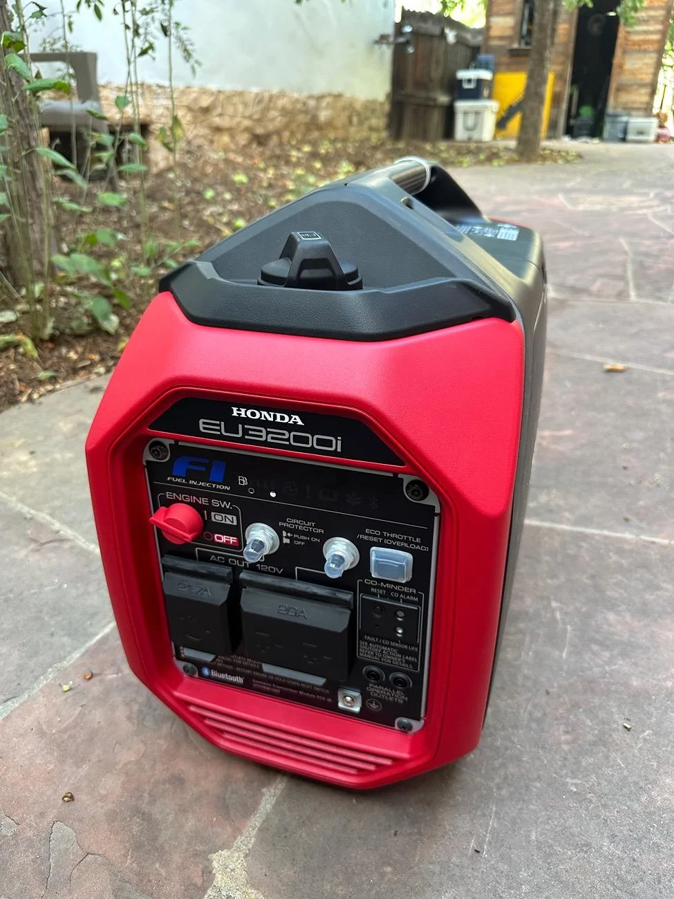

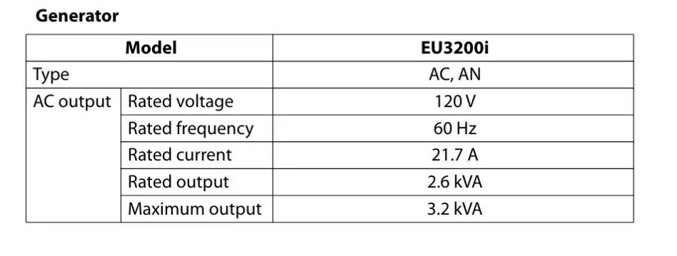

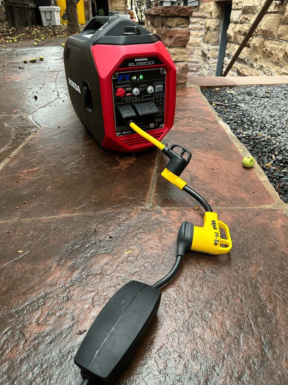

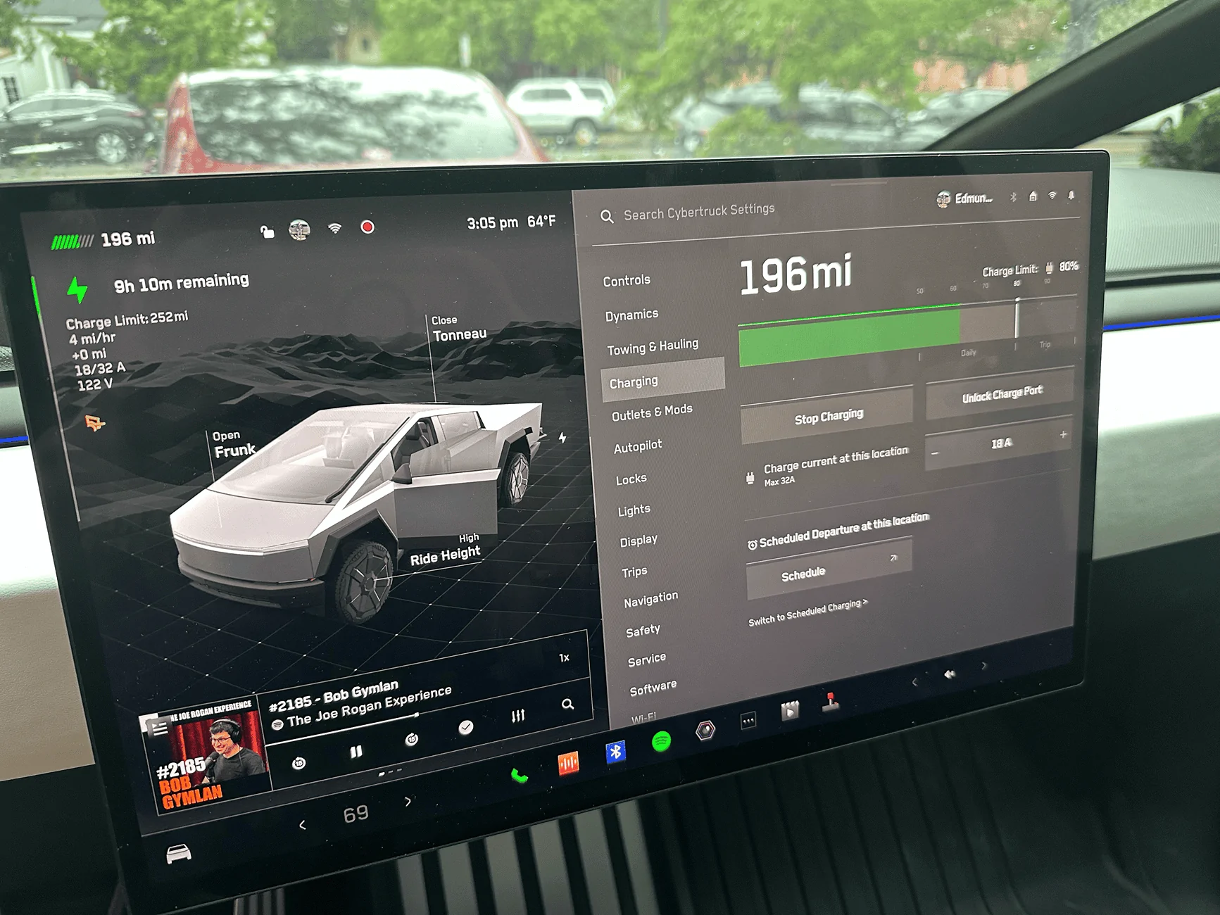

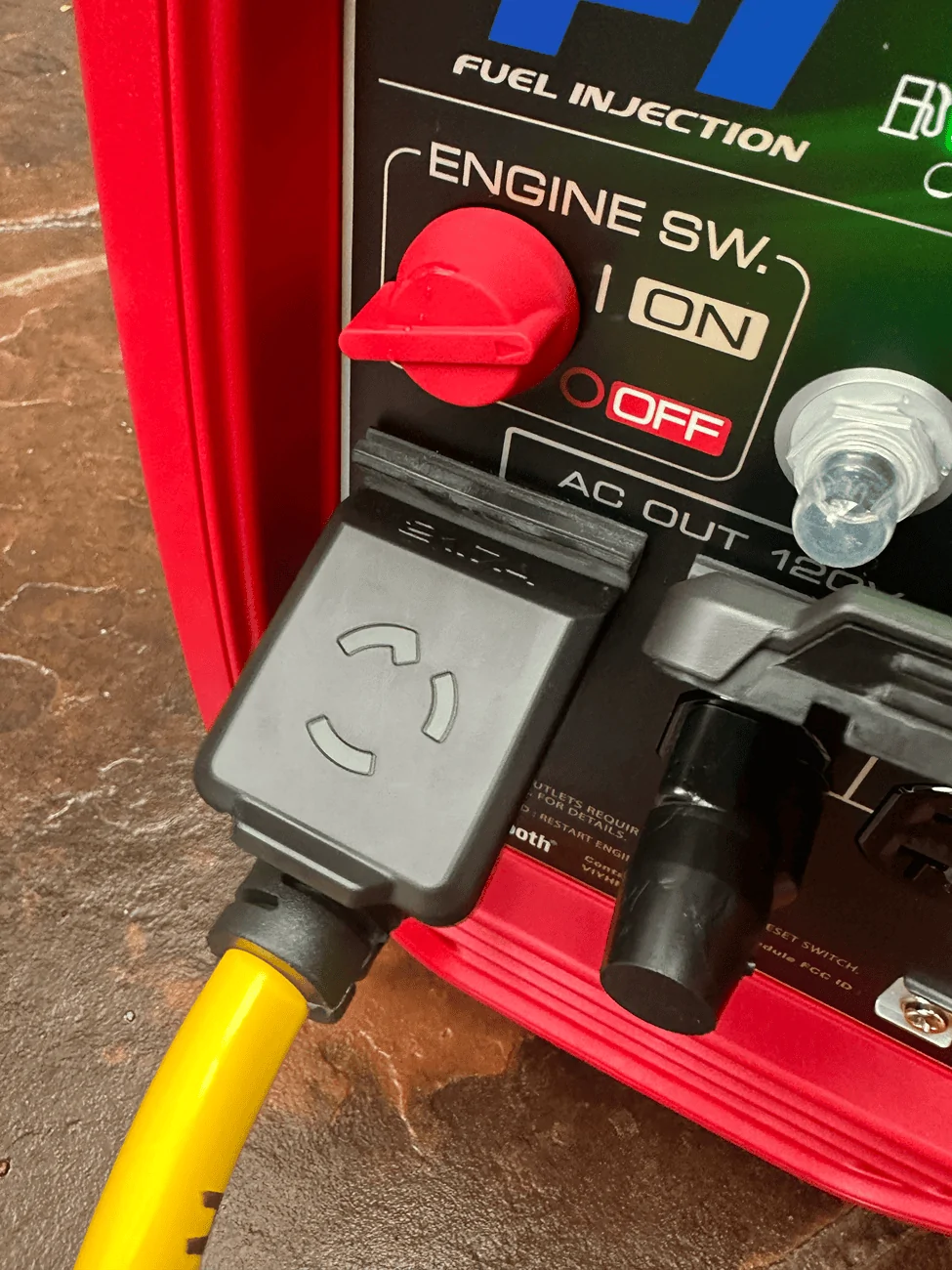

Ok.. making progress. I have my 30 TT twist connected to my Version 2 mobile connector. The EU3300I says its 21.7 amps on the twist outlet. I was getting 4 miles / Hr at 18 Amps setting on my Cybertruck, thats at 122v. 122 x 18 = 2196 watts. Can I safely tweak this up any higher? The generator has max output of 2600 watts. Can I keep going up to 21 amps? That's 2562 watts @122v What say you????
Tesla Cybertruck ADVICE - on a generator charge tempImagewHYOVL
Tesla Cybertruck ADVICE - on a generator charge tempImageRZcohU
Tesla Cybertruck ADVICE - on a generator charge tempImagelEibOM
May 27, 2024
4,520
5,495

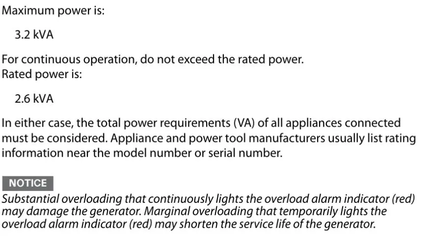

The manual for the EU3200i says it can do 2.6 kVA continuous and 3.2 kVA max. The 3000i gives a 30 minute time limit for max .
So 21A should be fine.
Go ahead, roll it up! What's the worst that it can? Burn out the generator and possible damage the truck?
I'll agree, damaging the truck is low probability, unless the generator burns up in a spectacular way.
I would highly suggest that you look a the recommendations for long term operations for the generator, they are seldom rated at 100% load for 8 hours.
As mentioned, this is only for very rare usage. The generator is mostly for regular use.
