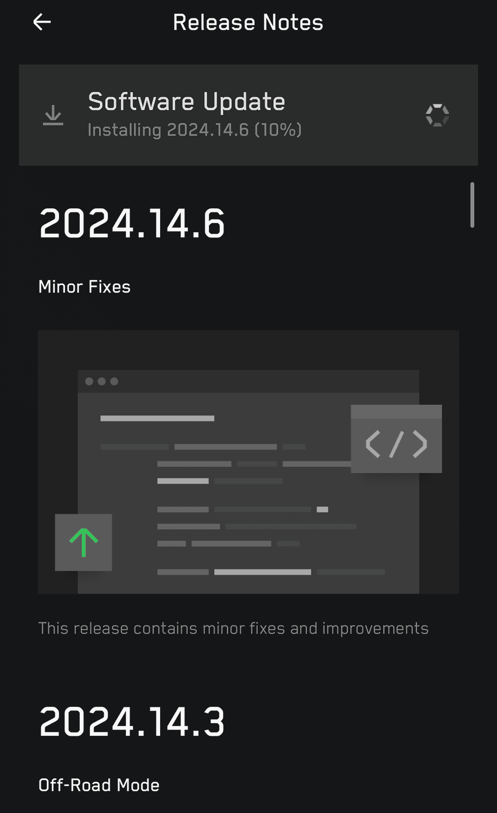

afraid to update! 2024.14.6

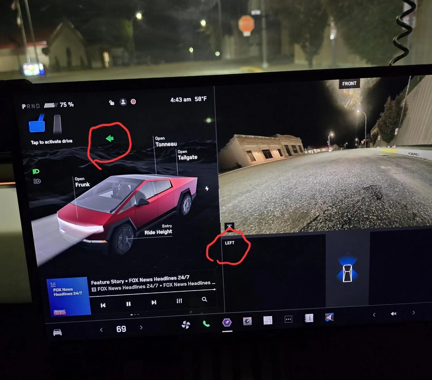

I updated last night. This morning I noticed the left and right camera's do not come on with the blinker. Just a black box with an x in the corner. I need to find a fix because I really rely on those side camera's. The camera's themselves work when looking in camera preview, just not when blinker activated.

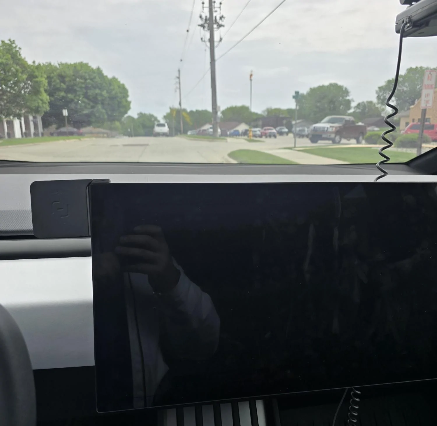

It's just getting worse. Now my entire screen has blacked out twice. Was driving blind. Came back on both times after about 10 minutes. Guess I better search for a way to reboot this thing since they can't get me in for service until June 10.
