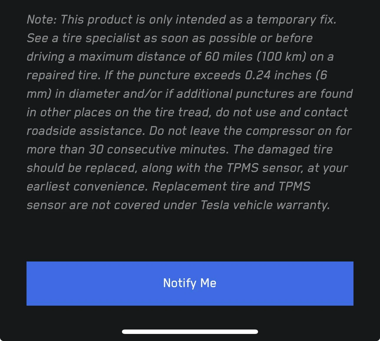

Just reading the Tesla spec, 30 mins will be close to doing the job on 4 tyres, but I am not interested if it takes say 8 minutes to inflate just one.
It has ' AUTOMATIC PRESSURE CHECKS ' the compressor needs to stop to get an exact reading,its done easily enough, but If the Tesla check is Automatic and if the pressure can be set from the start, all hands free, it is a bonus feature.
