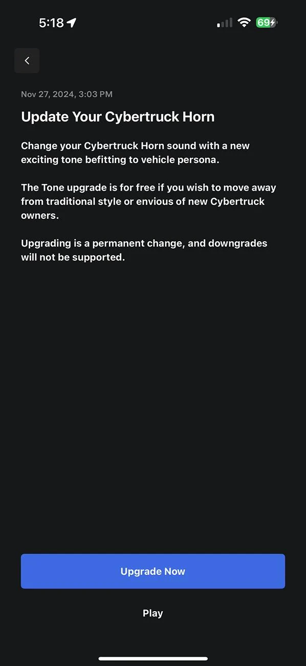

After updating to new horn sound I noticed that my custom downloaded Light Shows now are able to be picked in the list without having to reboot the screen. And stay there even after the CT goes to sleep. Not sure if this horn update fixed the Light Show issue or the last FW (2024.39.5) update.
Wait... what was the horn update? I wasn't aware it came, I was off the forum all day.
