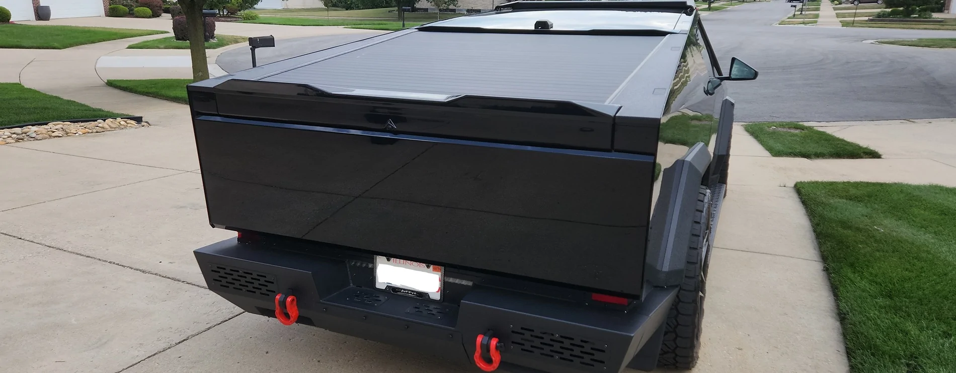

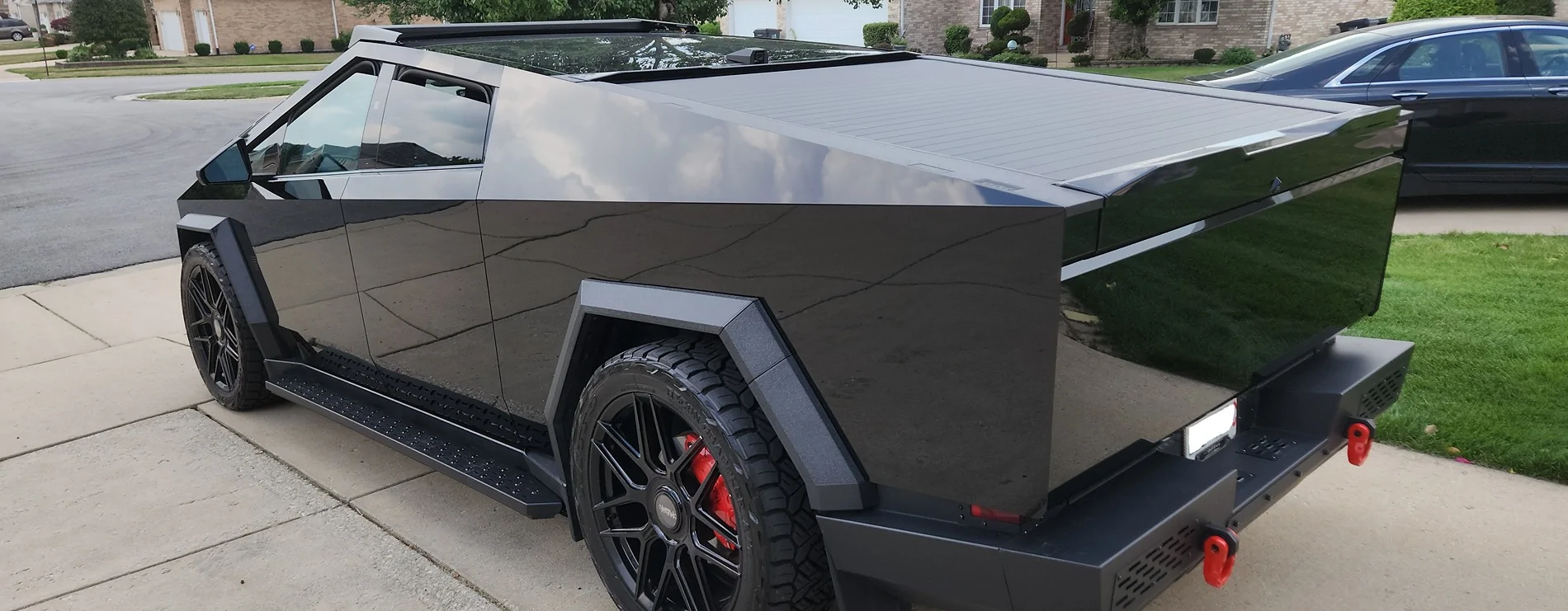

I replaced mine with a steel one.
Tesla Cybertruck Anyone replace their own rear bumper cover? How difficult? 20250723_153857
Tesla Cybertruck Anyone replace their own rear bumper cover? How difficult? 20250723_153822
