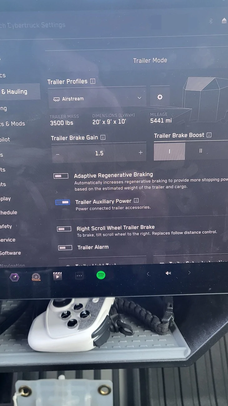

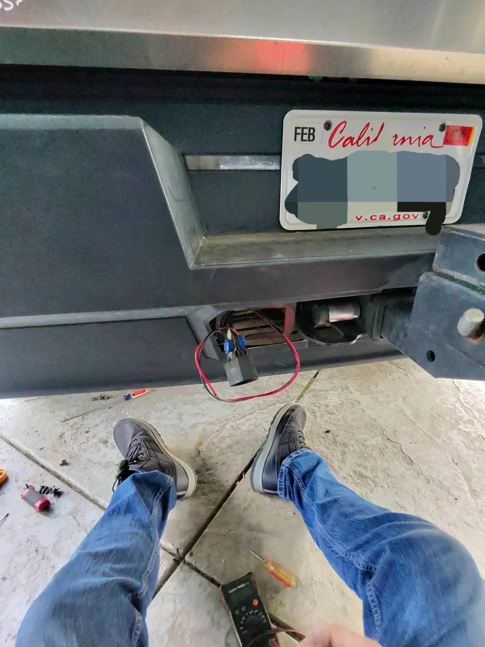

I found the drawing wrong. Wire colors are not what Tesla provided in manual. My trailer auxiliary power wire was black and the ground white. Also, you don't need to us trailer mode on, just need to select auxiliary power in trailer menu but you also need to select "keep power on" in Putlets and Mods. Or power will turn off in 2 minutes.

Those are not Tesla colors, they are trailer colors. And they are not universal. they vary from manufacturer to manufacturer. They are just the most often colors. The pins are the same always.
Right. Pins are same. Colors on truck are not what Tesla states on manual still. Just wanted to put it out there.

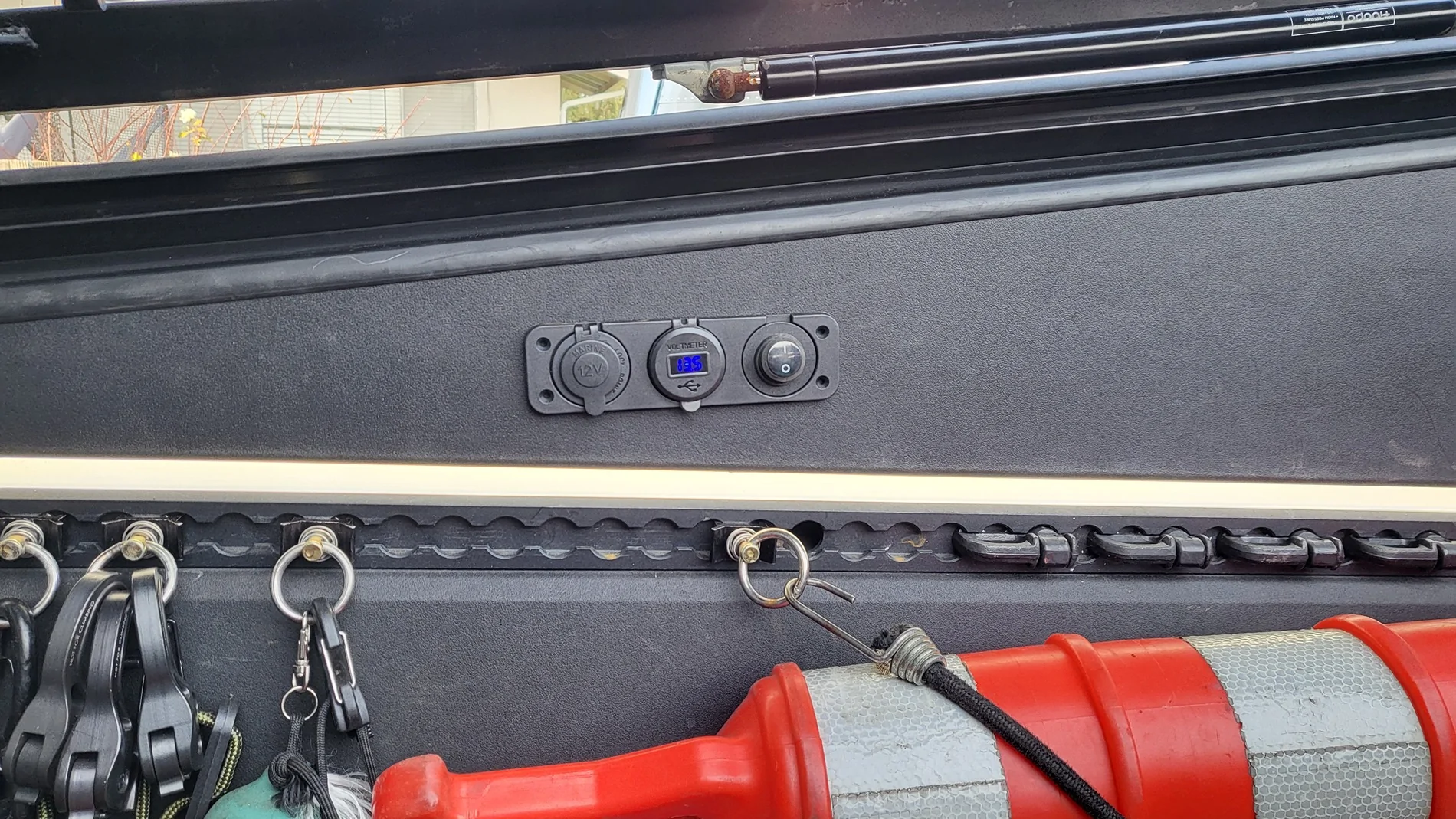

Yes I did. It’s an extremely cool project. It’s just a little more wiring and modifiying than I want to do so I was thinking about powering my 12v stuff off of a port adapter like the one I posted keeping a small power station alive or even just directly powering a 12v fridge.
