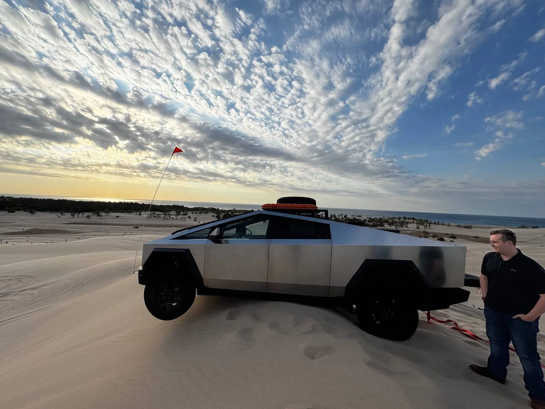

Over the weekend I shredded my Cybertruck out on the sand dunes. On one of my first runs, I shelved the truck on the top of a dune, with front driver's tire dangling in the air. I quick tug from a nearby Bronco got me out, no problem. Normal day on the dunes!

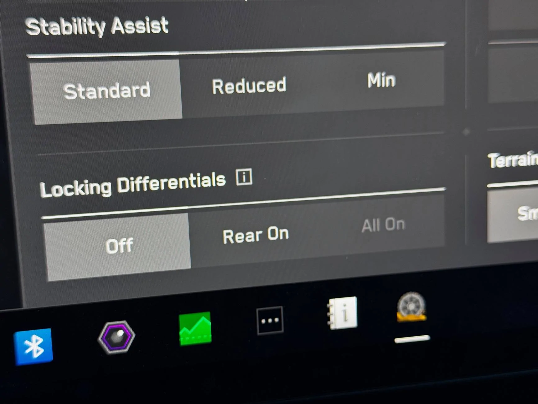

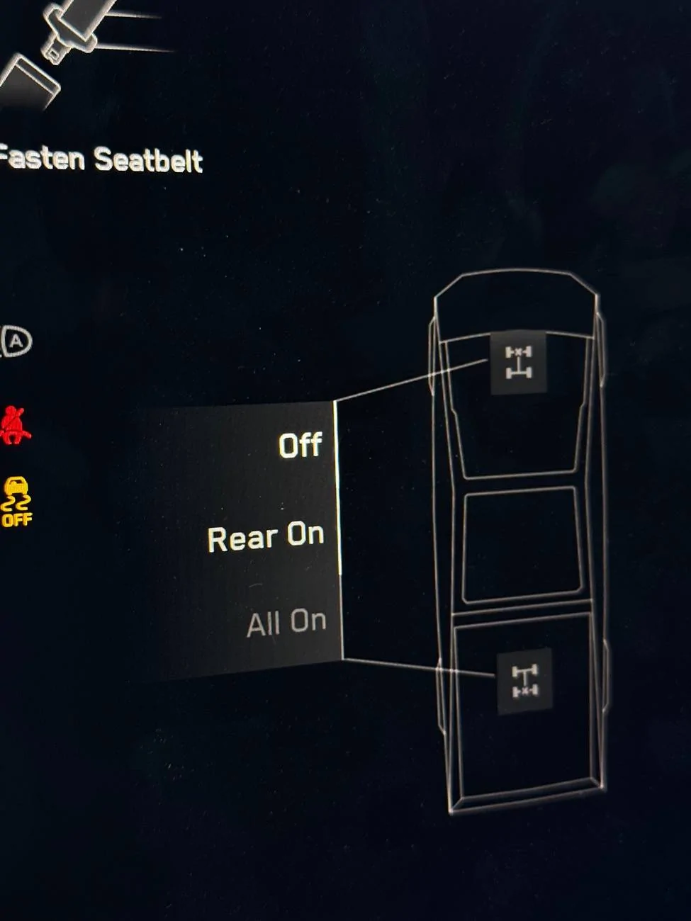

Immediately afterwards, my front differential wouldn't lock, and it remained unusable for quite some time. It was completely greyed out on my display, even after 100+ miles of additional driving (on road).
There were are no errors in service mode. The truck did NOT report an unknown differential position. There was no differential error in off-road mode.

Some photos of my parking job:
Tesla Cybertruck AWD Front Differential Menu Button Greyed Out -- My Solution GZKNXMUXQAAhaYW
Here's the greyed out buttons:
Tesla Cybertruck AWD Front Differential Menu Button Greyed Out -- My Solution IMG_5971
Tesla Cybertruck AWD Front Differential Menu Button Greyed Out -- My Solution IMG_5970

The rear locker is available on-road next to the traction control settings, and both the front and back are available with off-road mode.
And yes I went back to on-road mode after getting off the dunes for the day— the truck didn't squeal the tires when I turned so I assumed it was disengaged when the option was greyed out. Hope that helps haha
