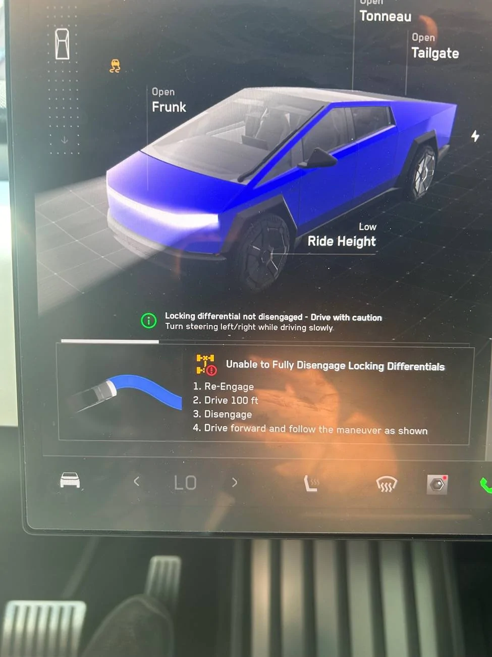

I have never used the slippery surface / locking differentials. Today when I got in my CT I had the error in the picture. I followed the directions to disengage and it thankfully worked. Has anyone else experienced this issue?
