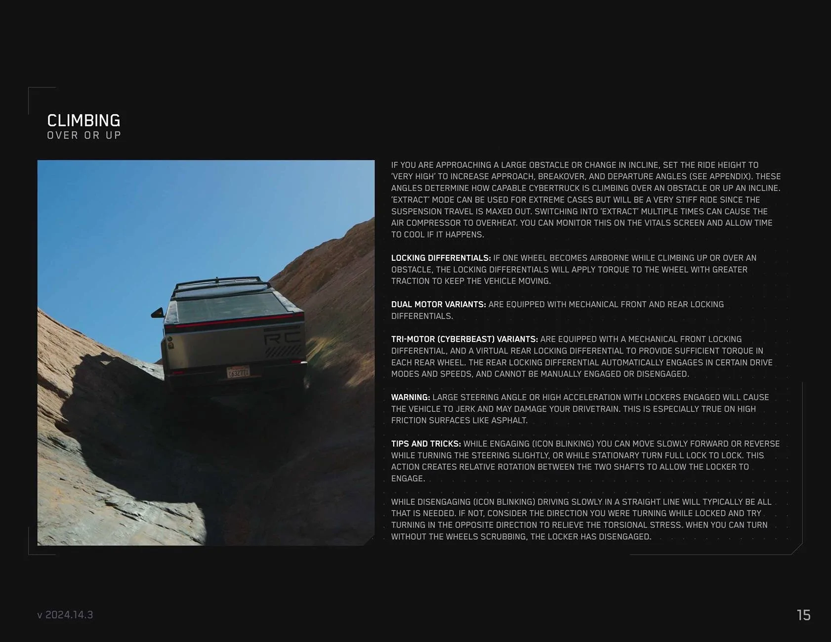

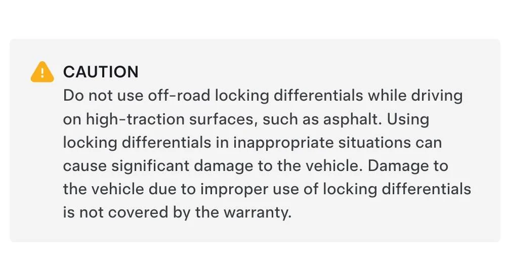

Only engage those for specific obstacles or climbs when off-roading.
