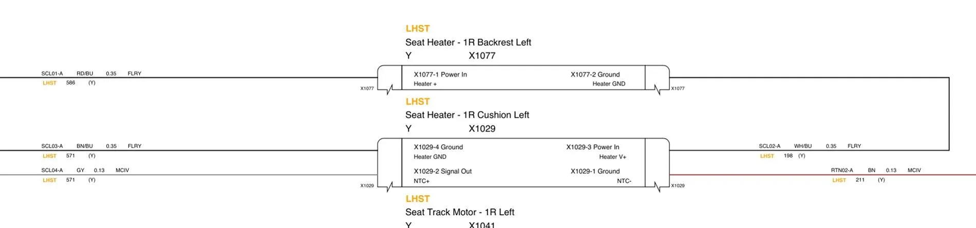

Unfortunately, not easily. The two heater sections are wired in series so it would require bypassing the seat element with a similar resistance of sufficient power handling capacity.
Even then, the temperature control is based on the seat temperature, so the NTC would need relocated also.
One *could* cross wire the left and right seat cushions such that driver's back is linked to passenger's bottom...

Because putting them in series reduces wiring and controllers by alot. Tho it raises failure conditions.
But throwing a resistor in if there's a connector at each end wouldn't be impossible.

That works if you want to bypass back heating. The seat is where the temperature sensor is. Bypassing that would likely cause an overheat event and/or module fault due to lack of sensor value change.
31,475
Ahh, you'd have to move or bypass the sensor as well. Hmm. Not impossible, but an additional thing to think about.
