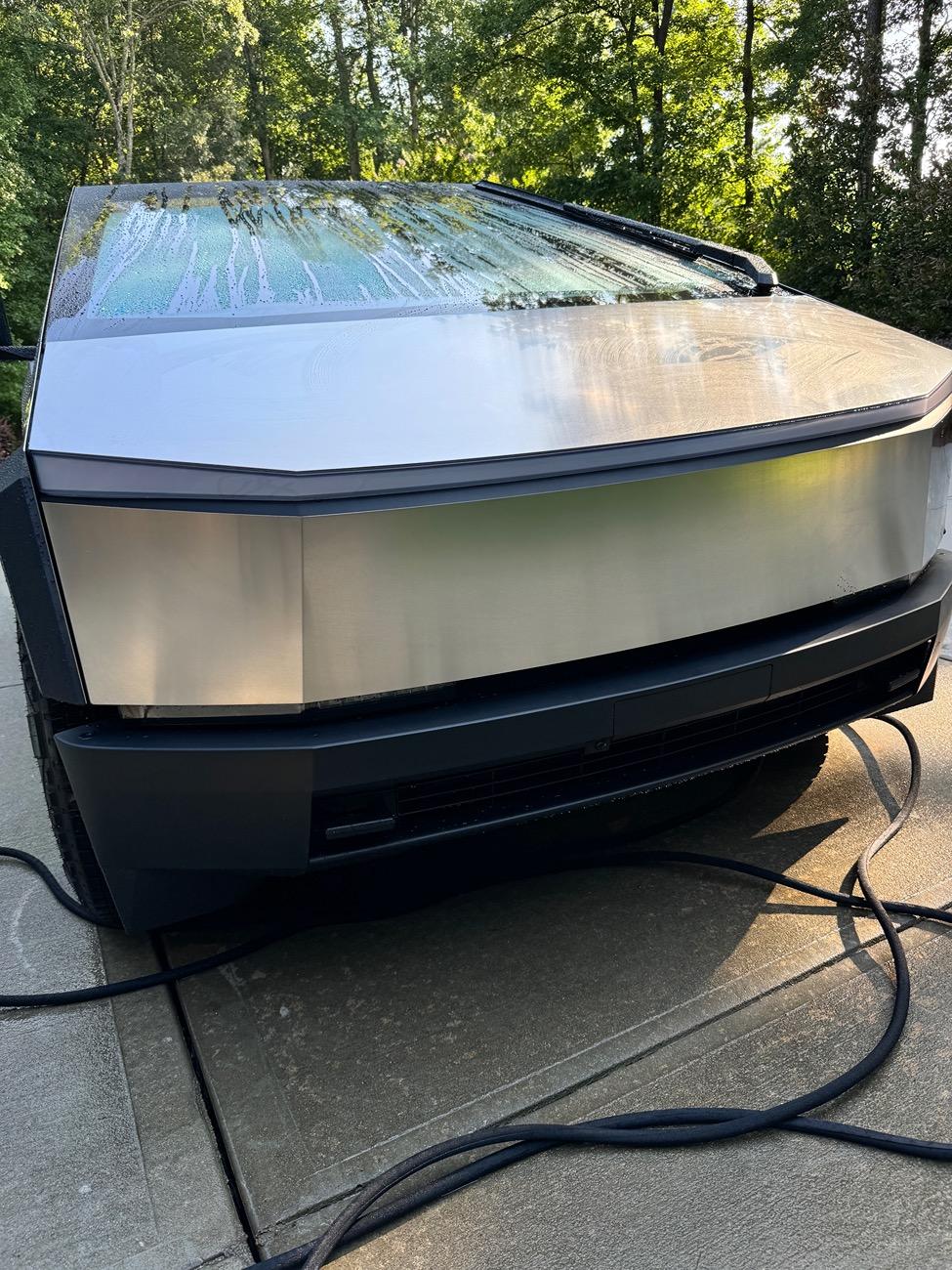

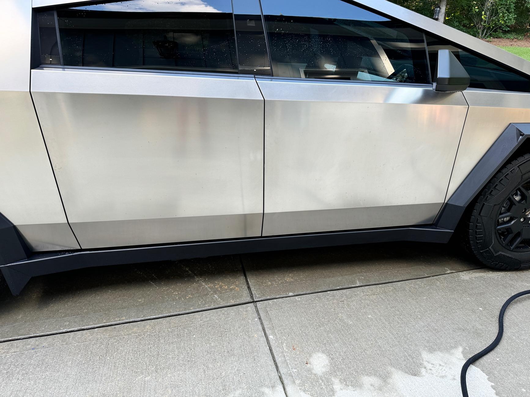

Decided to see if the recommended cleaning product for the cybertruck was any good.
1) used chemical guys soap to wash and then towel dry
2) spray and left on citrisurf77 for 10 minutes. I sprayed and wiped it around with a microfiber cloth
overall, it did really balance out the stainless finish. Some persisting stains from some blemishes and other products are somewhat visible, but really take off anything to was sitting on the metal.
what did you all think? And better process to using that citric acid based cleaner?
