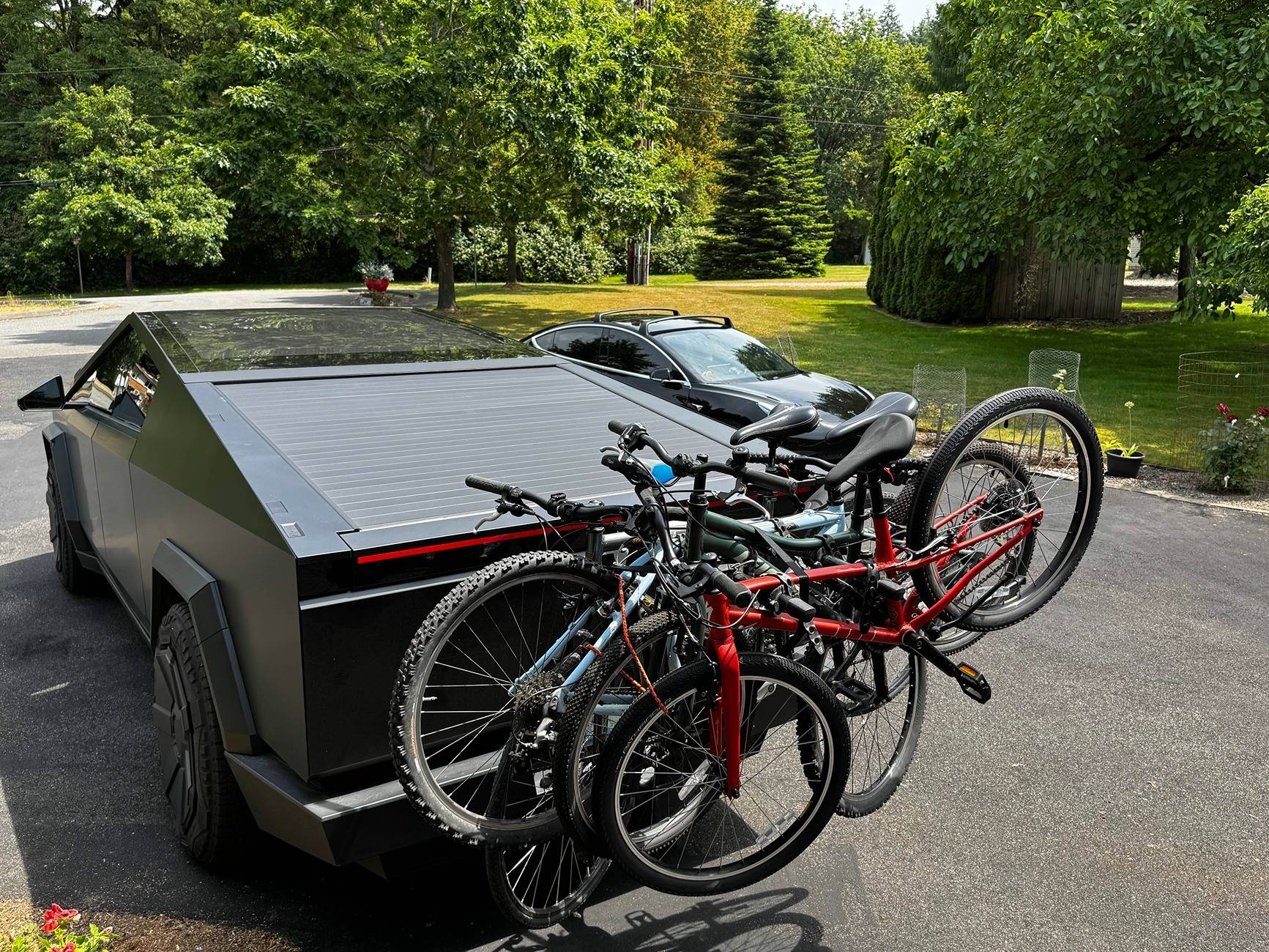

Hello!
I am looking for a 5 bike hitch rack for my Cybertruck. We currently have a Thule and only fits 4.... See photo.... Any thoughts on vertical racks? Will it be way too high in comparison to the sloped back? Thinking this... VelociRAX 5 MAX Thanks for any input... I can't seem to find a photo with one!

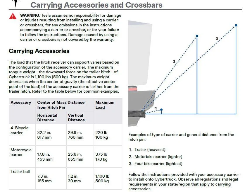

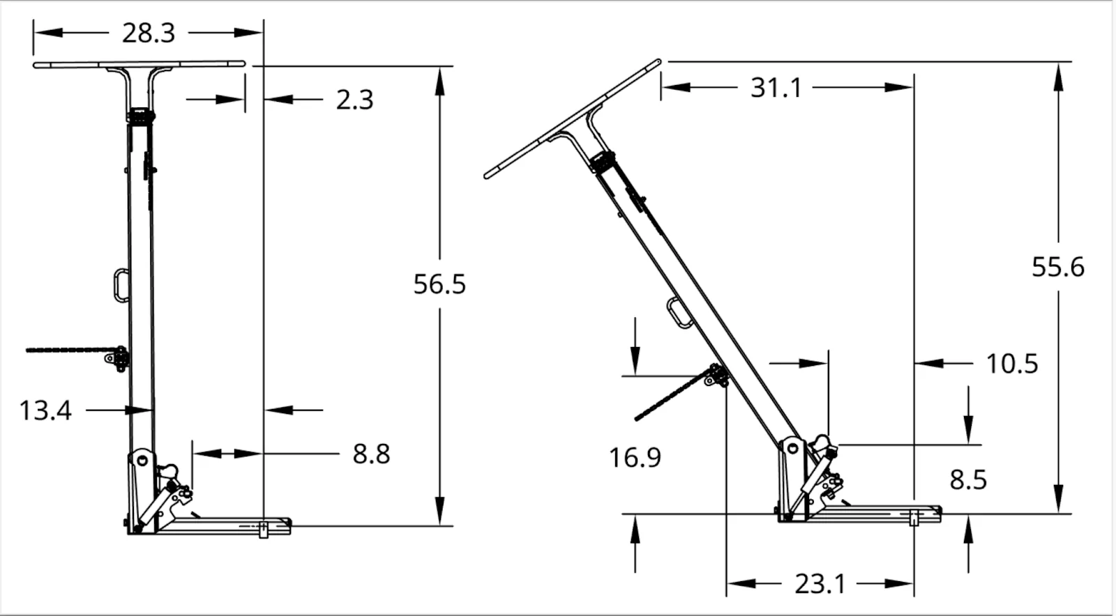

Has anyone tried to break down the impact of vertical vs horizontal distance from hitch pin to center of gravity of the payload? I ask because Velocirax specs show the vertical beam of the velocirax is horizontally only 13.4 inches from the hitch pin.
The vertical beam is indeed 50+ inches high, but it’s horizontally closer to the hitch pin than the motorcycle and 4-bike rack example on the Tesla website, I wonder what the max load is for a vertical rack like velocirax is.
