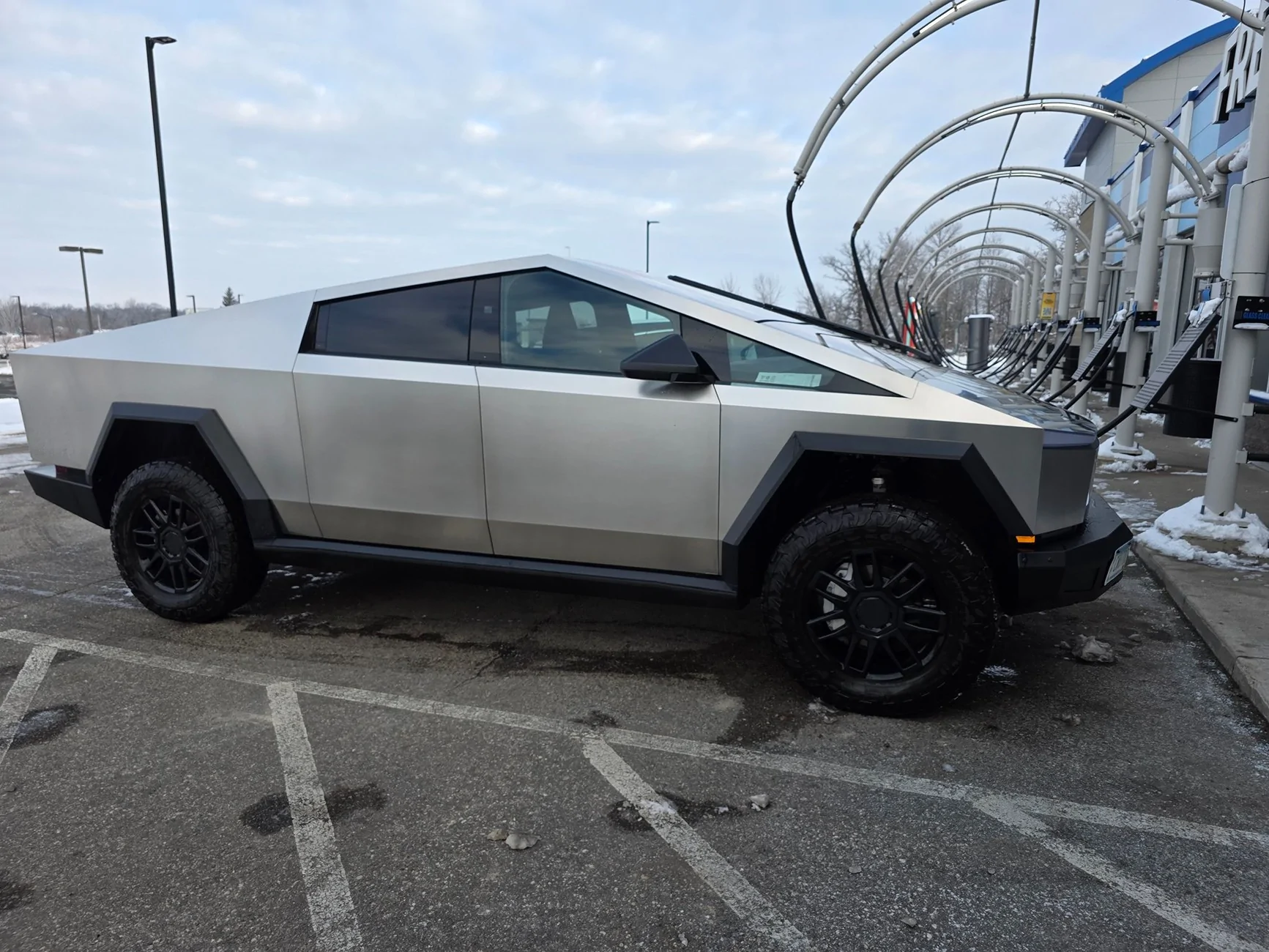

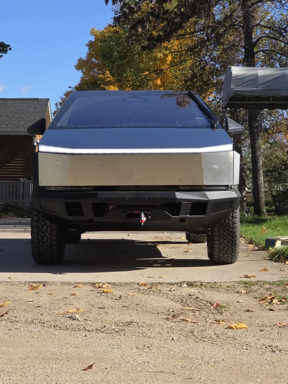

I will have that much snow here soon. It melted off once and now we are getting our last winter blast.
The AT EV version closest size is 1" taller, same width. Front flaps removed works.
Quiet and no noticiable range hit.
Only thing better on ice is real snow tires you can only run in the winter.

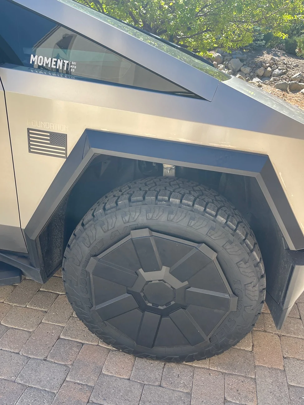

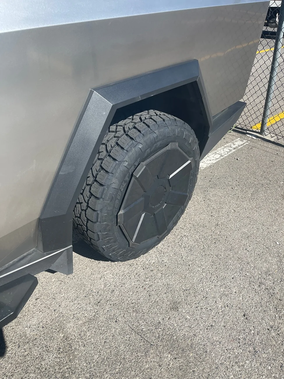

We run the AT III’s on our Sequoia and have for years so I decided to give them a try on our CT and they’ve been outstanding. Had those 2 major storms during the holidays here in Reno/Tahoe where we got 8+ feet and they were everything we expected. Had to go with the non EV version in order to get the 65’s. We put them through their paces in several days of snow/blizzard driving and I’ll be replacing them with the same ones when the time comes. Can’t speak for any others as only have experience with these and the stock AT’s.
TOYO TIRE
OPEN COUNTRY A/T 3
LT285 /65 R20 127S E1 BSW​

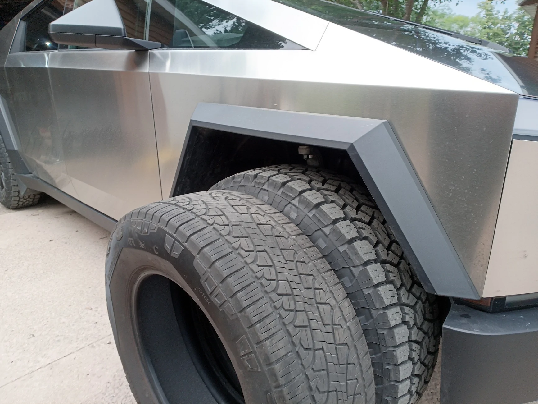

Yes 1" taller.
Before I got the winch bumper I had to remove the front flaps to run them.

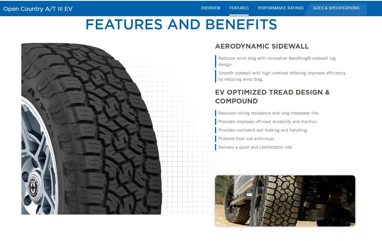

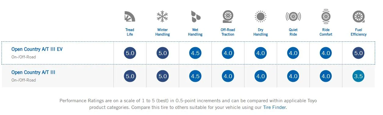

Those are the standard AT3 non EV. version. https://www.toyotires.com/product/open-country-at3/
Rivian owners on forums who have ran both I why I went with the EV Version.
https://www.toyotires.com/product/open-country-at3-ev/

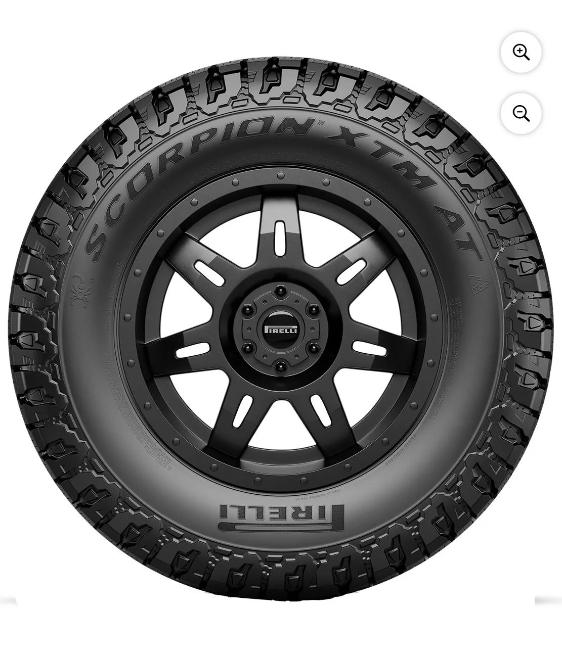

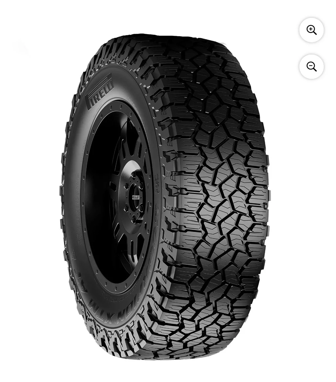

thanks but I’m still leaning towards the Perelli Scorpion XTM AT as it’s designed for an EV, comes in the exact OEM size AND has a higher speed rating, albeit slightly! (T vs S)
EV tires low rolling resistance is important.
