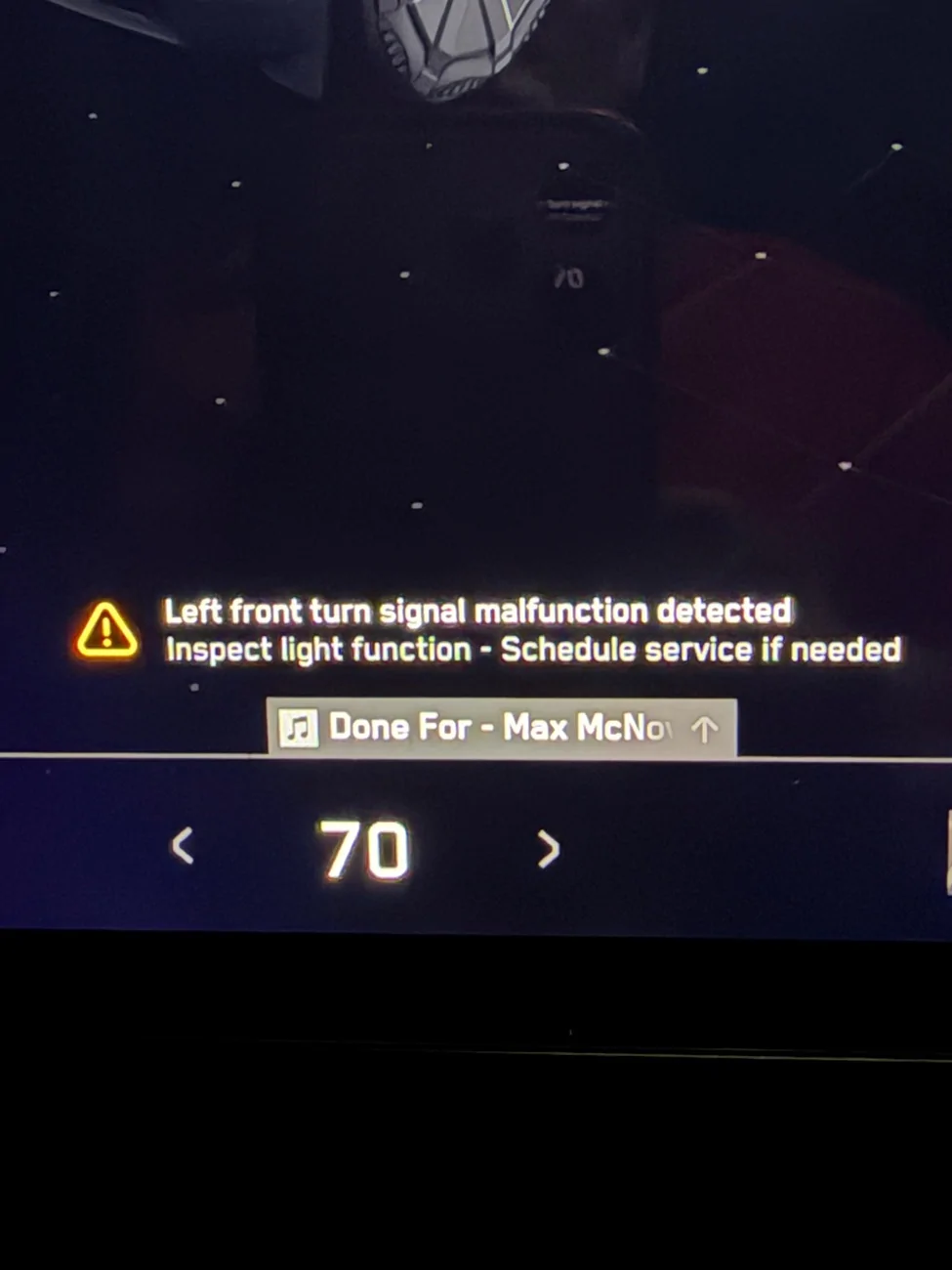

Just got that on the way home and yup no LF blinker.. Anyone have this happen? Im hoping they can fix it over the air.
The headlight unit only has LIN bus and power running to it. If any light in it is failed it's most likely an issue in the assembly.
Hardware failure is most likely, but it could also get software updates which temporarily messed things up. Could try doing a vehicle power off.
Service mode would also have more error information.
Yes it happened to me.
I replaced my headlight. I got one off eBay. Its been fine ever since.
