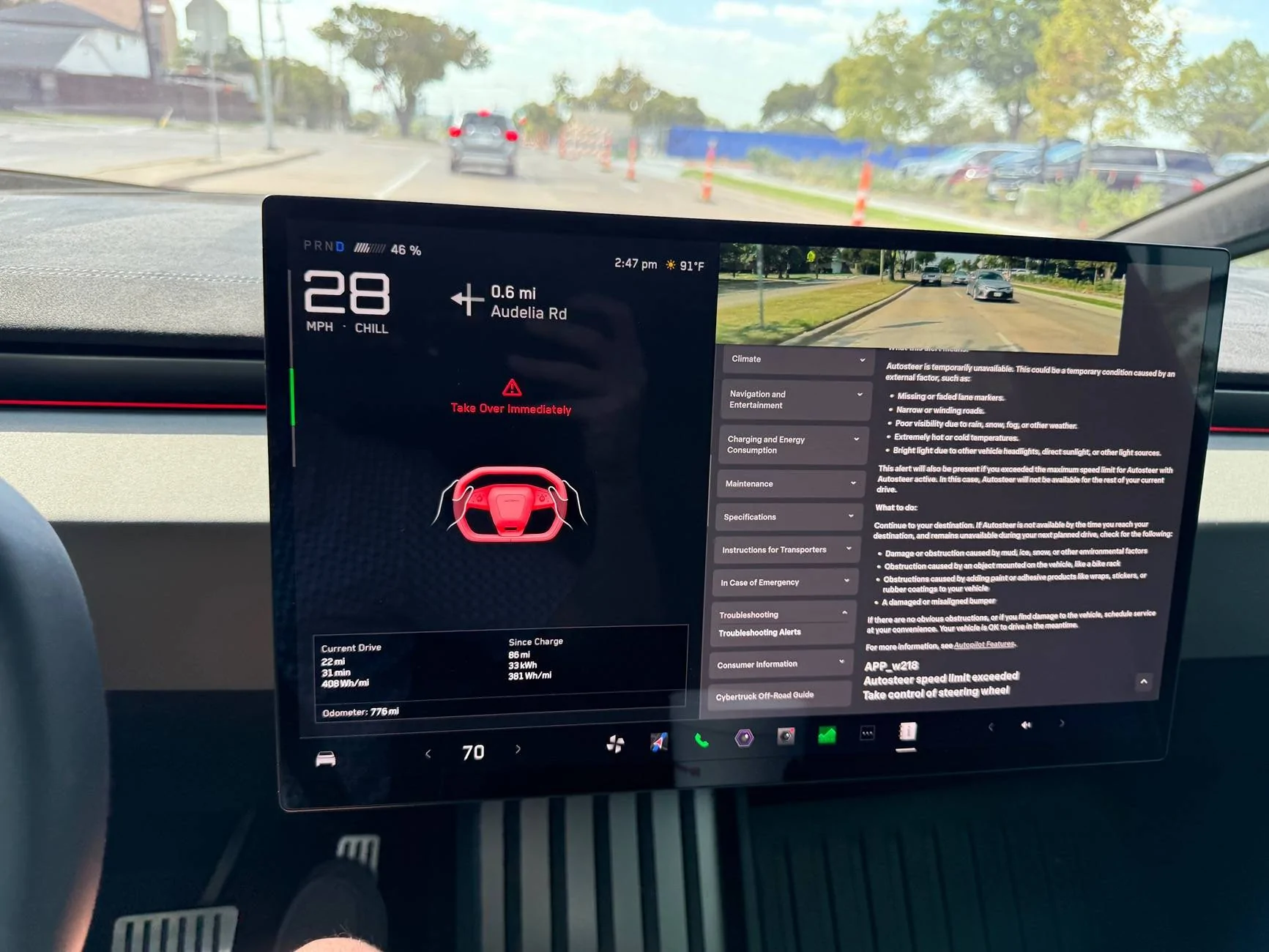

This isn't a strike. It's just a cry for help from the truck. I got it in sunlight too. It shouldn't stay though so it's probably a bug in the fsd cybertruck software.

Are you all saying the "take over immediately" RED steering wheel warning on screen will eventually go away? I tried soft and hard reboot and it is still there. I can still drive the vehicle.

Yes, eventually it will go away after driving for about 30 minutes. FSD still works while the warning sign still on. It happened to me the third time yesterday on highway.

Confirmed, it went away after a fee reboots, power down and 3 hours
All good for now

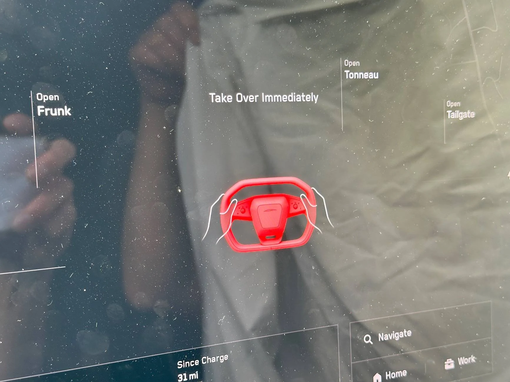

I had the same thing occur to me after about 4 days of driving on FSD. Mine occurred randomly as I was slowing down at a red light. Mine has been stuck in that screen for 24+ hours and I have driven the truck over an hour sense then. It have tried the reboots with the two wheel buttons as well as powering off via the safety menu and waiting 5+ minutes and I cannot make it go away. I have cleaned all my cameras so there is nothing obstructing a safety sensor. Video is too large to post but this has to be a bug because FSD still works even though that warning is up. If anyone has a way to make it go away please let me know. In Dallas the soonest service appt is Dec 4!

Update: I misspoke on 24 hours. Looking back at photo times the error message went away after 24 hours just now. It’s almost like it was a 24 hour lockout of FSD but I don’t believe I got a strikeout when that error came up.

Same exact thing happened to me today. Hoping for a bug fix update soon. If that’s what it is

Same thing just happened to me. It’s dark outside. I was coming down my street back to the house. Street lights & my headlights were the only illumination.
Alert came as I was approaching a car parked on the side of the street (same side of the street I was driving on).
I tapped the brakes and took over driving. The red steering wheel alert immediately stopped but I received the following error code:
DI_a124 “Cruise Control Disabled”
