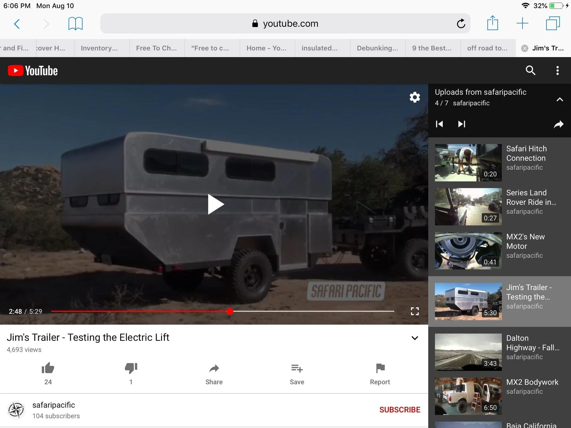

One way to make the trailer towable and as aerodynamic as possible is to make it similar to this design. The top lifts up when in use and lowers down while towing.

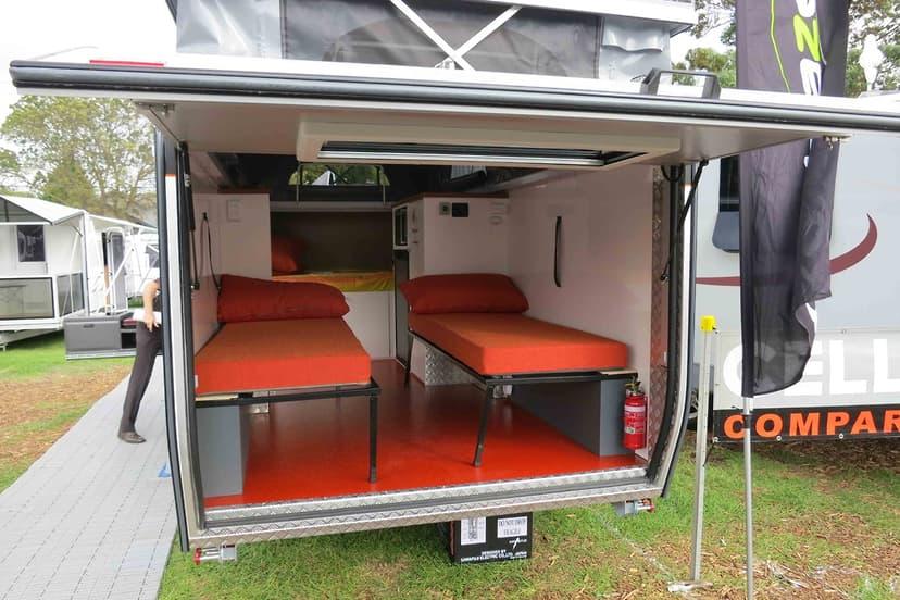

I like the functionality of an open back trailer. Lots of light and great versatility. The “cybertrailer” could be used as a sort of mini toy hauler for bikes etc. Very easy to load and decreasing the need for bikes, kayaks etc. to be hung off the trailer compromising the aerodynamics. This design also allows for the trailer to be used for more than just camping.
