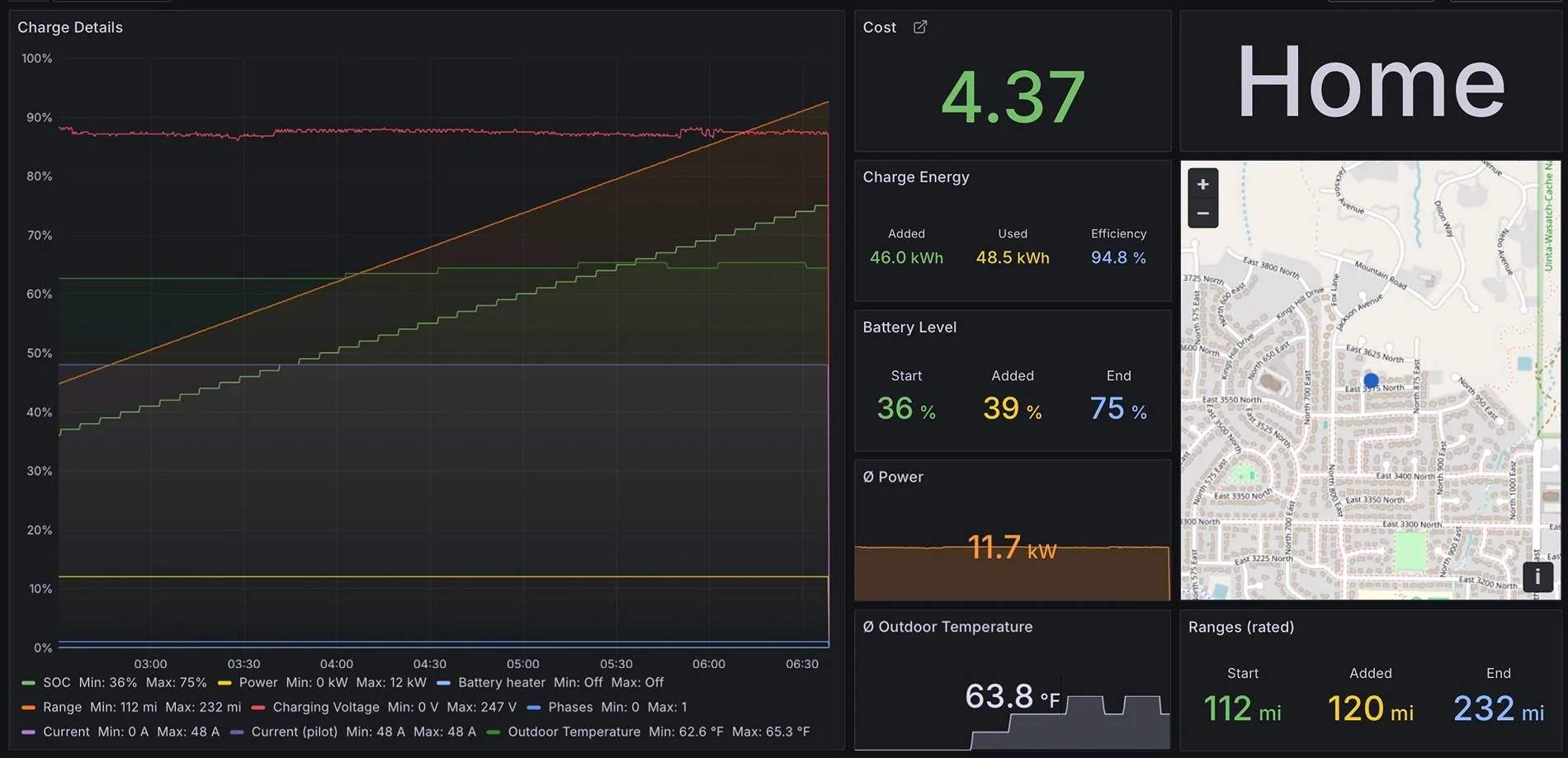

Nice, I have done that as well. Now I have a good idea of how long it takes to charge at full Wall Connector rate to get to a specific %. What I have seen is at 12 kW (really between 11.9 - 12 kW) from the Wall Connector it takes about 1 hour per 10% SoC. I schedule charging to start at a time that will have it finish no earlier than 15-20 minutes before I want to leave. The reason I started doing that is I noticed it helps warm the battery better (of course who cares in the summer) so I don’t have to preheat the ride as much. It also seems to warm the cabin up as well. This morning for example, had it start at 02:30 (36%) and it finished at 06:38 (75%) with us leaving around 07:00 (left later than we wanted) for our adventure. No blue snowflake and the cabin was 72°F while the garage was 62°F - 65°F without any preheating. I’m know this doesn’t help if you are in a shared garage but maybe if you paired lowering the amps and set a schedule you could have the ride be charged up by the time you need and gain a little heat :)
Oh, in short I wouldn’t worry about charging to 80% every day assuming you are using some of that juice every day. Even if you don’t, the difference between that and doing what my silly ass does and keep it low SoC unless I need the distance is likely not going to amount to a large difference over the ownership of the ride. Tesla has some amazing battery management software to help maintain battery health over time. What you will see though is at hight SoC, say 80%, it will drop % faster sitting “idle” than lower SoC. Just the nature of batteries.
Tesla Cybertruck Charging a little bit of a time every day? IMG_0231

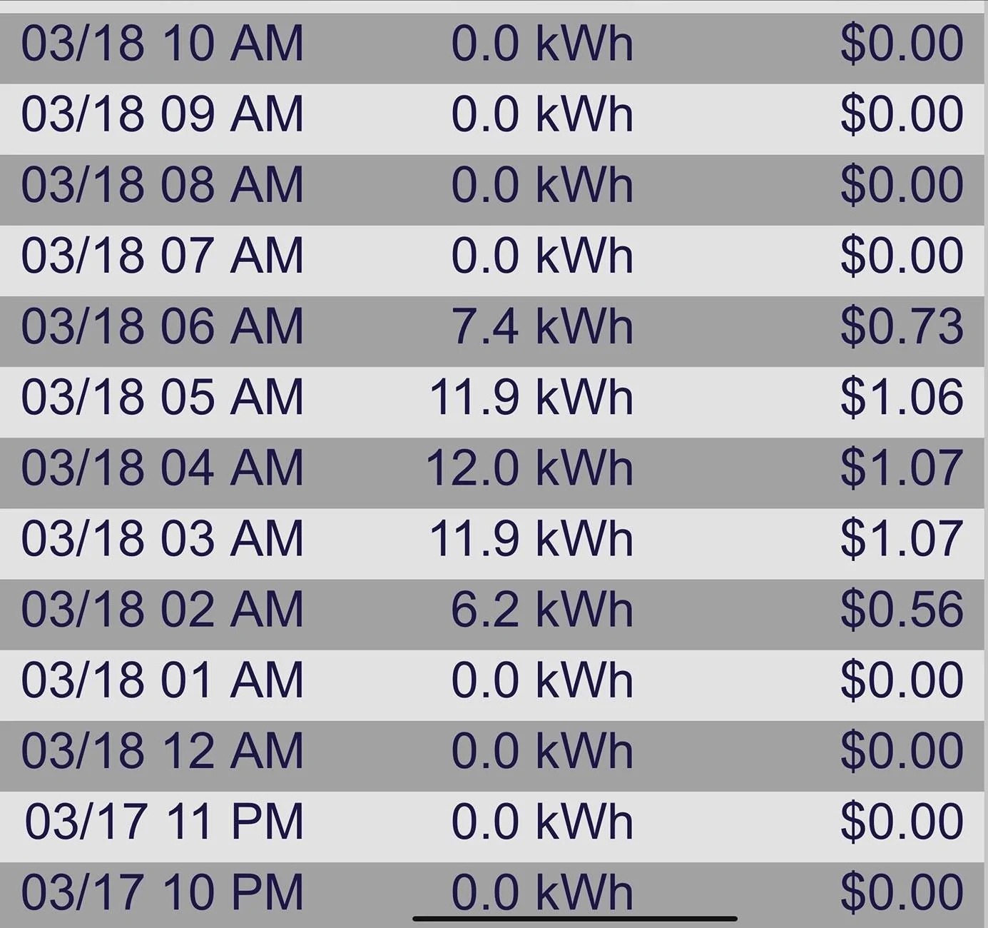

Stats on the Wall Connector usage.
Tesla Cybertruck Charging a little bit of a time every day? IMG_0230
