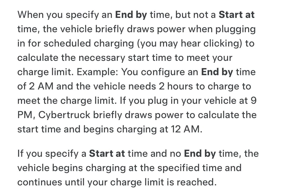

Have I been using this feature incorrectly for years?
Yes you have.
You can schedule your charge to finish right at a planned departure time to reduce energy costs, even in market regions where off-peak utility rates are not applicable. Example, if charging starts as soon as you plug in, charging may complete much sooner. This causes the Battery to cool down to ambient temperatures and requires energy to warm it back up by your departure time. Therefore, even if off-peak utility rates are not applicable to you, Tesla recommends that you charge until your planned departure time in order to reduce energy consumption by specifying your departure time as the scheduled End by time.
https://www.tesla.com/ownersmanual/cybertruck/en_us/GUID-76995CEC-6402-4BFF-99FA-CEFA36E64A19.html

awesome thanks
Tesla Cybertruck Set a charge time completion target? IMG_8540
