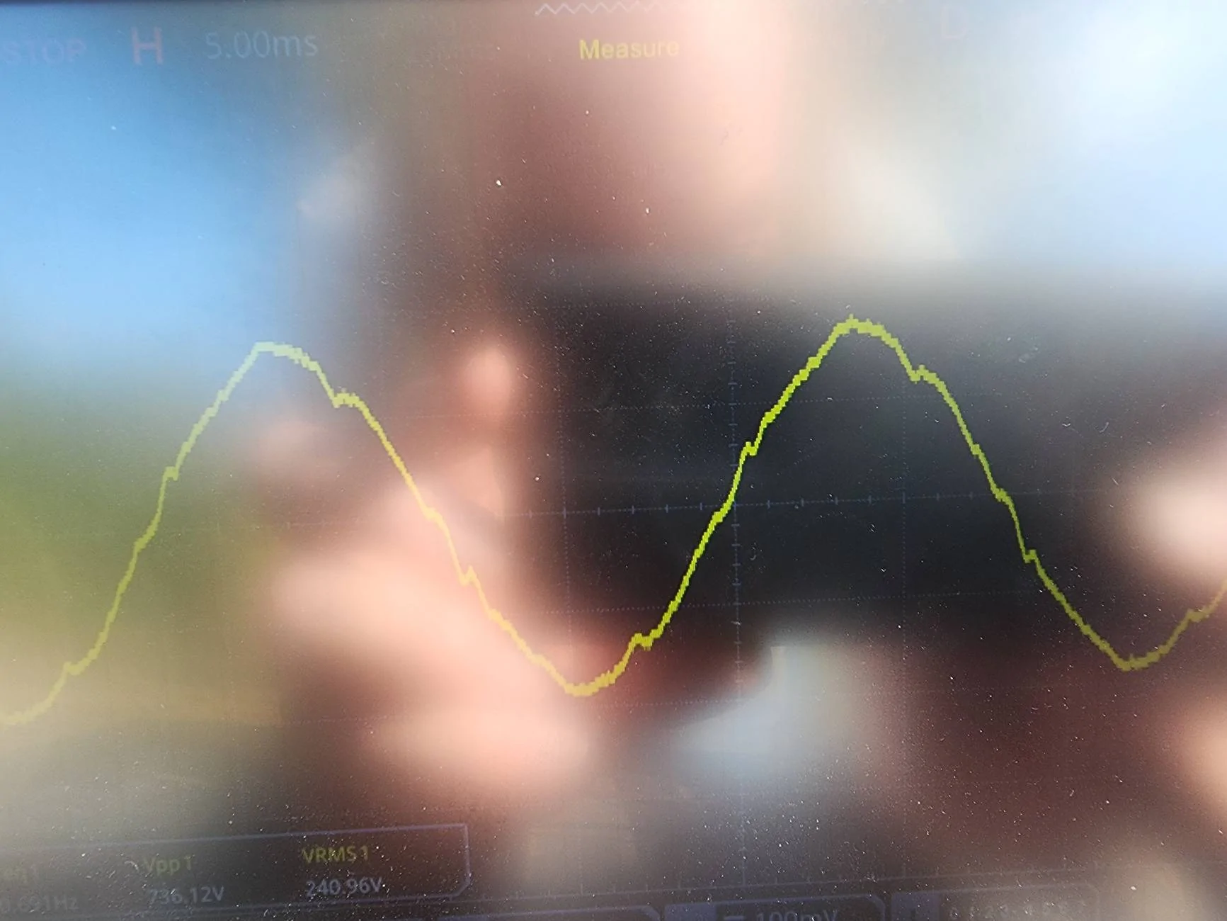

Anyone know if the cybertruck inverter is pure sine wave? The battery requires it and if the truck isn't, that might explain the strange behavior.
Seems fairly sinusoidal, which makes sense with Powershare functionality and charging PFC.
Ignore the voltage measurement, my scope was on the wrong attenuation.
