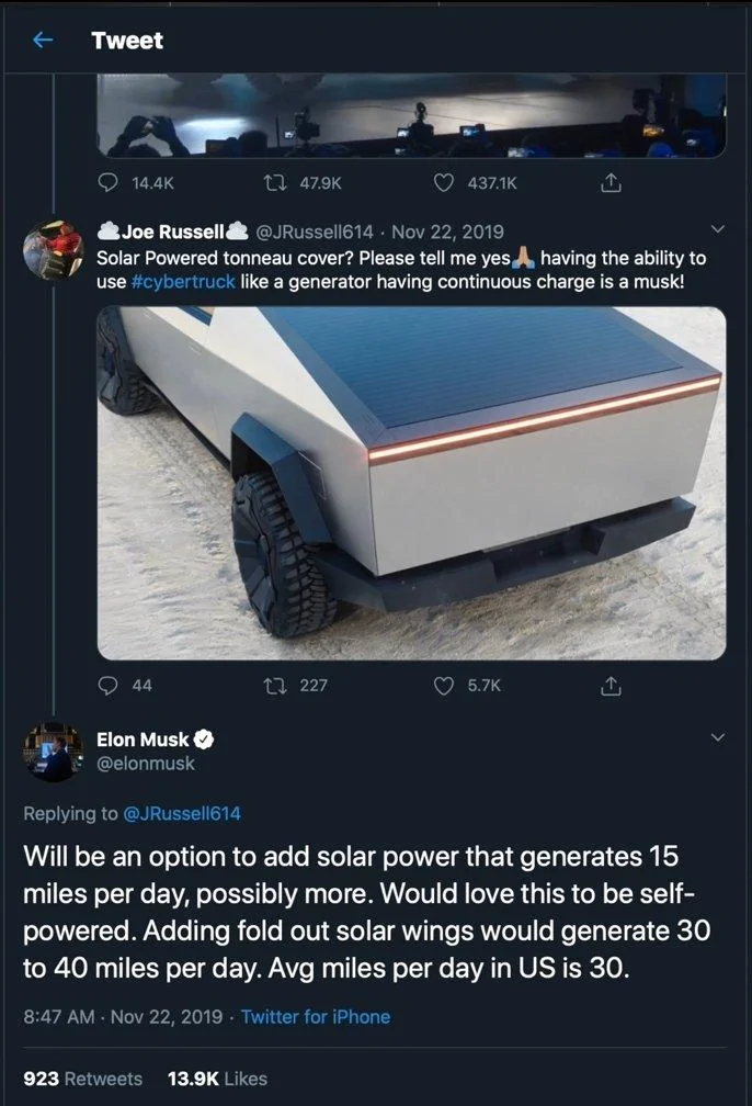

I average 4.79 hours of peak sun year round here in Nebraska. I drive 16 miles a day.
4.79*6,000/350=82. miles per day. I only need 16 miles of range so I need maybe 6 panels to get my 16 miles, right? Between the vault cover and roof, I can only fit 4 panels like your Hanwas. Tesla also does solar panels and I would hope they could do better for fit though their current efficiency is only 19.4%. Anyway, that'd get me 13.33 miles on an average day since I happen to park outside during those 4.79 peak sun hours I get. During the Summer, we average 5.4 peak sun hours which would get me 15.43 miles with my 4 panels. Pretty close to what Elon said. Cool. This is quite possible.
SunPower makes a 400 Watt panel. It's 22.8% efficient. Using the same ratio you did with your 315 watt panel, the 400 watt panel should put out at least 317 watts. 5.4 peak sun hours * 317 watts * 4 panels / 350 Watts per mile = 19.56 miles worth of charge in the Summer and (4.38*317*4/350= 15.86) during the Winter. I'd average 17.71 miles per day for the year with that setup.
Thanks! I wasn't sure it would make sense but now, I can see it does. Now, maybe not for everyone but for those of us with good sun hours, it does. Heck, if it just managed half of my commute, that would be great!
In summer your insolation is 7.00 hr/da (average between the equinoxes and assuming optimum panel elevation of 54°) but you only receive 5.4 which means clouds, haze, rain etc. are letting 5.4/7.0 = 77% through. In winter your average insolation is 4.7 hr/da on averaage (again, between the equinoxes). Applying the same ratio for the winter means that your effective average insolation for that period would go down to 3.61 hr/da. And in the dreary month of December insolation goes down to 3.6 hrs per day and, with the same 77% factor for weather, that leaves you 2.8. Thus yes, in summer it is quite possible. In winter the picture is less rosy. What I'm trying to get across is that you cannot count on the best conditions pertaining all the time. Although I must have said it a dozen times already here and elsewhere, in citing performance Elon isn't going to pick the worst case. He's going to pick the best case and maybe even boost what his engineers calculated for best case a wee bit.
Another thing you seem to overlook consistently is the vampire tax. In my X it seems to amount to about 5 miles per day.
In any case it is pretty clear you understand how to work the numbers. If you do so and are comfortable with the results then that's what counts.
