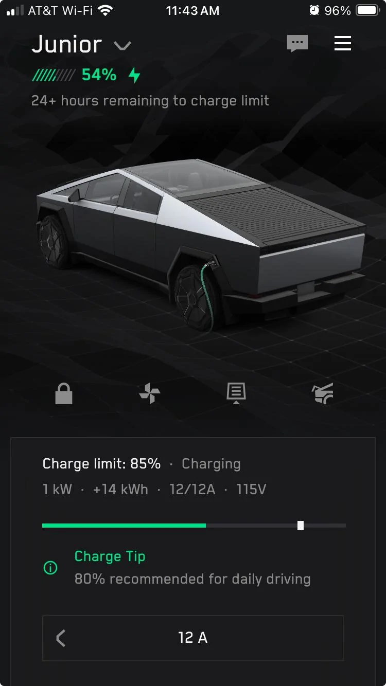

False? lmao. with the provided 120 adapter yes it does. Guess you didn't get a truck yet. Well when you do you'll see that with the 120 adapter 3 pronger it does. The 14 50 plug adapter with provided charger will get 32 amps yes so maybe you don't read well or understand what you read and just jump up and scream when your brain farts and go off!! LMFAO AT YOU ALL DAY!! GFY Bully
I was simply correcting the misinformation you posted. Why do you feel the need to turn it into a pissing match every time I do that?
Your claim was that the "cable provided with the truck" takes 4 days to charge the truck. I corrected that false statement. Tesla provides a plug for a NEMA 14-50 outlet, not just the wimpy 120V plug. If you don't like it, stop posting untrue things about the equipment supplied with the truck. People don't need to be misinformed, there's enough of that out there already.
