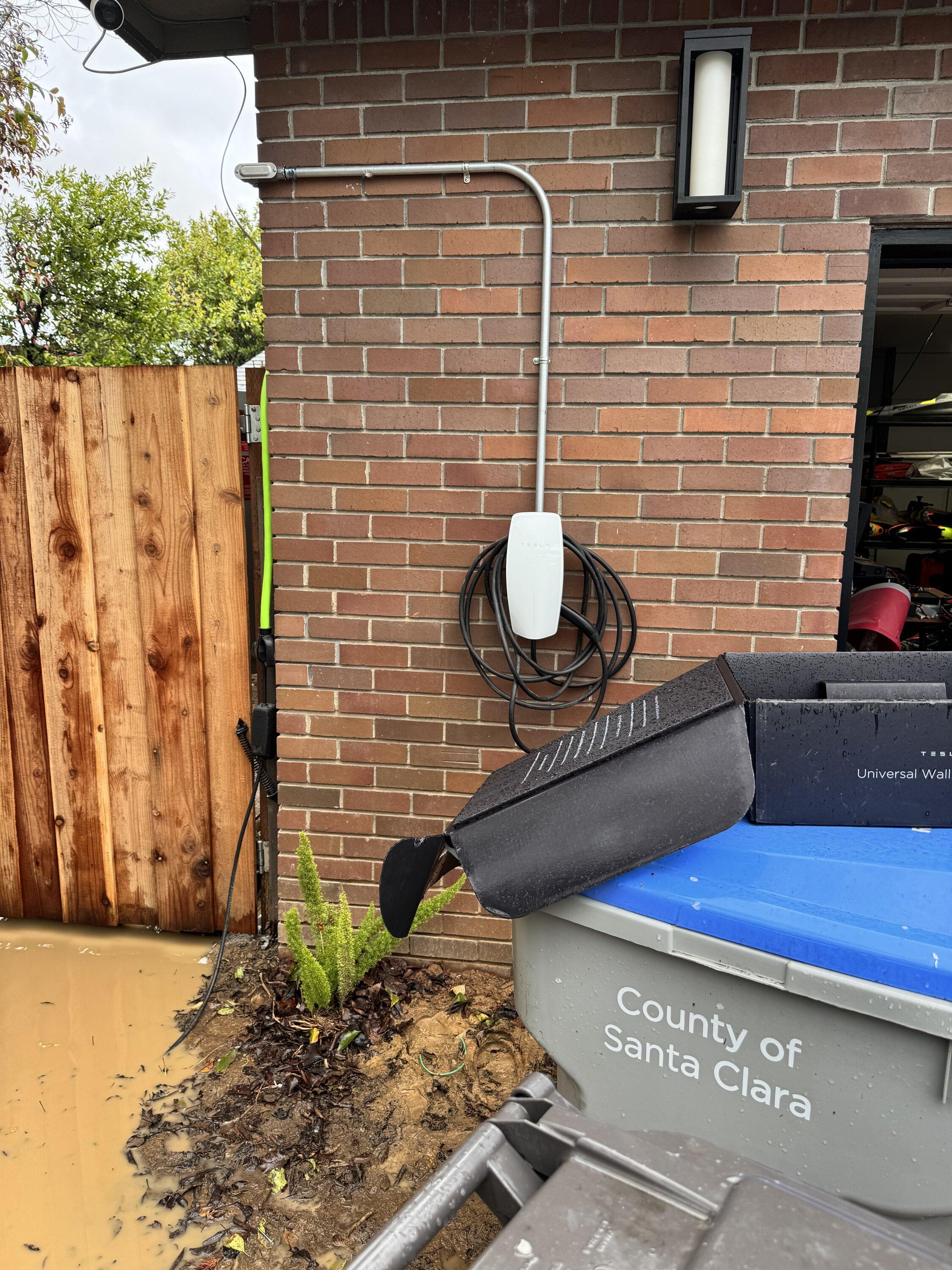

Just had PowerShare (gateway v3 plus wall connector) installed and I added a uni wall connector on the external corner of the house where I park the truck.
Tesla Cybertruck Charging (level 2) our Cybertrucks outside the garage? (If CT doesn't fit in garage) IMG_2748
Cable management tip:
It looks neater, and is easier to deploy/put away, if you drape (fewer) longer coils on the Wall Connector.
Pro tip: always mount the Wall Connector a little higher than you think in order to accomodate bigger diameter coils of the charge cable. This causes less twisting of the cable, making it easier to deploy and put away neatly. You should only need three coils to hold the entire 24 feet of cable.
