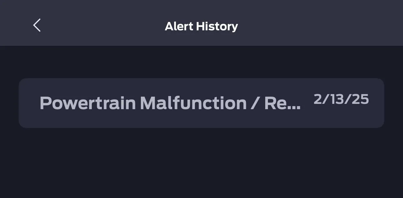

Powertrain Malfunction /Reduced Power
What Is Happening?
Illuminates when the system has detected a powertrain or a four-wheel drive fault.
What Should I Do?
A Powertrain or All Wheel Drive (AWD)/Four Wheel Drive (4WD) fault has been detected, contact your authorized dealer as soon as possible.
