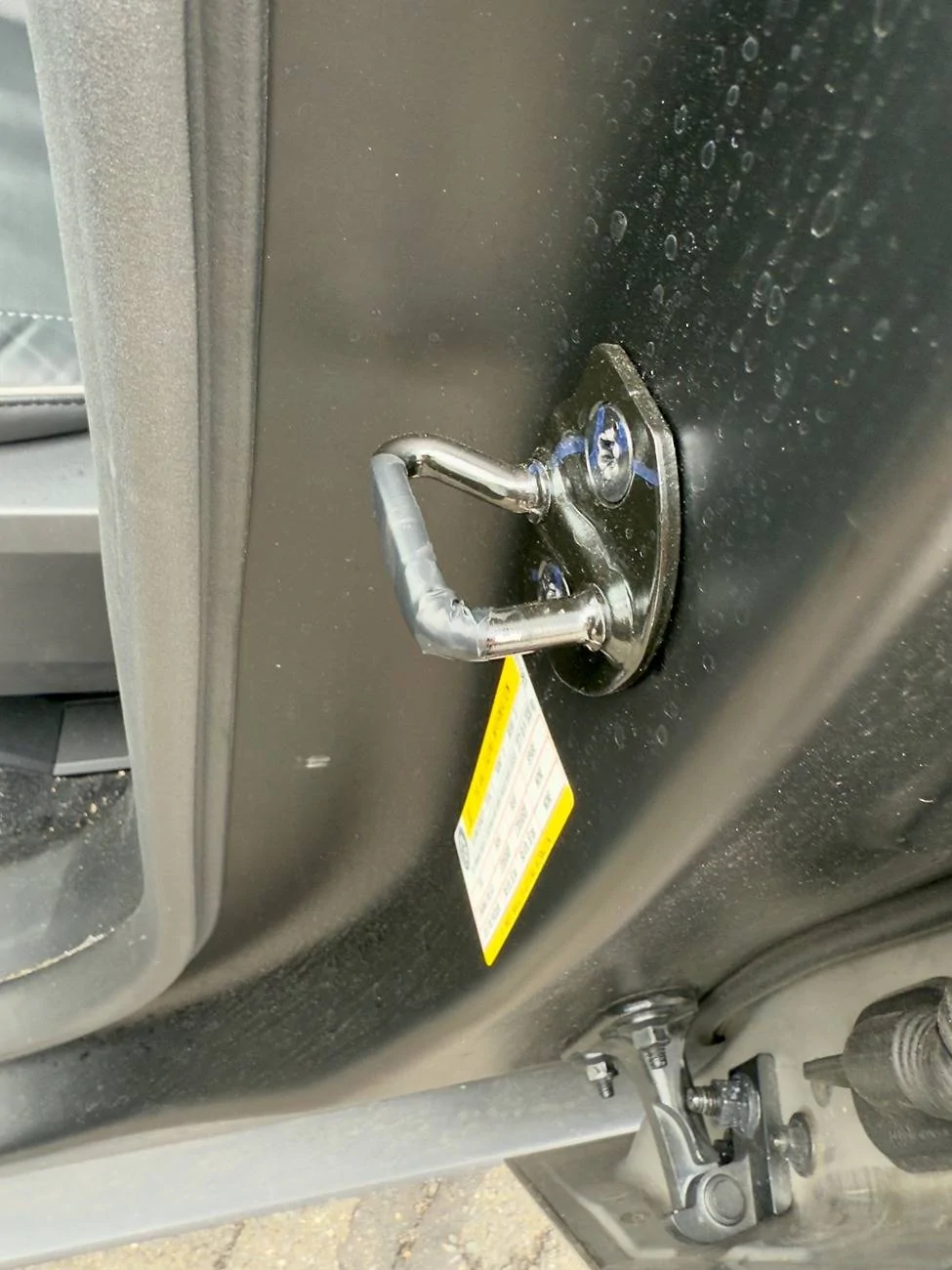

I did 3 wraps of electrical tape on all the doors haven’t had an issue since.

That noise is coming from door strikers, had that in my Beast for a while tesla will lubricate them but noise would come back, i fixed for good put some elletric tape on all 4 strikers and noise will go away until tesla has a fix for it.
Tesla Cybertruck Creaking with slow speed acceleration and deceleration IMG_0913

Had mine for 4 months and I just got the creak from what sounds like my passenger side b-pillar. Thanks, to this thread, I know what to try to fix it: add some grease (I have some waterproof grease I use on the axle rod on my motorcyle) or electrical tape on the door striker.
EDIT: did some research and white lithium grease would be best to use.

It turns out greasing the latches and insulating the strikers was that easy. Much thanks to this community.

Adding another data point. My truck developed a creak from the passenger door over the past few weeks - only really noticeable when accelerating or decelerating. The electrical tape trick worked for me too.
