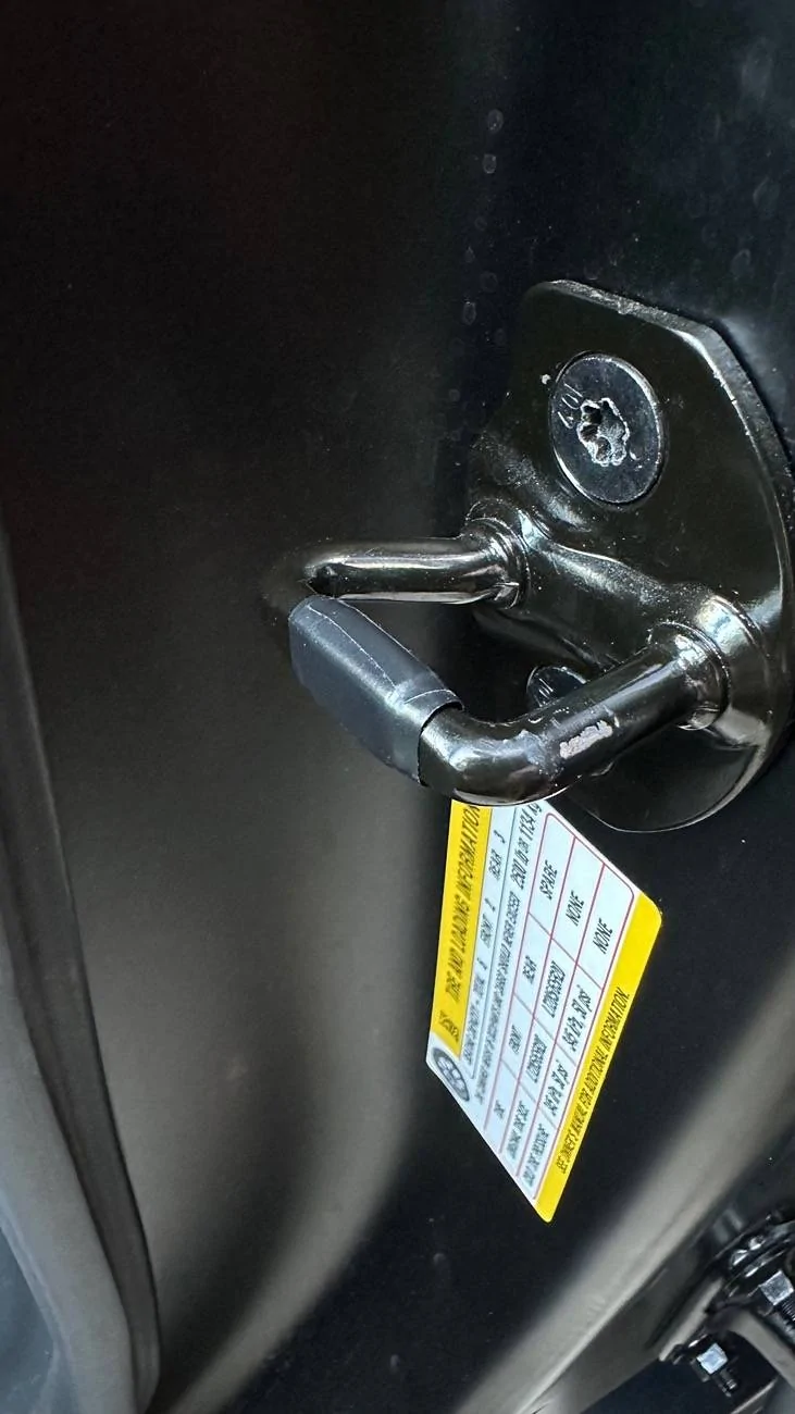

Grease up the front door latches and itll fix your issue

I have a similar sound on the drivers side. What I have noticed is that if I roll down the window 30% or more...that sound is gone. If I roll it back up, it is there. So I am wondering if the door needs to be adjusted versus just that striker.

No. It’s the striker. The window position is a red herring

It’s the striker.
Someone needs to make a sticky on how to fix all these squeaks. I've fixed half a dozen so far.

I had the same issue with a creaking noise coming from the driver's side B-pillar. A few days ago, it was resolved with the following repair note:
"Adjusted door strikers to eliminate door movement when closed. Verified the door closes as intended and no longer rattles."
Unfortunately, I’m now noticing similar noises from the passenger side and possibly the rear doors. In the meantime, I’ll try some of the suggestions shared here to address the issue until I can take it back in for further repairs.
You were correct. A couple of wraps with black electrical tape did the deed. No more knocking noise at low speed. I have a service ticket to take it in next month to get it fixed.
I had the same issue. A few wraps of tape on the strike side worked. No more noise. Have a SC appointment in 4 days see what the remedy is.
