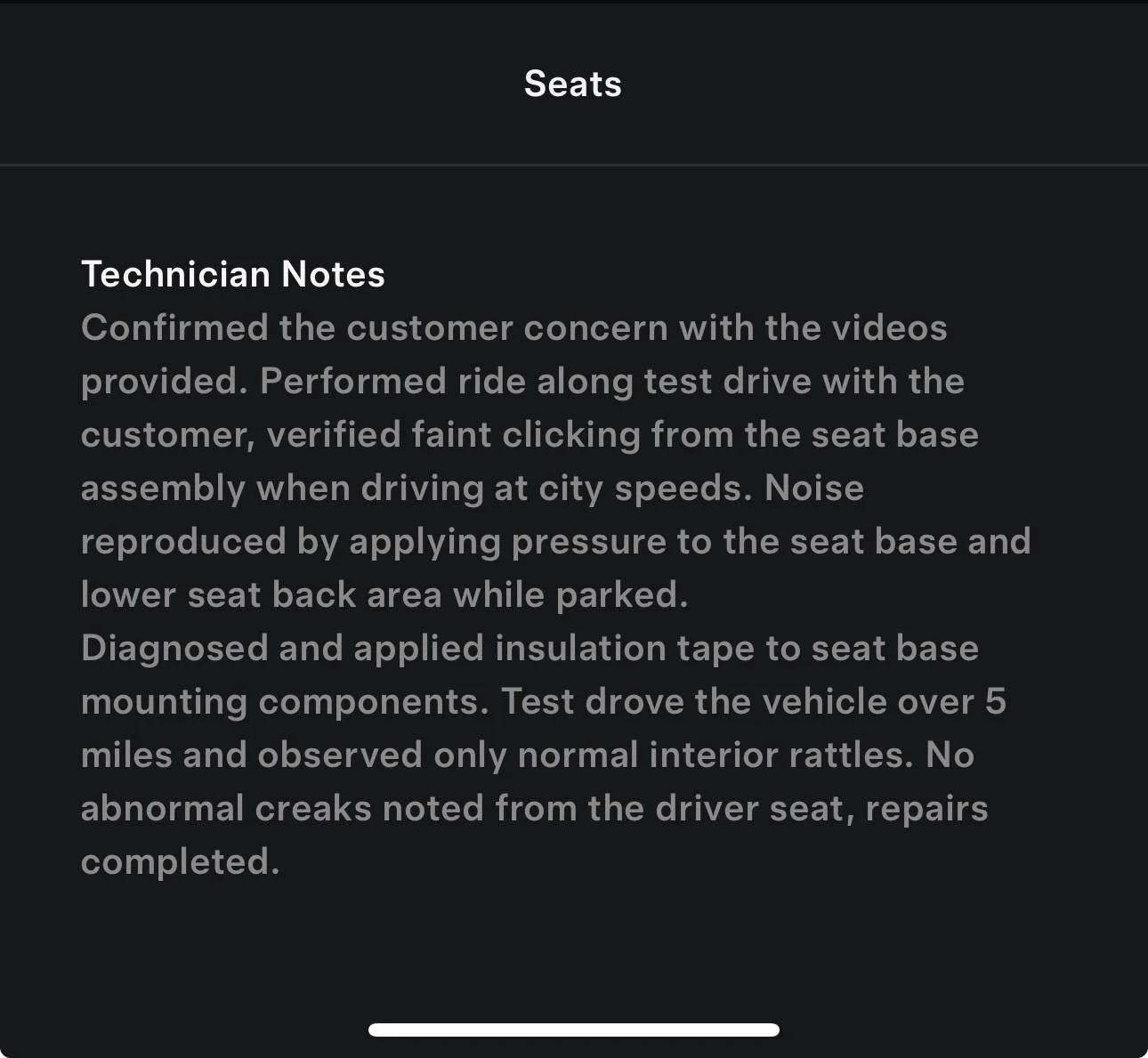

I use silicone for interior, WD40 for exterior.Side Note: did you try WD-40?![]()
Came here searching for the exact sound you got on video! It’s been driving me nuts for about 3 weeks now. Less than 2500 miles. Did the tech say this is something we can easily fix or worth going in for a service appt?It’s coming from the rail or the height mechanisms. Anyone else had this?
Get some WD40 silicone and spray all of the hinge points.Came here searching for the exact sound you got on video! It’s been driving me nuts for about 3 weeks now. Less than 2500 miles. Did the tech say this is something we can easily fix or worth going in for a service appt?
