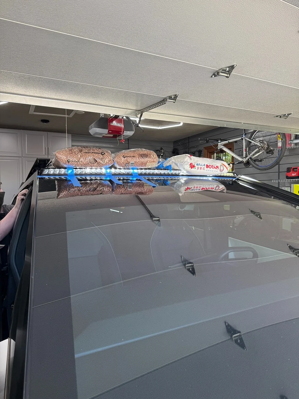

  4. Install the bar on the windshield and tape down with masking tape. (My son and I, this is a two person ordeal)
  5. Plan to use 4 - 25 LB bags of rice (yes, rice, this is what I have around the house, there's more than a food use) Planning to let them sit on there for 3-4 hours. It's going to be in the high 80's here and dry over the weekend.

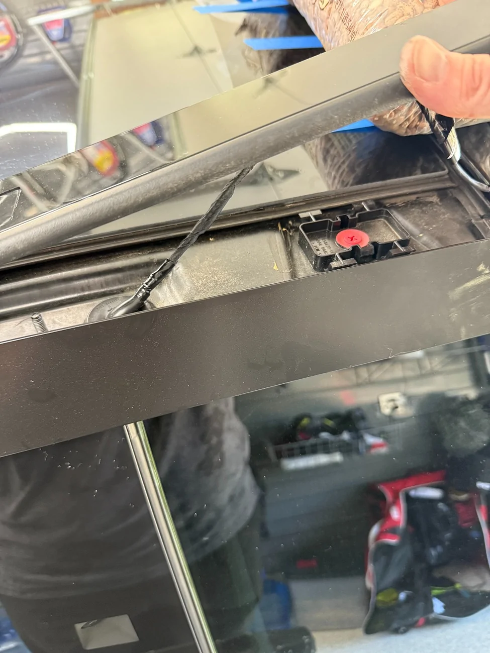

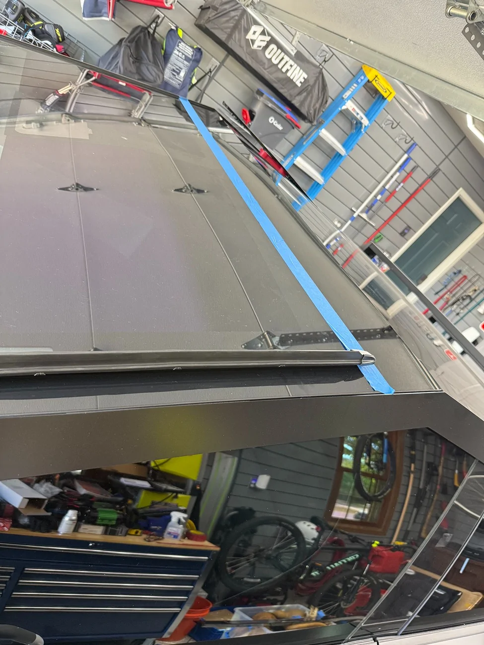

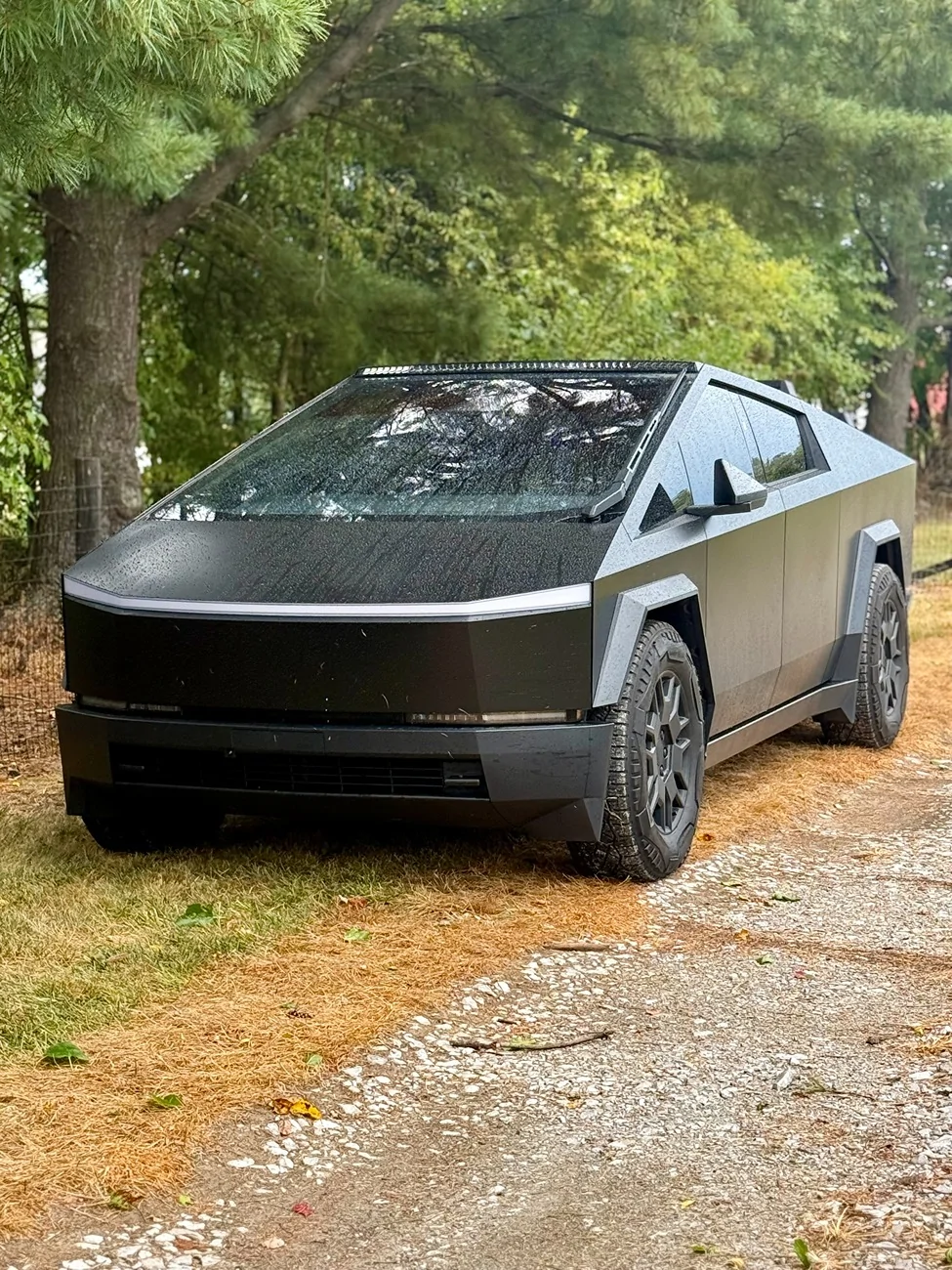

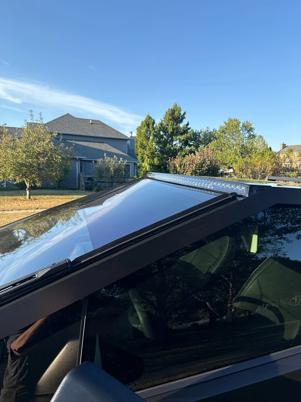

Followed the process I outlined. No issues. One good thing by doing this myself there was no wire splicing. It was as simple as unplugging the feed going to the roof in the b-pillar and plugging in the bar.

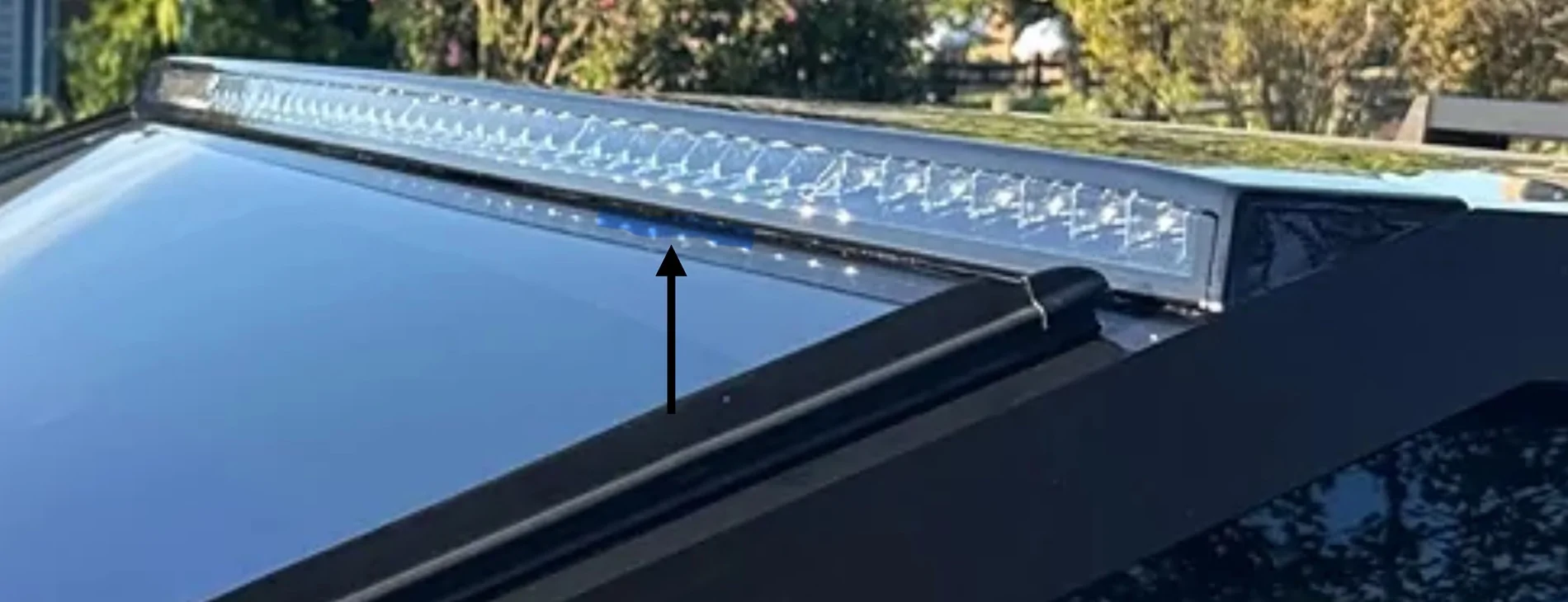

Looks like a good solid install. Were you able to fill this gap between the bottom edge of the lightbar and windshield? BTW all new SC installs are completed with all the electrical connections. Just the software push when entering the truck.
I'm going to put another bead of sealant to close the gap today/tomorrow.

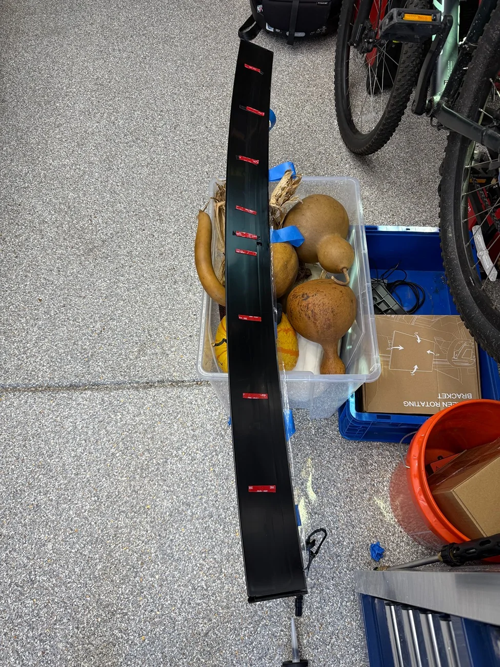

I ended up going all the way around the outer edges first about 2 cm in so that when you push down on the glue will squeeze the edges. In the center all the way across the bar, I scalloped it sort of making a bunch of connected U’s.
I wanted it to cure for a couple days in the sun. Now that that’s done, I’m going to add a thin bead across the very front to ensure that there’s no gap. To do this, I’m going to Mask the the front of the bar below the light itself and put a piece of masking tape on the windshield. This way I can run a thin be to caulk smooth it out to make sure it’s perfect and peel back the tape to leave a crisp line.
