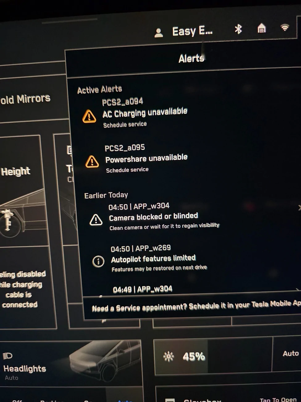

I have a 2024 non FS Cyberbeast with Powershare and 2 universal wall connectors which have been working perfectly for the past year. This past Thursday I charged at home uneventfully to 80% and then when I tried to charge on Friday last week, I kept getting error messages. The weird thing is I can charge at the Tesla supercharger, so I barely made it to one. I am taking it to service tomorrow, not sure what the issue is. Should be covered under warranty, curious to see what they find.

Can you go into service mode and share the alerts?

Your Power Conversion System PCS may had failed.

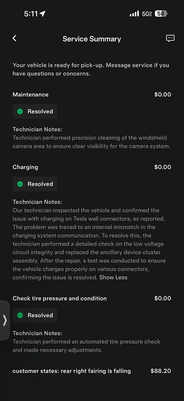

We have had lots of rapid firmware updates during the last 6 weeks. Those firmware updates are probably revealing problems that have always been there.
Tesla Cybertruck Cyberbeast won’t charge with Wall Connector IMG_4126
fixed in one day.

I had the same charging issue in October of this year. The SC replaced the Ancillary Device C;uster Assembly and the Low Voltage Harness. This fixed the problem. It took a week to get the part in, but only a half day to fix it. It was under warranty and I was given a loaner as well.
