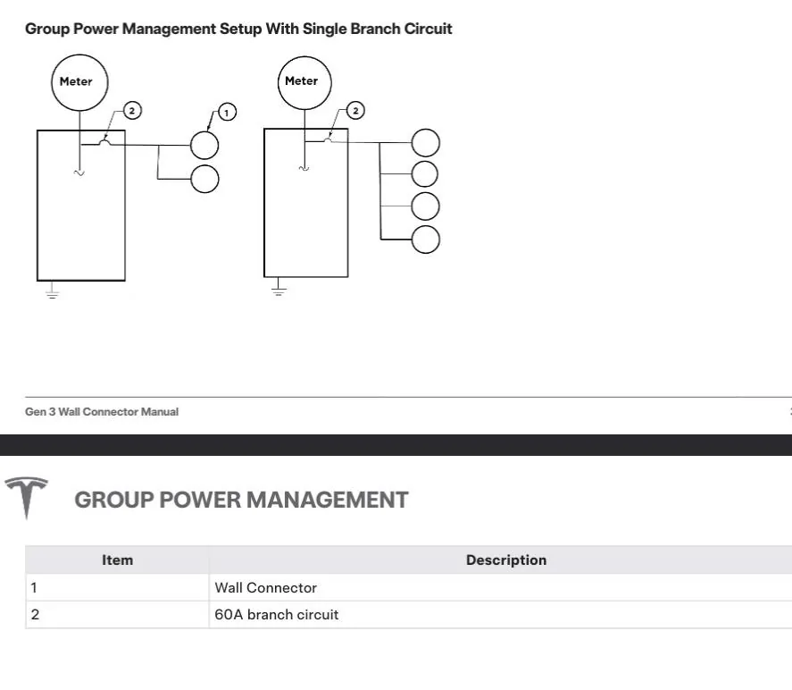

Yeah, the 2023 Y RWD is only 32A, but we're still taking the situation where the both wall connectors have the same wiring issue that doesn't show up during a full 32A charge, but does in a couple minutes at 48A. Which *could* be the case if they are configured in load share mode and on the same circuit...
Load sharing does not stop charging on a wall connector all together but averages the combined load or sets it to your preferred load sharing setting (as set up through Tesla one app)
Right, but load sharing allows multiple wall connectors to be fed from a single breaker in which case both WC could exhibit the same behavior. Whereas with individual branch circuits, it's unlikely to be a wiring issue.
no, that is a bad idea. Wall chargers must have their own breaker. Load sharing is accomplished by the chargers negotiating their needs via WiFi

no, that is a bad idea. Wall chargers must have their own breaker. Load shating is accomplished by the chargers negotiating their needs via WiFi
That may be true with the Gen 3 wall connector. However, the universal wall connector has documentation for daisy chaining multiple universal wall connectors with one breaker. The lugs are different between the Gen 3 and the universal.
