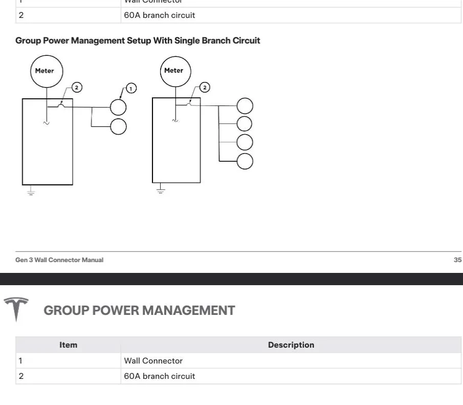

Is it 8? Manual calls out 4. https://www.tesla.com/sites/default/files/downloads/wall_connector_installation_manual_80A_en_US.pdf
Comparisons:
Gen 2: 4 units
Gen 3: 6 units
Gen 2: wired connections
Gen 3: wifi
Gen 2: 100A breaker max (80A max charge power) shared across all units
Gen 3: With individual breakers, can have any total power level and each can have a different breaker rating
Operation during loss of communication is different also.
Four it is! I was just going from memory!
