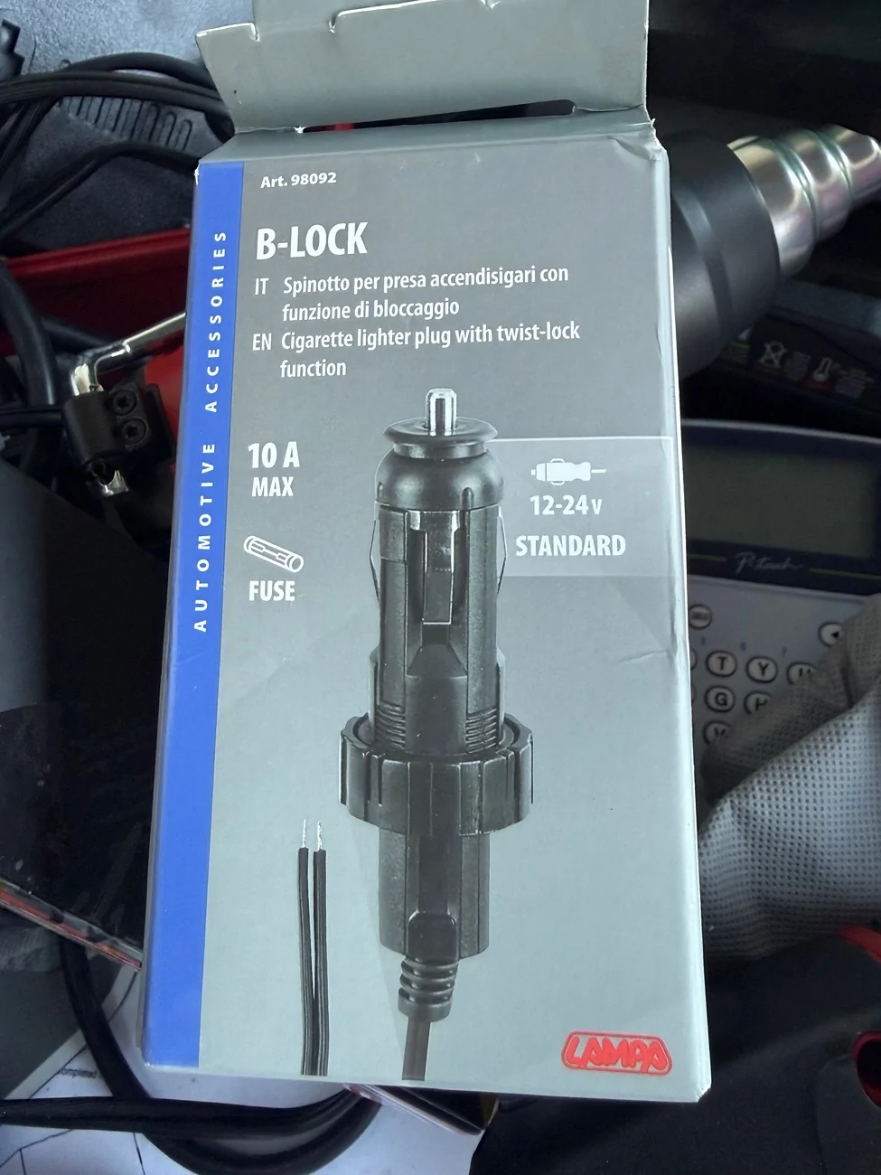

Just an idea. Any way to secure it would work. I just think it would be a pain if it was a finicky connection. I’m avoiding saying pain in the ass because of that bizarre sidebar in the video
No idea why it has to veer off to medieval butt torture to make the point, but I liked the product. lol.

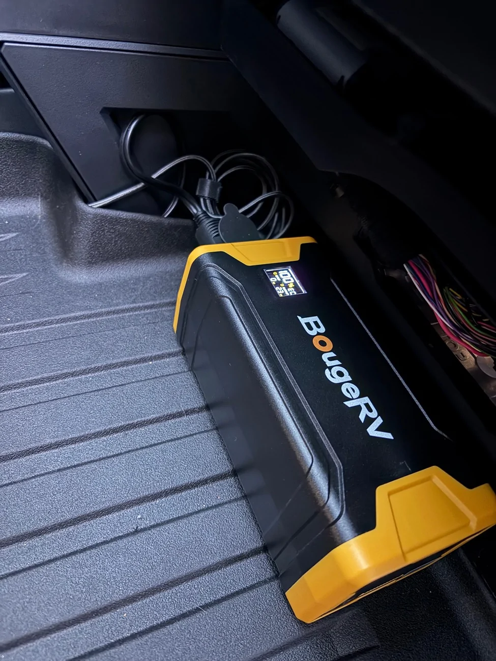

I just got a right angled usb-c to minimize profile and plugged it into one of the rear ports. Then I hid it between the seat rail and center console then into the battery. You’d have to really know what you’re looking for to even find it honestly.
as an interesting note, that fridge actually has a usb-c out on both the passenger and and drivers side so you actually increase your number of available plugs and you also get them in a much more convenient spot than under the rear center console.

Found a picture of the box. Yes, it’s crappy quality but it works VERY well. If you’ve ever been annoyed by these plugs coming out, this is a real solution.

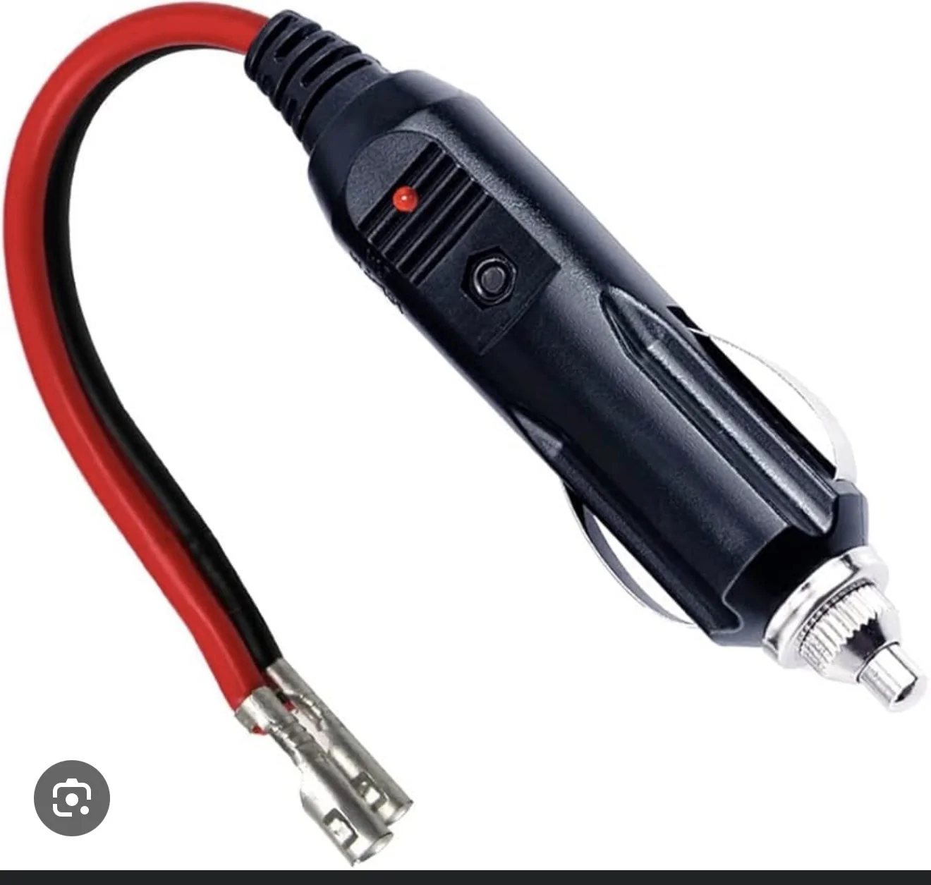

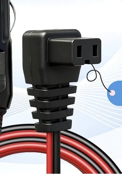

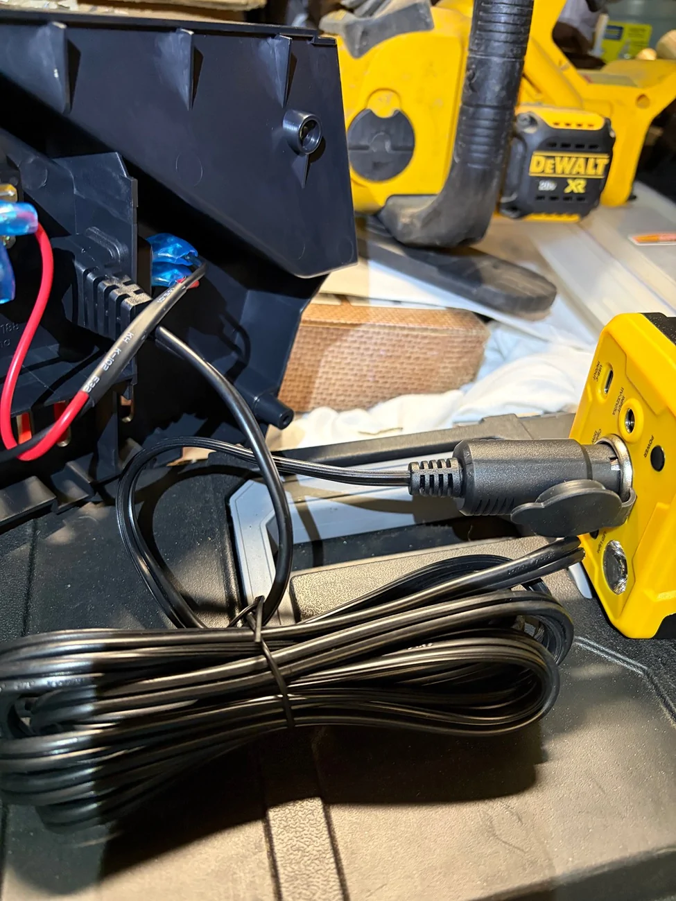

I just made a cable that was that at
one end and something like this on the other.
Nothing complicated.
That way you can still power the fridge however you like.

I don't get it. The battery is too big to house the plastic portion where the fuse boxes are .
If you aren't directly wiring to the refrigerator how did you get it in?
Thanks
QUOTE="hemiarch, post: 30688200, member: 29241"]
[/QUOTE]

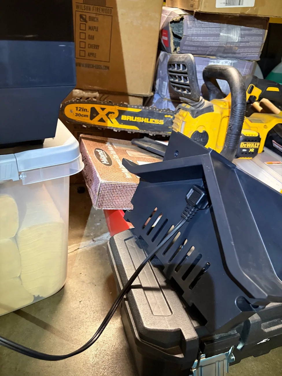

I got rid of that whole plastic housing. You basically just need your fridge wire to end up as this…
Tesla Cybertruck Cybergearco Cooler / Fridge / Refrigerator -- DC Install IMG_6743
Or similar.
Am I misunderstanding the question?

I thought you kept the original female end of the wire from the refrigerator got it
Thanks
Or similar.

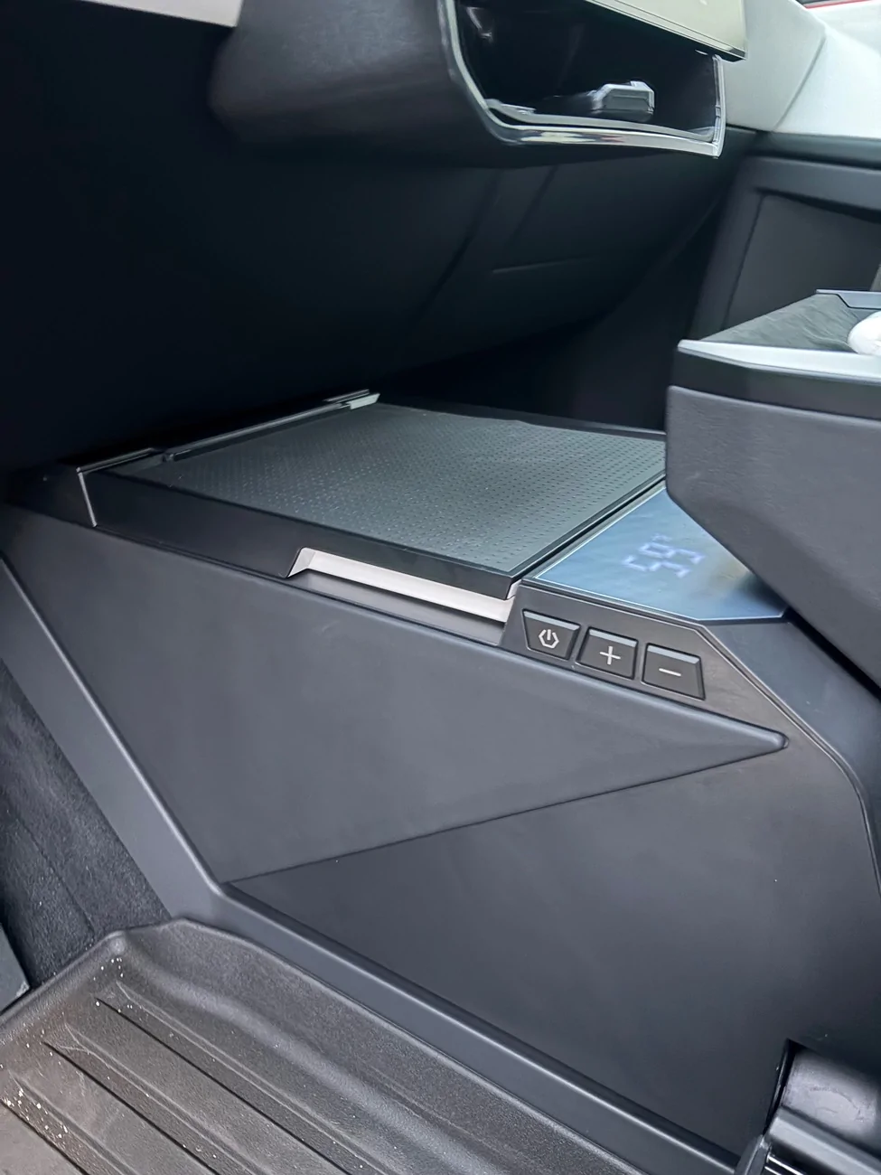

So I finally got it installed. I'm currently going with battery under my seat with wires hidden and I'm glad I did that because I ran it 24 hours and the fridge was warm battery was completely empty and not charging from the usb c ?? What am I doing wrong here? Do you keep your fridge on most of the time? Do the usb c power off after 12 hrs?
Post some pics of your awesome dc fridge
It’s on all the time in mine. Have you checked the “keep aux power on” box in the UI?
Is the display on the battery showing both input and output numbers?
It’s at the bottom of “outlets and mods” in the CT unlike the x where it’s under charging
Tesla Cybertruck Cybergearco Cooler / Fridge / Refrigerator -- DC Install IMG_6782
