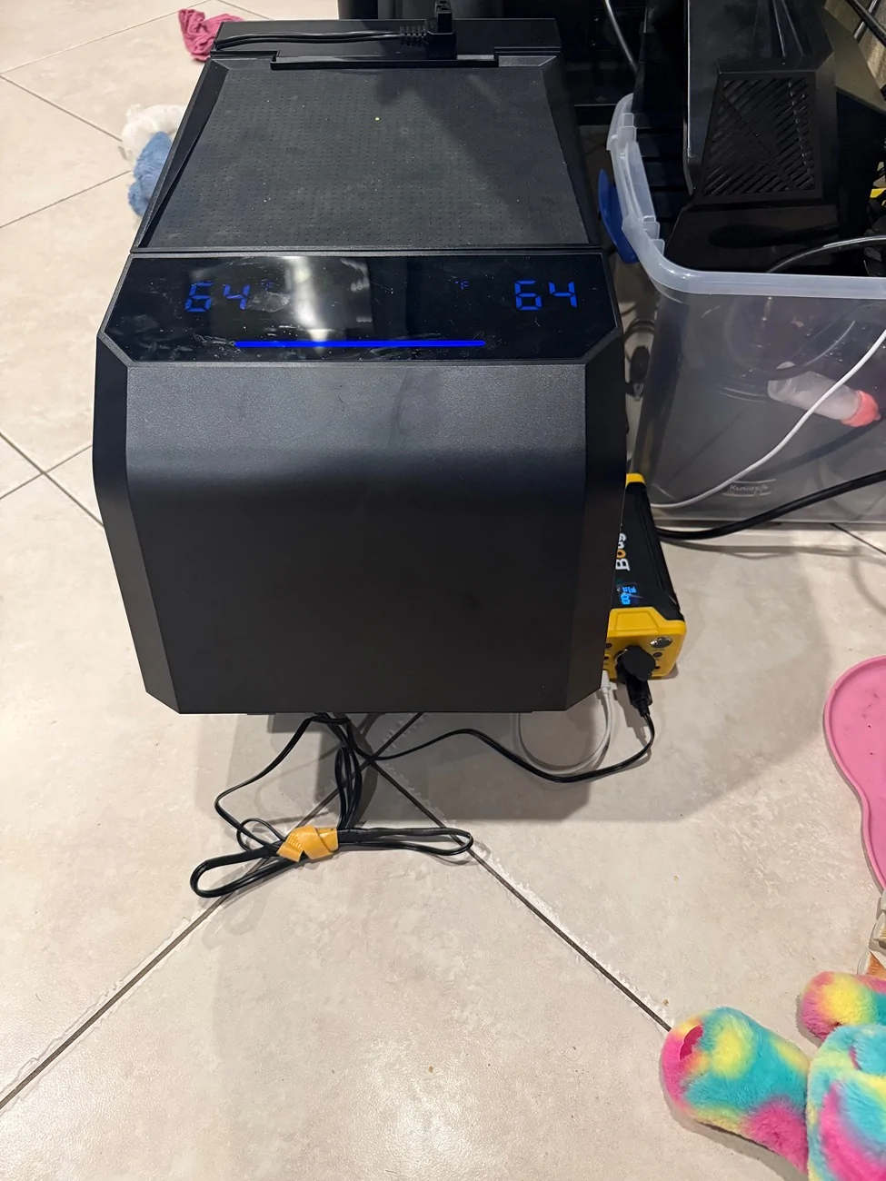

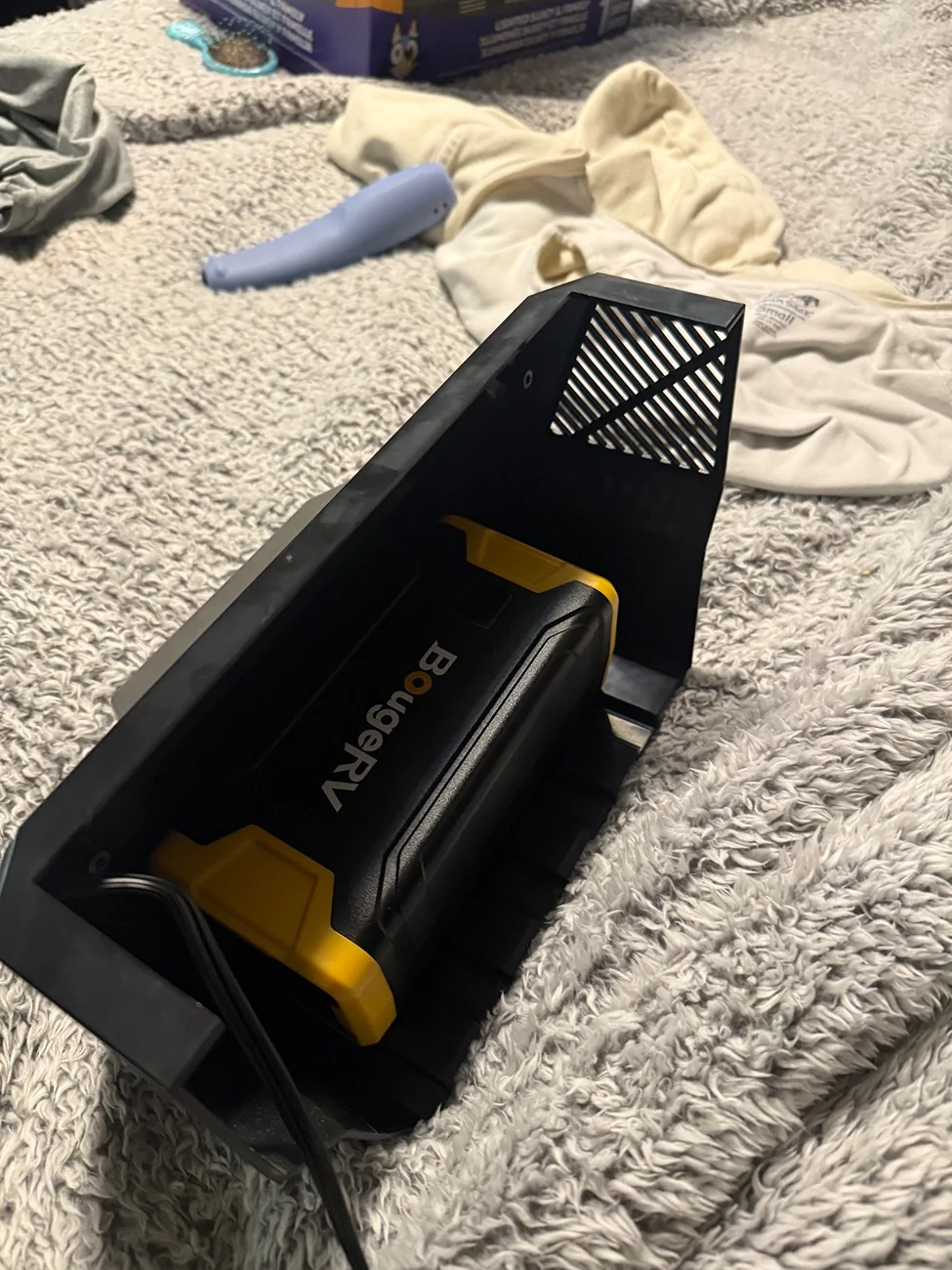

Will shoot some pics for you when I’m done with my shift. Velcro is what I did.
Three pieces of loop in the recessed grooves between the “stripes” and a single piece of hook on the bottom of the battery. Not even sure this is necessary because it’s pretty caged in there so there is zero risk of it going anywhere to have a drink or meet ladies, but I wanted it not to get knocked around.
After about a week of using it, I added my usb hub right on top of it too so it’s confined from moving upwards as well.
In other words, the Velcro was probably overkill.
I probably could have used a little piece of nano tape and called it a day or even not secured it at all.

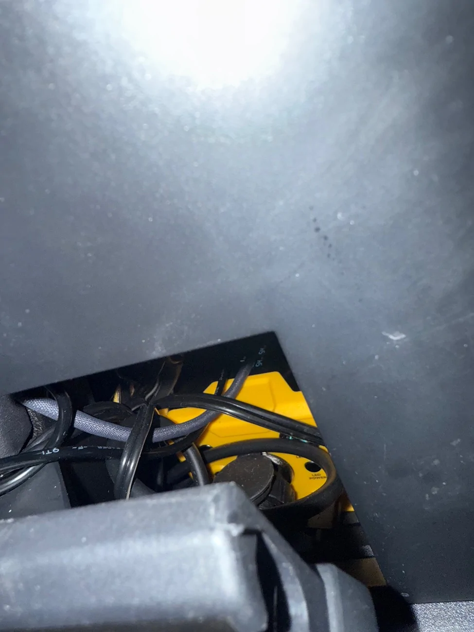

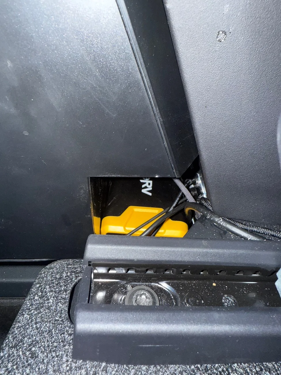

I should have documented a little better when I was actually installing it. Sorry. It was hot AF in Phoenix and I was doing this outside so I kind of rushed through it. Here are some pics from the driver and passenger side with the seat all the way back.
Wires are a little messy back there because I also have my usb hub tucked in the same space. The space between the fridge and the little plastic side rails of the center tunnel is a great place to hide cables.
Both my phone chargers, my Starlink and my dashboard “hub”thingy are all powered from that same place.

Fwiw, it’s been running uninterrupted for the better part of a week now using only usb-c with zero issues and my car goes to sleep.

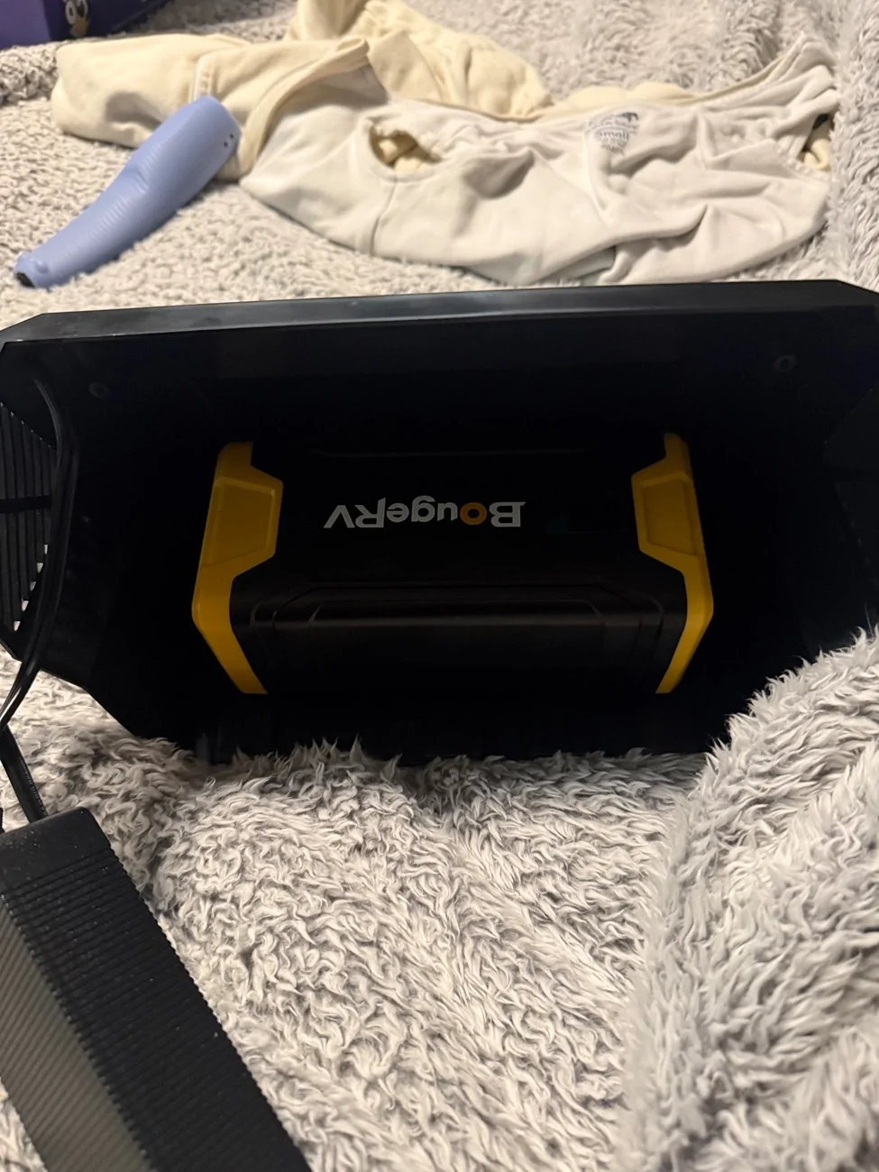

That’s exactly right. I’ve made myself crazy trying to figure out what condition causes it to turn off. It’s almost completely at random. that was how I wanted to run my fridge at first too.
If the big power station thing seems clunky to you, there are little batteries that can charge off of usb though also and are plenty for when the car is level 2 charging overnight. .
My most recent approach is this little battery from bouge rv.
https://a.co/d/dnTYdWu
It fits nicely in the space previously allocated for the ac to dc power brick. Ultimately I scratched the cover housing for access and probably slightly better ventilation because you can’t see it anyway unless you pull the seat all the way back.
So….battery but with zero footprint in the cabin or frunk.
