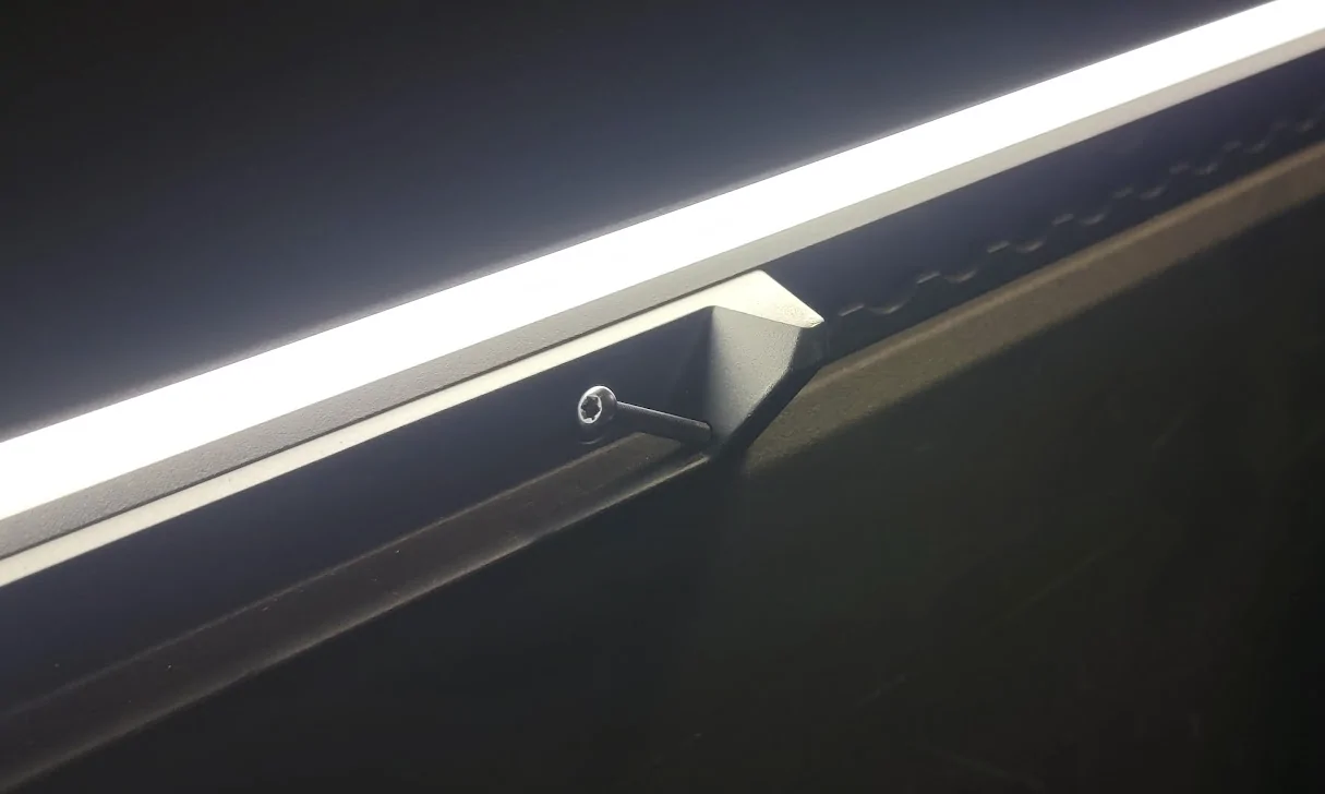

No. There is a torx bolt that should be installed to hold it in place. The are also a number of other parts that should have been replaced. Probably should go through the installation instructions to make sure everything was done right.
Mine was mostly right. The corners of the cover was pinched when they installed said bolt so I had to re-install it.
Here is a pic of the bolt you seem to be missing (sans tent). I had to pick up a large load so removed the tent - I just screwed it in for the pic since the bolt hole is easy to miss otherwise.

Thank you. That was very helpful.

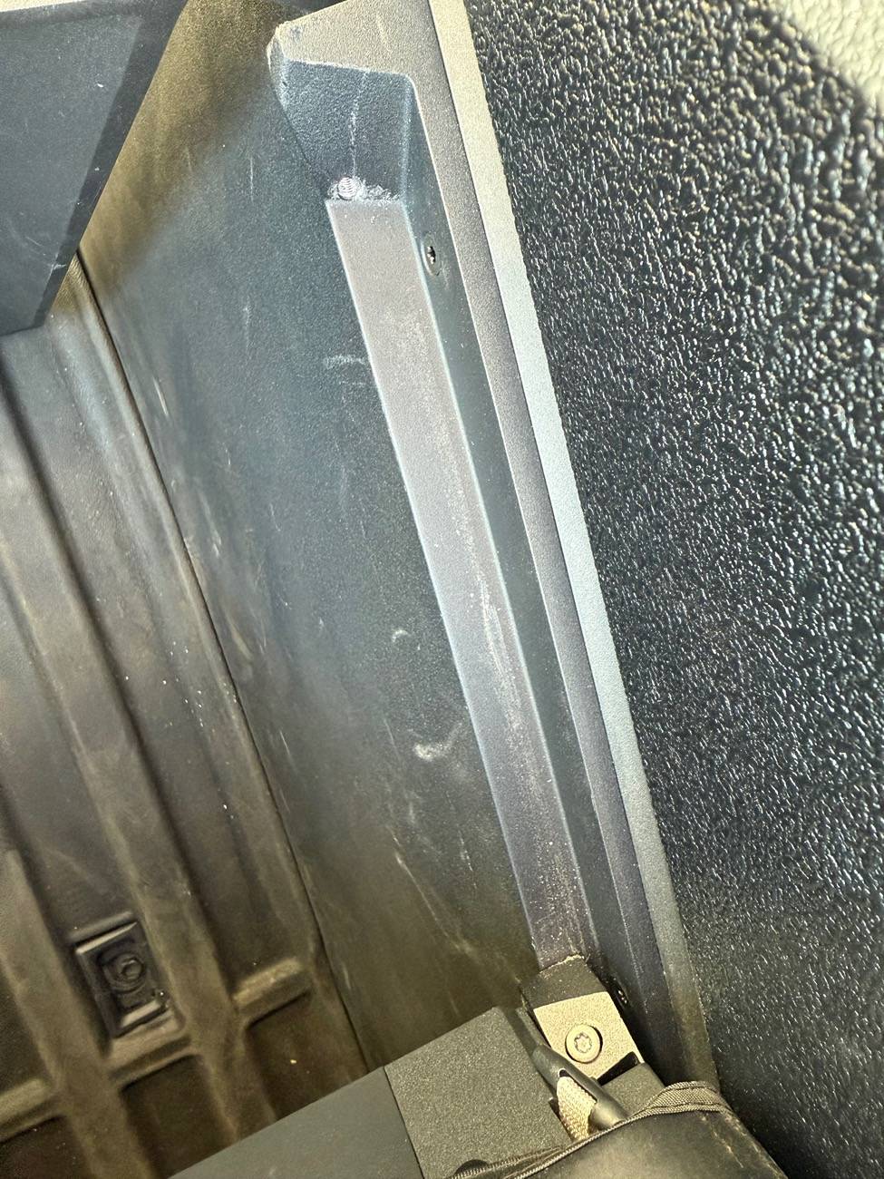

So I took it to Tesla this morning armed with your photo so they took the truck back to the tech who then “found the screws somewhere” and apologized for leaving them off.

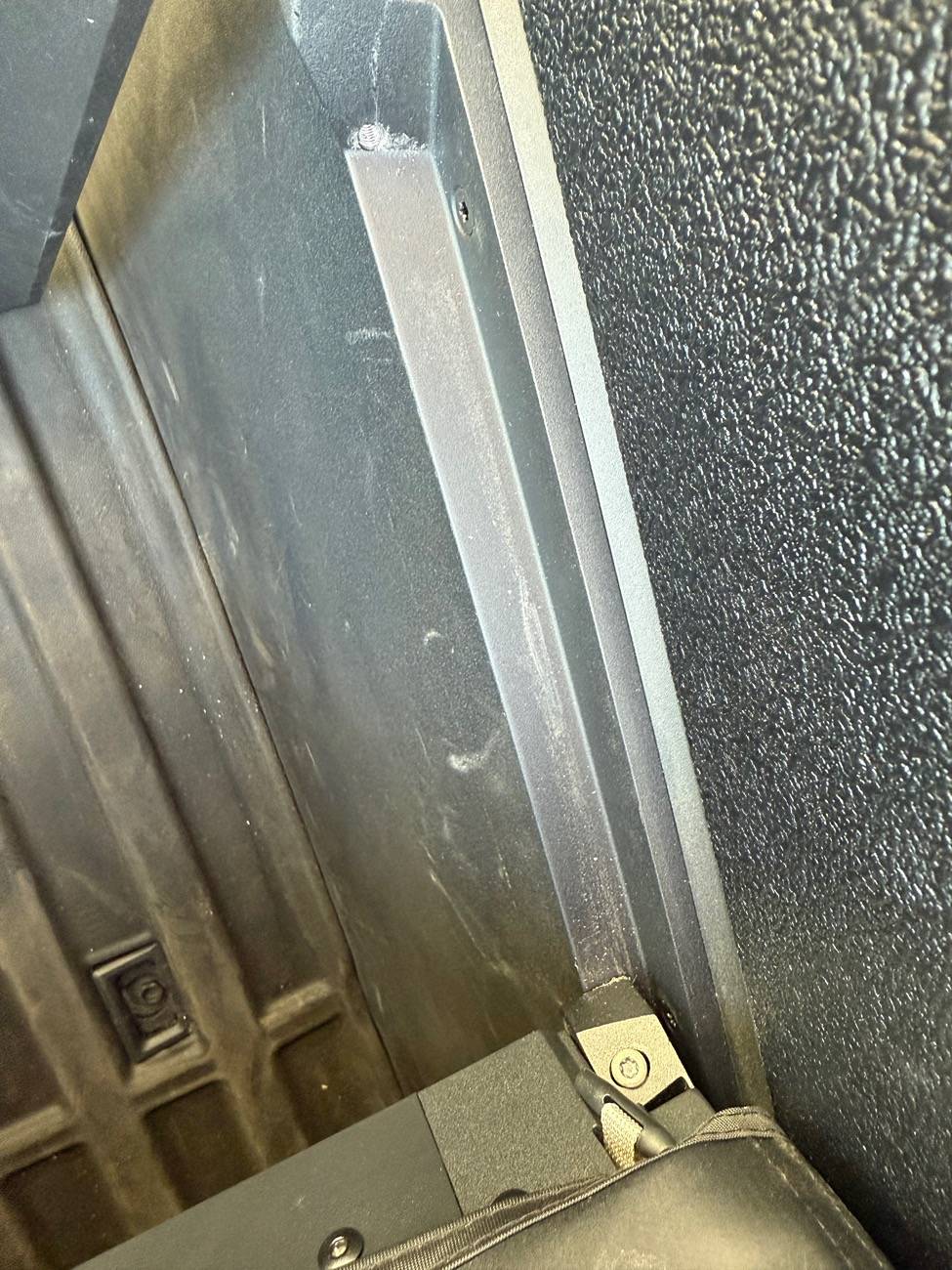

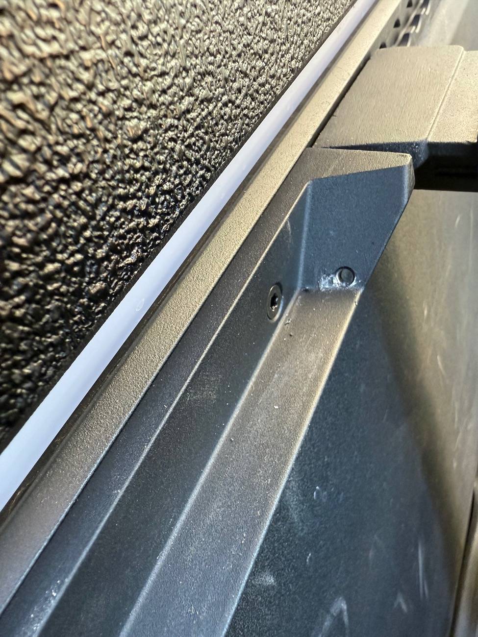

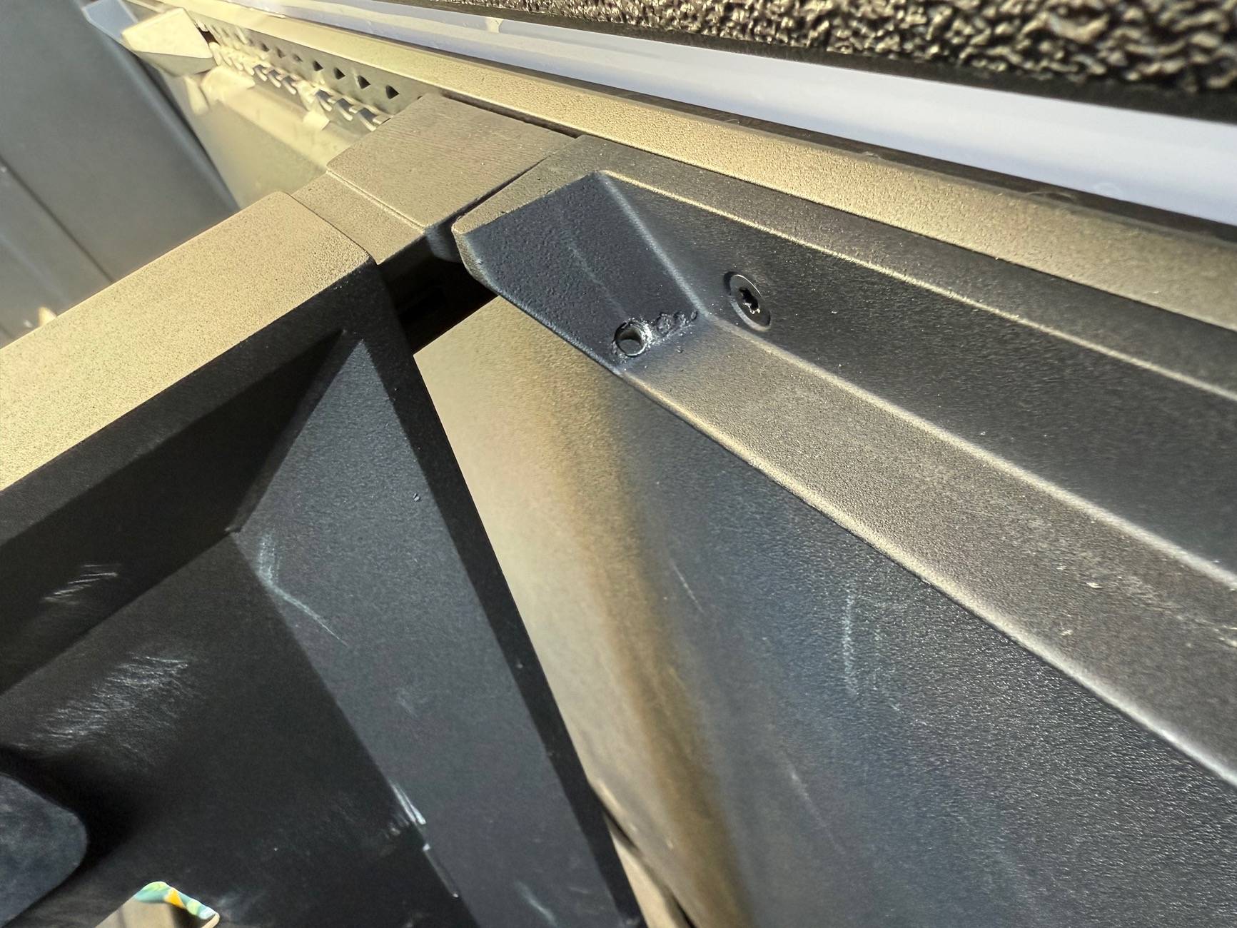

now that I have a closer look there are other screw holes that look empty.
I asked If this was normal and they said yes.
Just want to confirm this also looks normal to other tent owners.

Nothing in the other holes - I suspect they are there just so they wouldn't have to carry a left-hand and right-hand version of those rails. Same part works on either side that way.

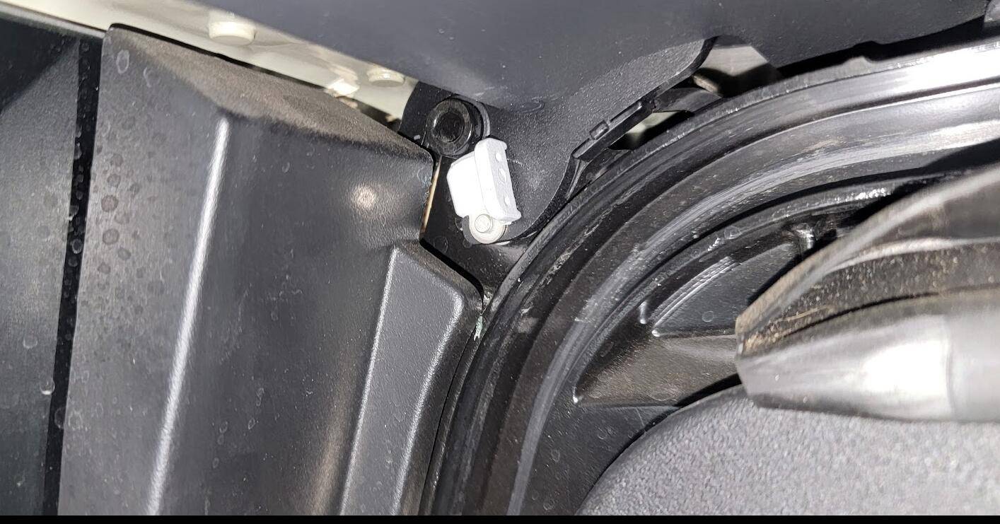

You might want to take a peek under the tonneau trim at the front of the bed (with the tonneau open). Make sure they replaced the clips at the back with the ones with the white plastic release tab. Should look like this:

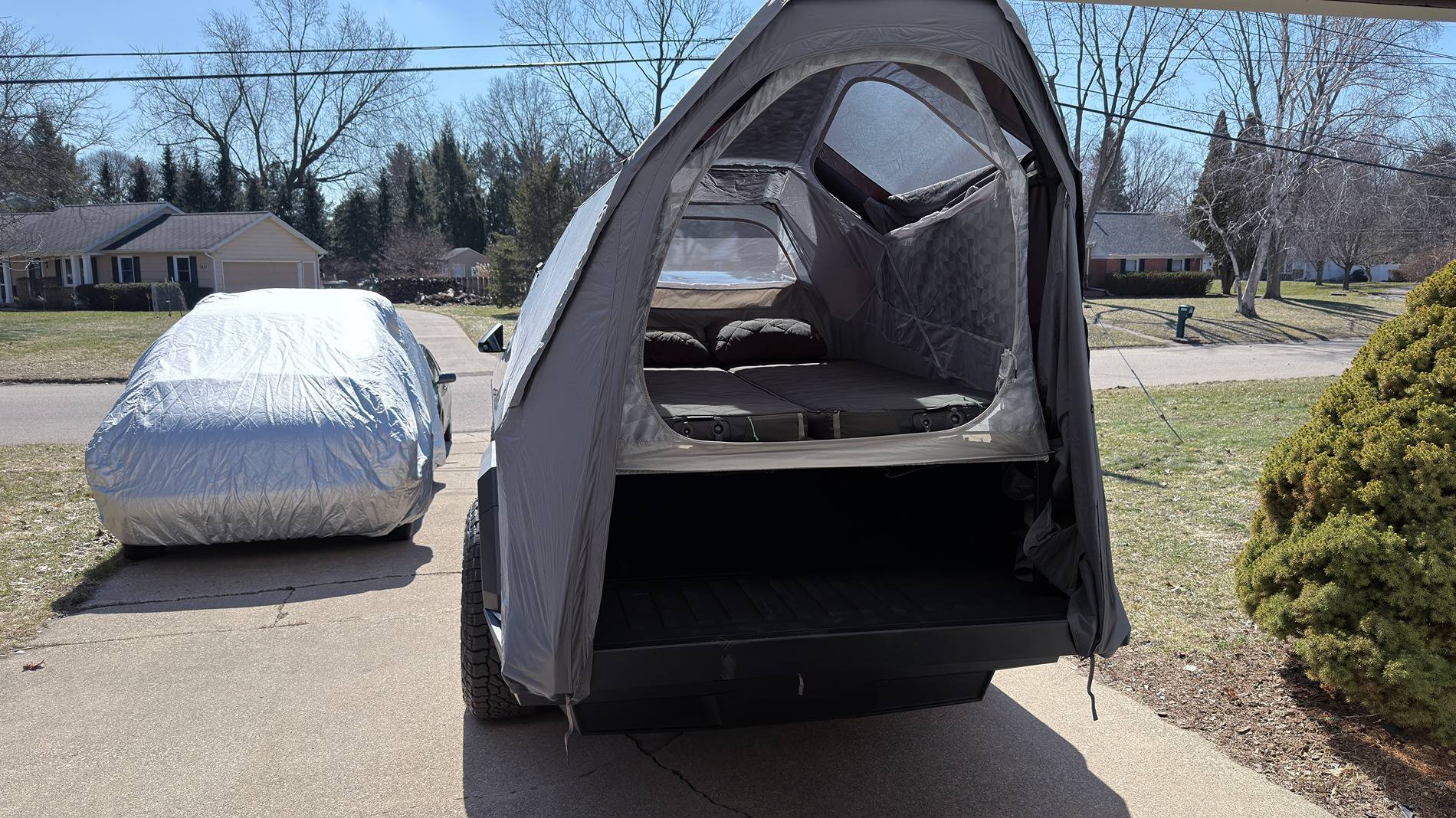

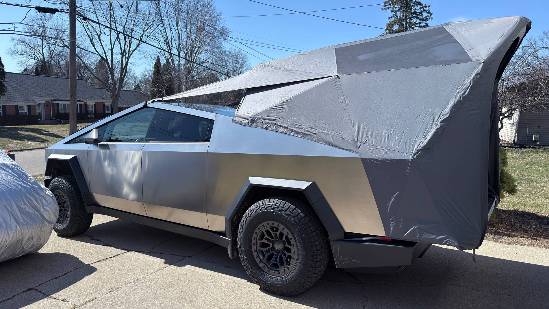

I installed mine a couple weeks ago. They couldn't deliver such a large box to my house, so they said I could pick it up. Things I really like that they redesigned:
1) the crossbeam no longer has screws you need to remove each time, but quick release clips. You have to swap out the brackets and two new screws provided.
2) No zipper anymore to break
3) No click when you fold out the legs
4) back of tent clips under the wheel well
it was very windy, but the tent was sturdy. I also bought a couple of air mattresses for it, and pillows. Very comfortable!
