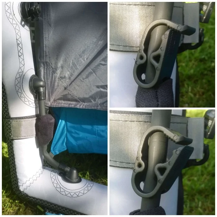

I'm hoping folks can post their own experiences and tips related to the Cybertent here! I'll go first -
On my latest trip, after inflating, I noticed one whole section of the tent was limp and uninflated. At first I thought I had a leak somewhere, but that turned out not to be the case. I knew about the air lock values between chambers, but it wasn't obvious how to open them, so I ended up just attaching the pump to the uninflated section, pumped it up, and all was well.
So those air lock valves are hidden under the little neoprene covers, and while it's clear you can squeeze them to close, it wasn't clear (at least to me) how to open them. After much searching, I finally found a picture online that shows exactly what the clips are, how they work, and how to release them:
Tesla Cybertruck Cybertent tips and tricks Photo-05-05-2014-13-03-53
So I slid back the neoprene, released the clip, and everything started working as expected again.
[props to Bushcraft Days for posting the above picture on their site - it's literally the only picture I was able to find!)

That’s great. What’s the purpose of these valves? Mine must be open because I inflate the whole tent from a single corner.

Yep - normal operation is to have them all open, so you can inflate/deflate from a single port.
I think the idea is, if you get a leak in the tent somewhere, you can close off that section so the rest of the tent remains fully inflated. Or if you're in a super windy environment (maybe a blizzard in Iceland or something) you can proactively close them all after setting up, "just in case".

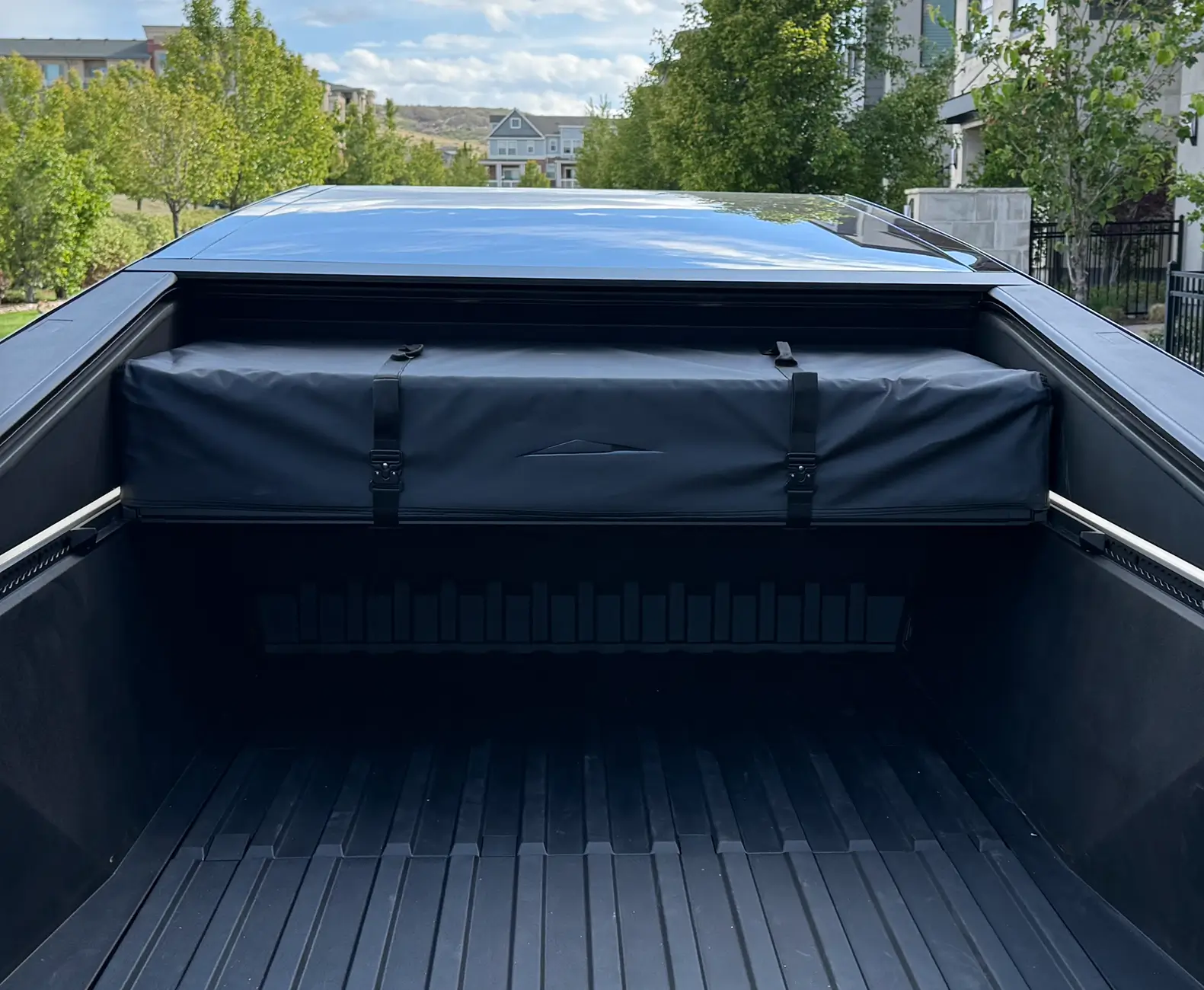

So there are (at least) two versions of the tent. On the older one, the cover has the sides that zip or velcro or something (pic from @TownBiz):
Tesla Cybertruck Cybertent tips and tricks {filename}
On the newer version, the cover is all one piece and just drops over everything:
Tesla Cybertruck Cybertent tips and tricks Screenshot 2026-06-17 at 10.53.27 AM
I have the newer version, and it's not too difficult to get the cover on - my personal "trick" is to sort of be thinking about the cover while pushing the tent down before latching it, but that's probably pretty clear to everyone who has one, so I don't think I'd call it a "tip". :)
If you have the older one, I can't help - I've heard it's much more of a hassle to get it closed!

I have the newer one but the back (rear window side) tends to get caught up on the corners making it difficult to stretch the front over the corners if that makes sense. Maybe I should loosen the torx screws that hold the thing down and slide the whole assembly slightly forward on the brackets to create some space back there.

Ah! Ok, makes sense. So the last time I did it a couple of days ago, it was the smoothest re-cover I've done, and heck, one point makes a line, right?
What I did was after it was folded down, but not latched, I sort of wiggled the sides around a bit so they were near the sides and not about to be pinched down when the tent closed, then I pulled up on the back of the cover in the center. It seemed to pull up pretty nicely, and it seemed like everything sort of "loosened up" and had a bit more slack on the sides to play with. I then latched the center, and the sides seemed to pretty much come right around.
I realize this is pretty vague - lol. I'll report back if I come up with anything that's somewhat reproducible, unless someone else pipes in with a secret way to do this easily before then! :)

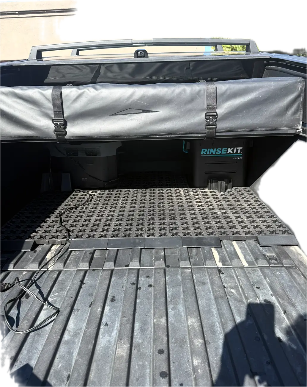

Ok..I’ll throw a tip in the ring here while we wait for other contributors.
Whether you’re a full bed t-mat person or not, using a short piece of it under the cybertent both helps with organization/securement and makes anything under there infinitely more accessible because it can be slid out as a unit and accessed from the top.
Not my finest vault photo but just to illustrate the point.

Wow, I hadn't heard of t-mats, but this is kind of amazing. And I was literally just chatting with chatgpt about ways to organize my camping gear lol. If you have a sec, a few questions -
1. In another thread I read they're about 1cm high - and it sounds like the husky boxes won't fit under the tent with them - does that match your experience?
2. With the full bed t-mat, and the tent fully deployed, will the mat slide out between the tent legs? Or are the legs not wide enough to let it slip between?
3. When you have a bunch of heavy-ish stuff on the mat, can you really just slide it out like a drawer? Or is there too much friction to make it easy to slide? (again thinking of the full mat, but any experience would be great)
4. Is the top slippery? Like, if you put a plastic box on top, is it going to slide around, or is it similar to the truck bed surface, or...? I get you can use the t-mat blocks to hold stuff in place, just wondering about the general slipperiness without them.
