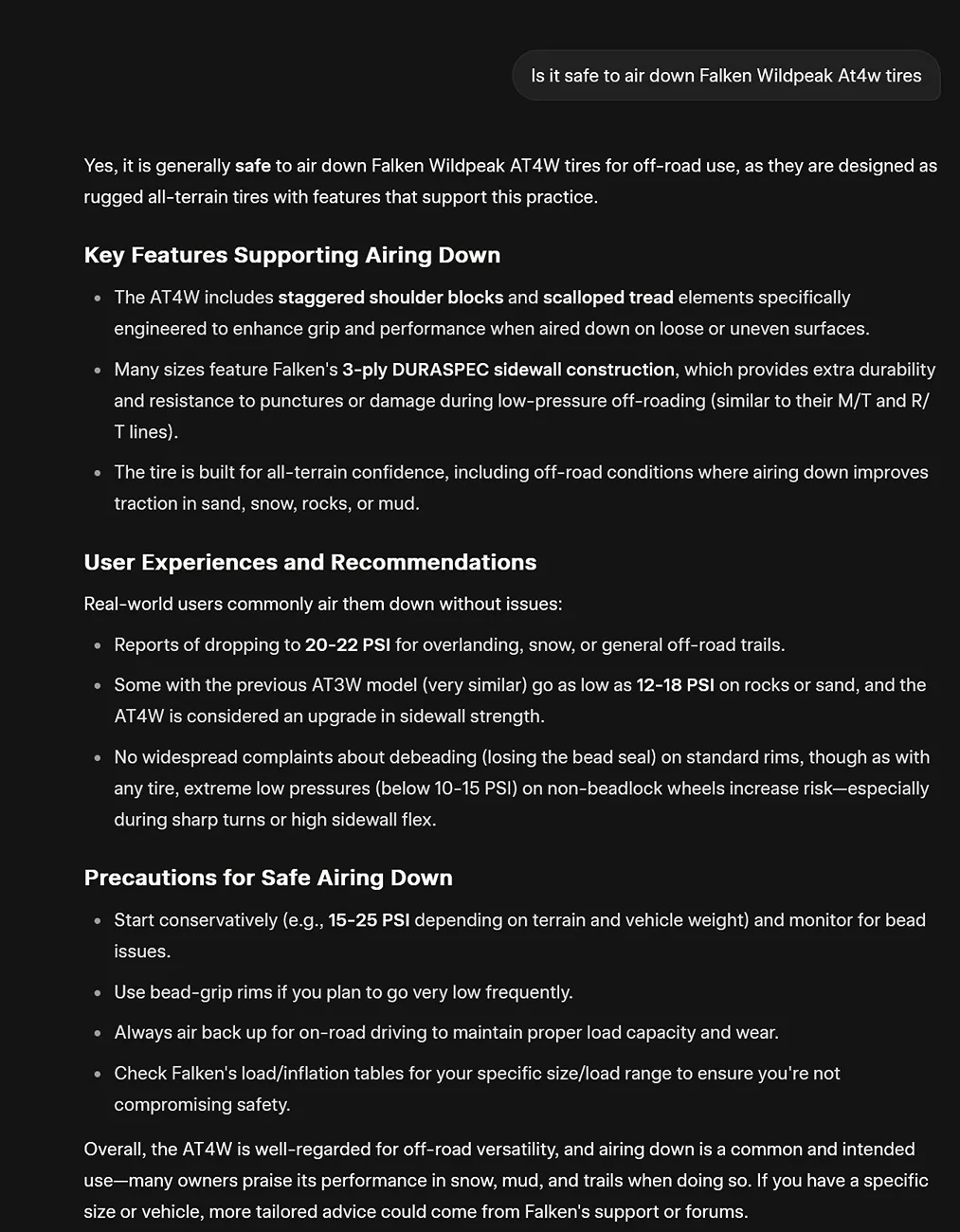

Thank you for the advice, I will keep it in mind. Does it still apply to my particular setup given I am running Wildpeak AT4Ws for tires and they are on properly beadlocked wheels?
I don't know, but I doubt it. That sounds more like AI summarizing user advice than a tire engineer providing knowledge based upon extensive durability testing at different weights and pressures.
I'm not familiar with those tires, I suppose they could have a construction more tolerant of airing down to 15 PSI but I doubt it. The really odd thing is they are calling 15-25 PSI "conservative" and yet there is no mention of the tire size or the load on the tire (loaded vehicle weight). I would call it BS simply based on that.
The best advice is if you don't need to air down to 15-25 psi, because the conditions don't require it, then don't do it.
This could have been a defective tire but the user did indicate that had previously aired them down. Read the comments too:
Falken Wildpeak blow out : r/tires
