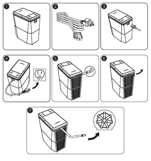

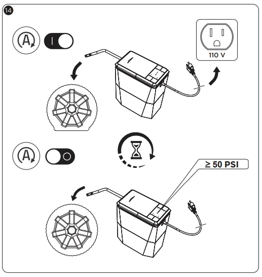

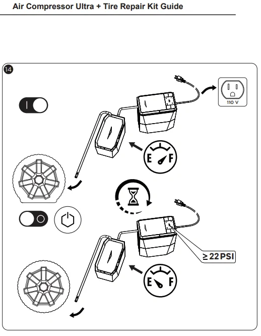

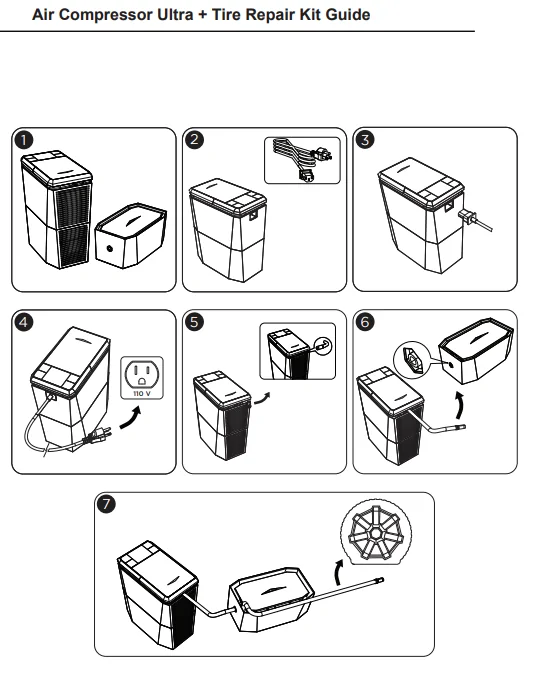

For the group: The compressor does NOT have a handle - at least according to the 'Manual' which we are to take as 'God's word' so...if you think you found one , put it back!

No, there is a handle on the actual compressor.
No there is not!...According to the Manual - there is NO mention of a handle. Perhaps it is a 'field antenna'?. You should put that back down immediately! ;-)
