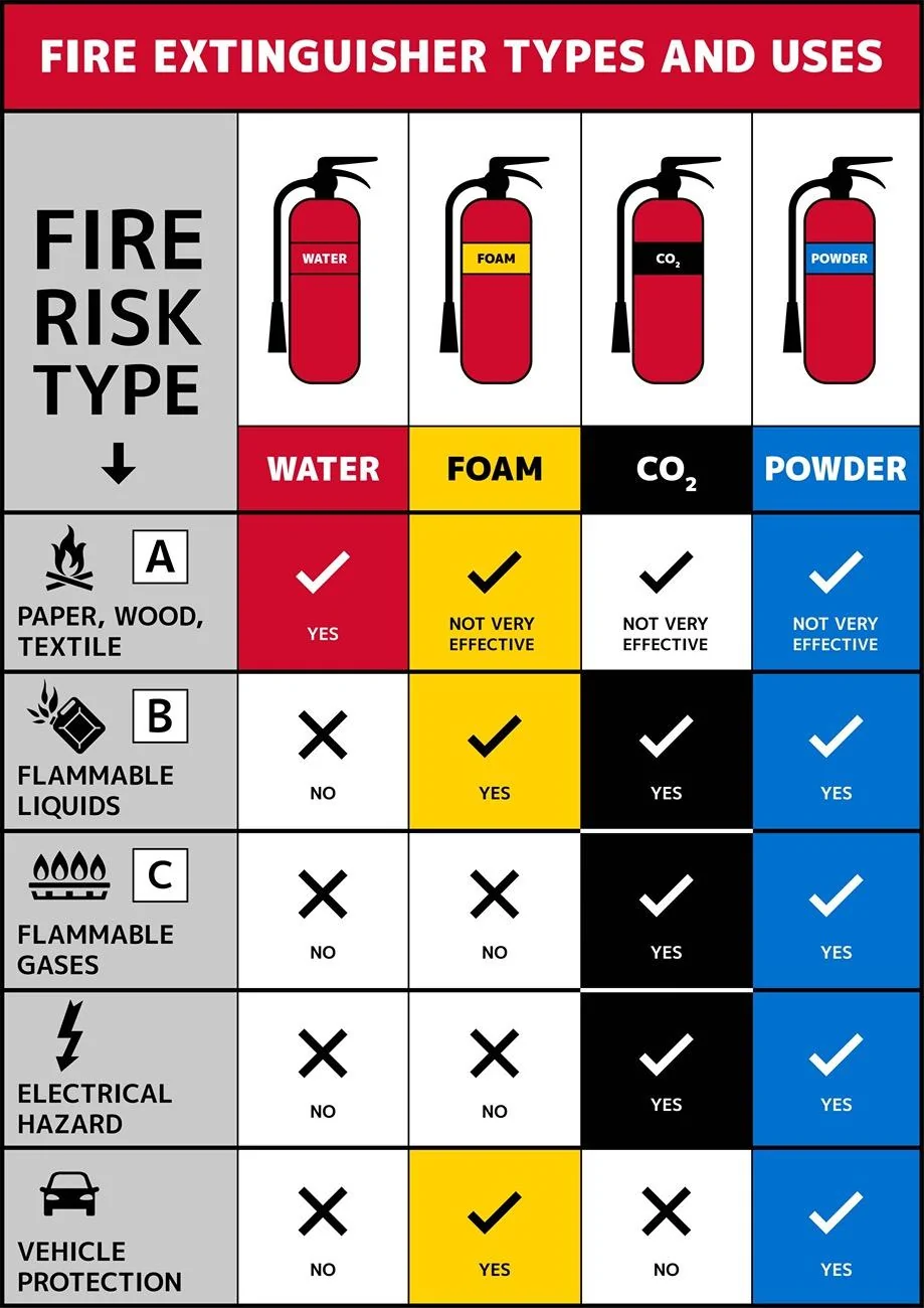

I’m just going to add this sticker to my tailgate..

Batteries are not listed on your chart.
Again, lithium batteries contain their own oxidizer, so your only choice is to reduce the temperature, which a foam or powder extinguisher does not do.

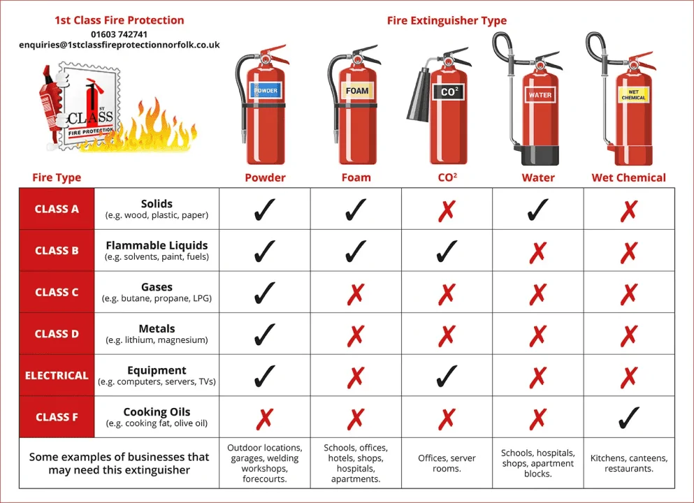

A fire like that falls under a Class D or Electrical.

No, no it would not. Both of those are about interrupting the air flow to the metal, the powder interferes with the combustion by raising the oxygen levels needed.
Again, the battery contains its own oxidizer. And the powder would be ineffective at entering the combustion inside the cells... not to mention would be unable to stop the oxidizer from mixing with the lithium polymers even if it did.
