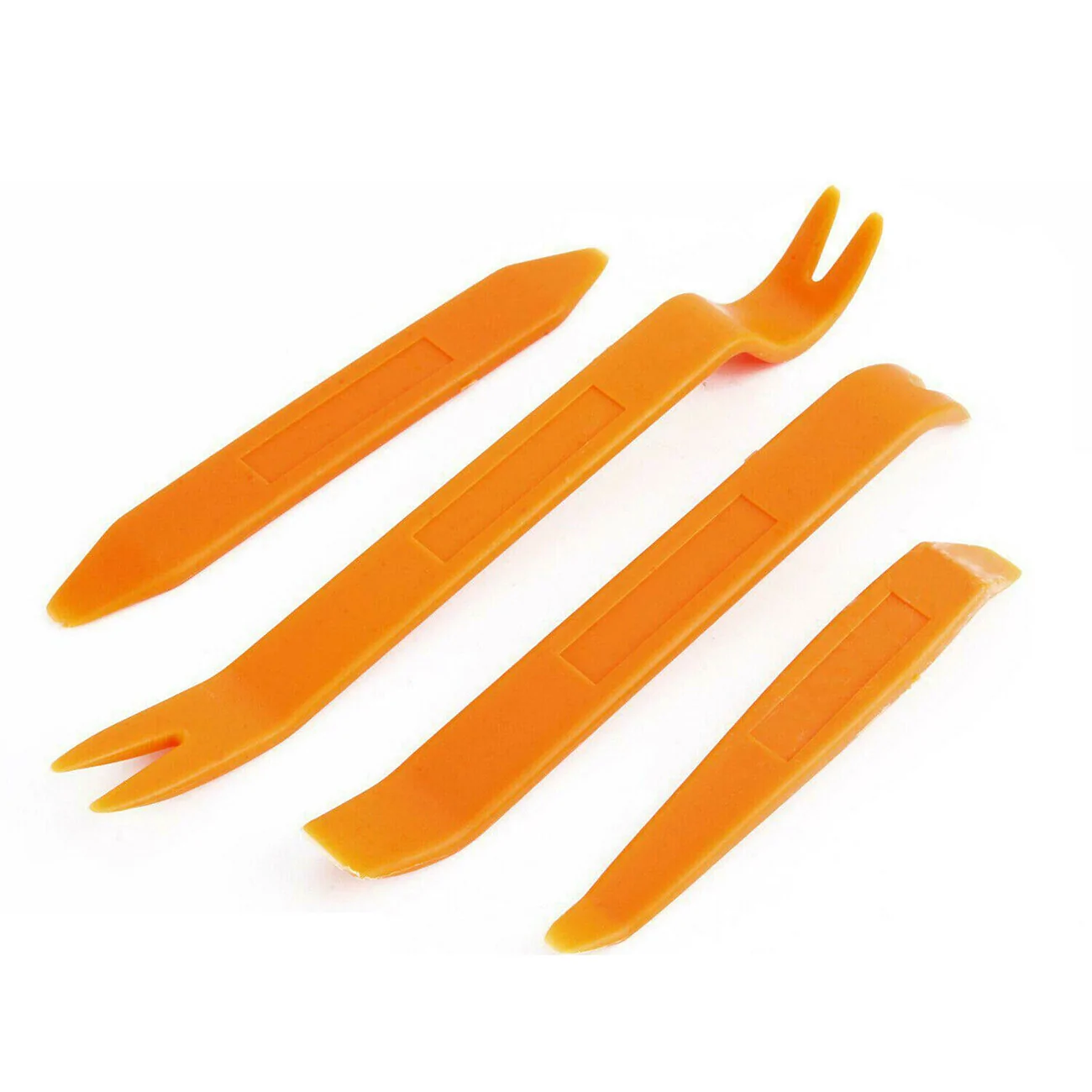

If you have Tesla Store Credits or simply want to burn some cash, I wanted to make it clear that the Cybertruck Projection Lights (from Tesla) will fit for both front and rear doors. Each package comes with a set of light (x2) and is indicated with a "R" and "L", so you will need 2 packages / sets, and install accordingly. One huge piece of advice I can provide is this: Find and use a plastic flat trim tool to take out and install the new lights. The reason for this is because the "leather" / leatherette wrap around the light is extremely prone to damage - you have no idea. Luckily it's on the underside of the door, however proceed with caution.
