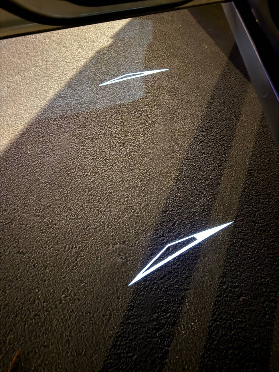

Did any of you struggle on the back doors, did you have to cut a bigger hole?
I just ordered one pair to test and my rear doors seemed to have a smaller hole.

So, yes... a bit of a struggle, but they did pop in without needing to modify anything. THIS maybe why they only recommend the front. I honestly thought I was losing my mind with the rears bc I got the fronts in a lot easier and got cocky.

I actually had to modify the front holes a little bit, and had a much easier time with the rears.

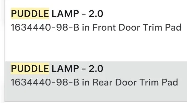

Given the front and rear doors use the same stock part, it's not surprising the new ones work in both locations. Only possible issue could be due to interior door clearance if the new modules are larger.

They are a little tight fit but they will go in without modifications. Just make sure you are putting in the correct lamps for the Right (passenger) and Left (driver) sides.
I didn't realize they were side specific, but they are. They have the markings on the light housing.
