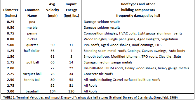

So how do garages and homes fare in this kind of hail?
Tesla Cybertruck Cybertruck size vs. Model Y and S (spotted at supercharger together) 1697601039383
Tesla Cybertruck Cybertruck size vs. Model Y and S (spotted at supercharger together) 1697601123418
Tesla Cybertruck Cybertruck size vs. Model Y and S (spotted at supercharger together) 1697601285733

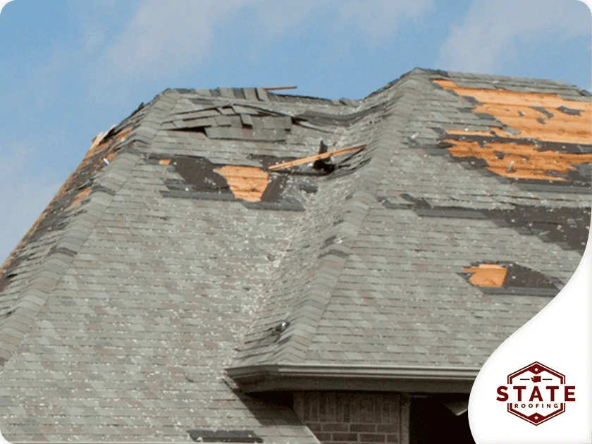

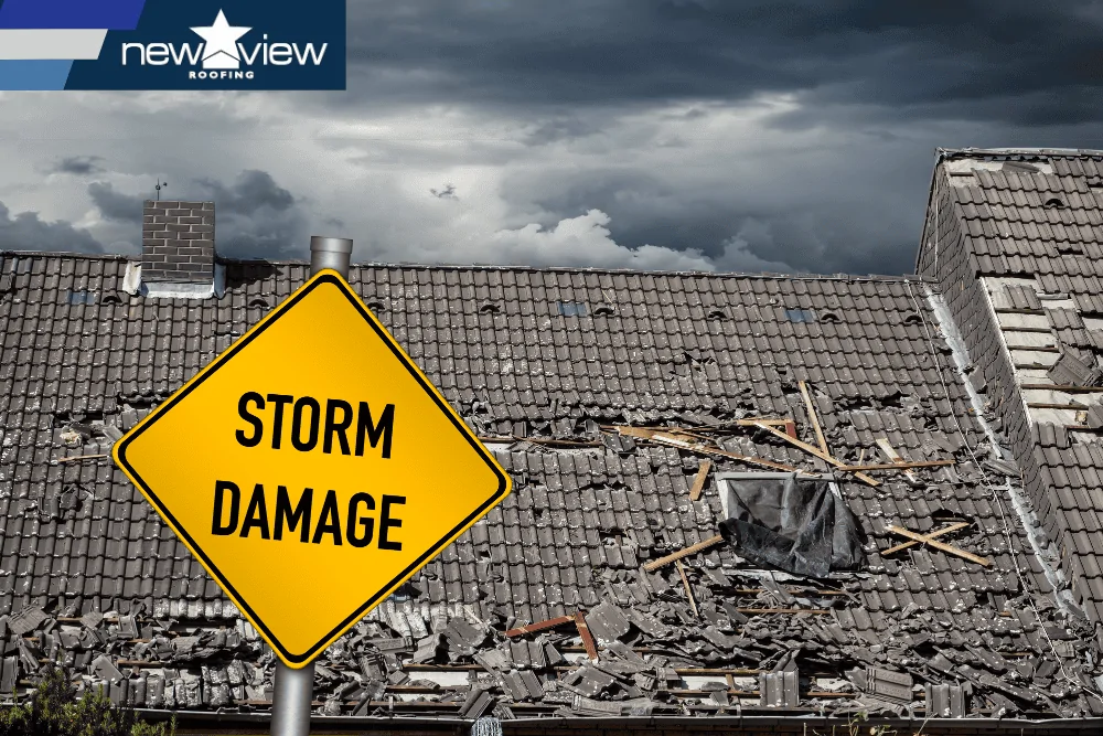

WHAT SIZE OF HAIL CAUSES ROOF DAMAGE?
Any size of hail can cause damage depending on the roof’s condition and the speed of the hailstones. In terms of resilience, metal roofs outperform asphalt. The following size guidelines give an idea of possible damage.
  • ¾” Hail – Though the smallest hail we measure, it can still be devastating depending on wind velocity. Large hail destroys vinyl siding, window screens, metal fascia, and deck paint. It also damages asphalt shingles, gutters, and downspouts. Due to its small size, hail under one inch typically goes undetected
  • 1” Hail – After 1”, shingle underlayment is bruised, and siding, gutters, and fascia are severely damaged. Wind speeds will affect the level of damage, and roof damage will resemble that produced by smaller hail.
  • 1¼” Hail – The severity of hail increases by 14%. Hail can turn your roofing into swiss cheese. Even without wind, this hail will do damage by dropping from the sky.
  • 1½” Hail – Large hail causes substantial property damage. If you live in a hailstorm, you need to take precautions to protect your property.
  • 1¾ – 2” Hail – Now the hail is big enough to pierce softer roof components like ridge caps or plastic roof vents. When combined with wind, this size hail can completely remove siding, fracture windows, and damage most metal fixtures.
  • 2” Hail – Anything larger than this will severely damage your property. We no longer inquire “if” you have property damage, but “where.” Immediately after a storm, hire a roofing contractor with insurance experience.
Tesla Cybertruck Cybertruck size vs. Model Y and S (spotted at supercharger together) 1697603558657
And then I found this info about the UL 2218 roof Impact Rating.
Tesla Cybertruck Cybertruck size vs. Model Y and S (spotted at supercharger together) 1697603917173
Basically the test is to drop a steel ball to see if it causes any damage. Interesting that the Class 4 test looks very similar to what we saw Tesla doing to test their glass. Someone should ask what the class rating is of the CT glass and body panels. From what I've seen, it is far better than UL 2218 Class 4.
Tesla Cybertruck Cybertruck size vs. Model Y and S (spotted at supercharger together) 1697604332937
Tesla Cybertruck Cybertruck size vs. Model Y and S (spotted at supercharger together) 1697604352838
Given the damage scales above, I'm still thinking that for any hail less than 3" I'm not worried about my CT. Far more important to deal with protecting my home than the CT. So unless I end up living somewhere that has 3" hail on a regular basis I'm not going to worry about hail damage. If something only happens once in a blue moon, then the best way to handle it is with insurance instead of living a life being scared of the random issue that most likely will not ever befall me.

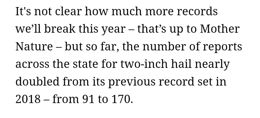

Yes, but extra protection doesn't mean unbreakable.
We have had 892 severe storm warnings (1 inch or greater hail inbound).
And report of giant hail hit a record this year. 170 reports of 2 inch or higher hail.
And a record 5.25 incher.
Obviously everyone wants the toughness. But this anti garage stigma because the truck is tougher is silly.
You're free to use the truck your way. If you don't think anything will happen to it that's great. And honestly it probably won't. But what is gained from the garage shame?

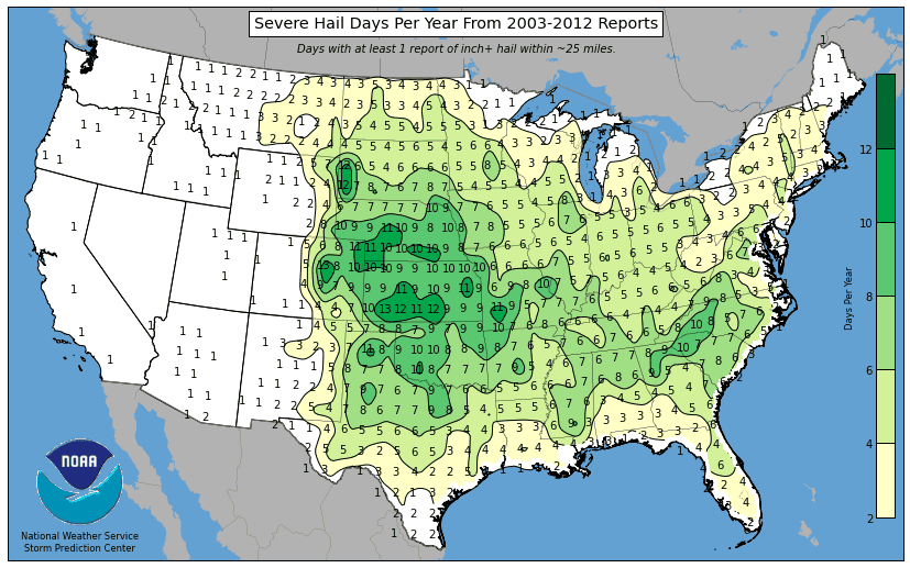

Here is some older data but it is for hail of at least 1" or more:
Tesla Cybertruck Cybertruck size vs. Model Y and S (spotted at supercharger together) 1697605847349
There are quite a few 9's or 10's in there but I only see a single 15 (happens to be right in Colorado) and a couple 12's, 13's. And keep in mind this is for hail 1" or larger. Yes the 2" stuff happens but given the numbers of 2" hail incidents reported and spreading them over the whole eastern side of Colorado I'd guess it is rare for any single vehicle to get hit by more than 1 storm per year. And even at 2" I'd put money on the CT coming through that unscathed.
Now since the 15 on that map above looks to be right on top of Denver (or at least pretty near there), if I personally lived in that area, I'd be starting to look at alternatives to my current situation because the hail was getting to be too expensive to deal with and more of a hassle than it was worth.
And while I do live out here in the PNW at the moment, I'm not entirely inexperienced with the level of hail you are describing. I came from the midwest in an area that the map lists as a 10. While I may be sympathetic to your situation, I'm also hopeful that the CT we are talking about gives results that many (even here) do not seem to realize yet. While on this board, I'm only concerned with the CT and it's implications. Where you decide to live, the impacts that things like hail have on your life, I don't see as issues that we need to directly address here.
