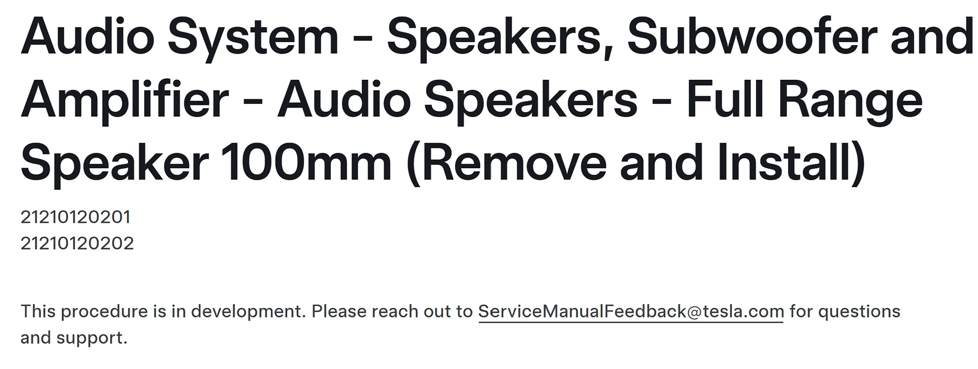

I wish Tesla would update the service manual on how to remove/install the dash cover and dash speakers. A tech told me the steering wheel has to come off and requires Tesla to recalibrate before it'll drive, and that it can't be done remotely. I guess the answer is to swap out the speakers in the service center parking lot LOL!
Anyone figure out the process on removing the dash fabric trim over the speakers yet? I'm planning a full system upgrade with DSP, amps, 12" subs, and speakers -- that's the main thing holding me back from getting started at this point.

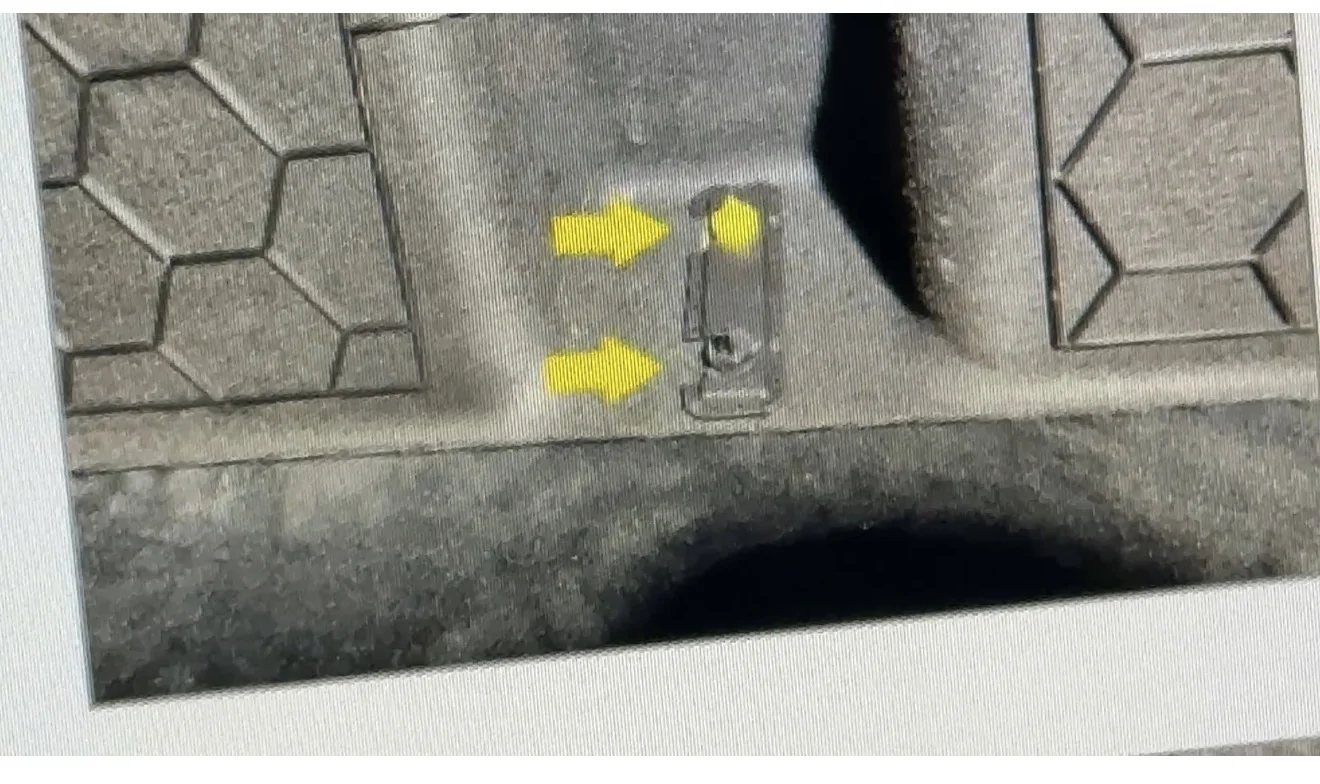

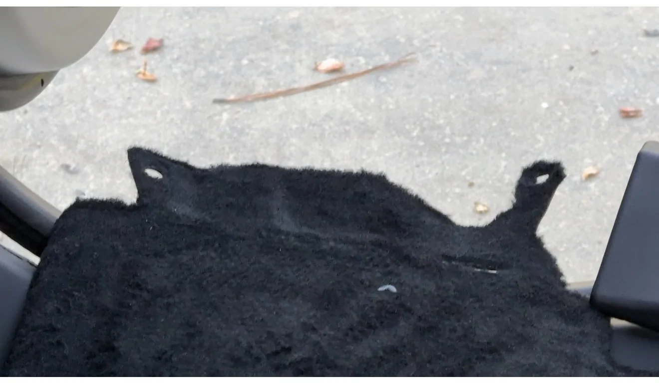

Speaking of this the subwoofer access manual also was not accurate based on my build. Showed only 2 push clips but I actually had four.
Tesla Cybertruck Cybertruck Speaker upgrade from Light Harmonic IMG_9230
Tesla Cybertruck Cybertruck Speaker upgrade from Light Harmonic IMG_9229

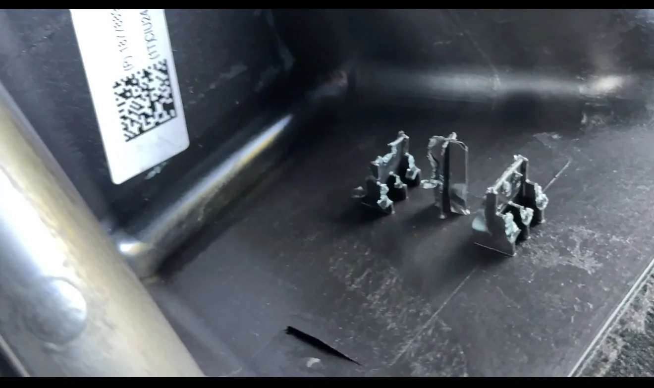

And the clips holding the panel to the frame was suppose to be these
Tesla Cybertruck Cybertruck Speaker upgrade from Light Harmonic IMG_9231
Instead I had these plastic clips that had a metal clip on top of them that I basically ripped off.
Tesla Cybertruck Cybertruck Speaker upgrade from Light Harmonic IMG_9232

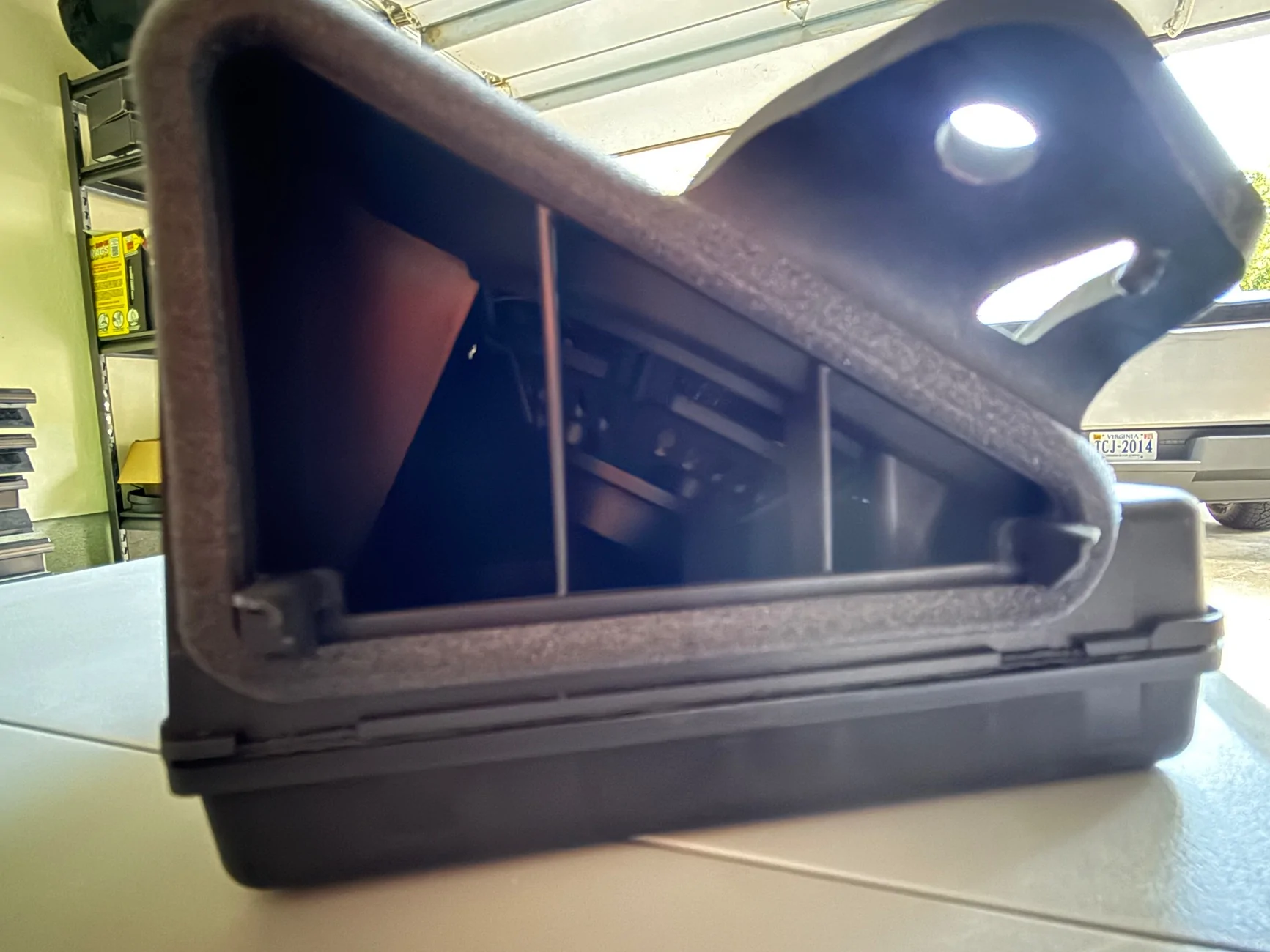

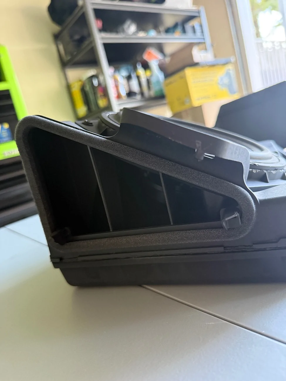

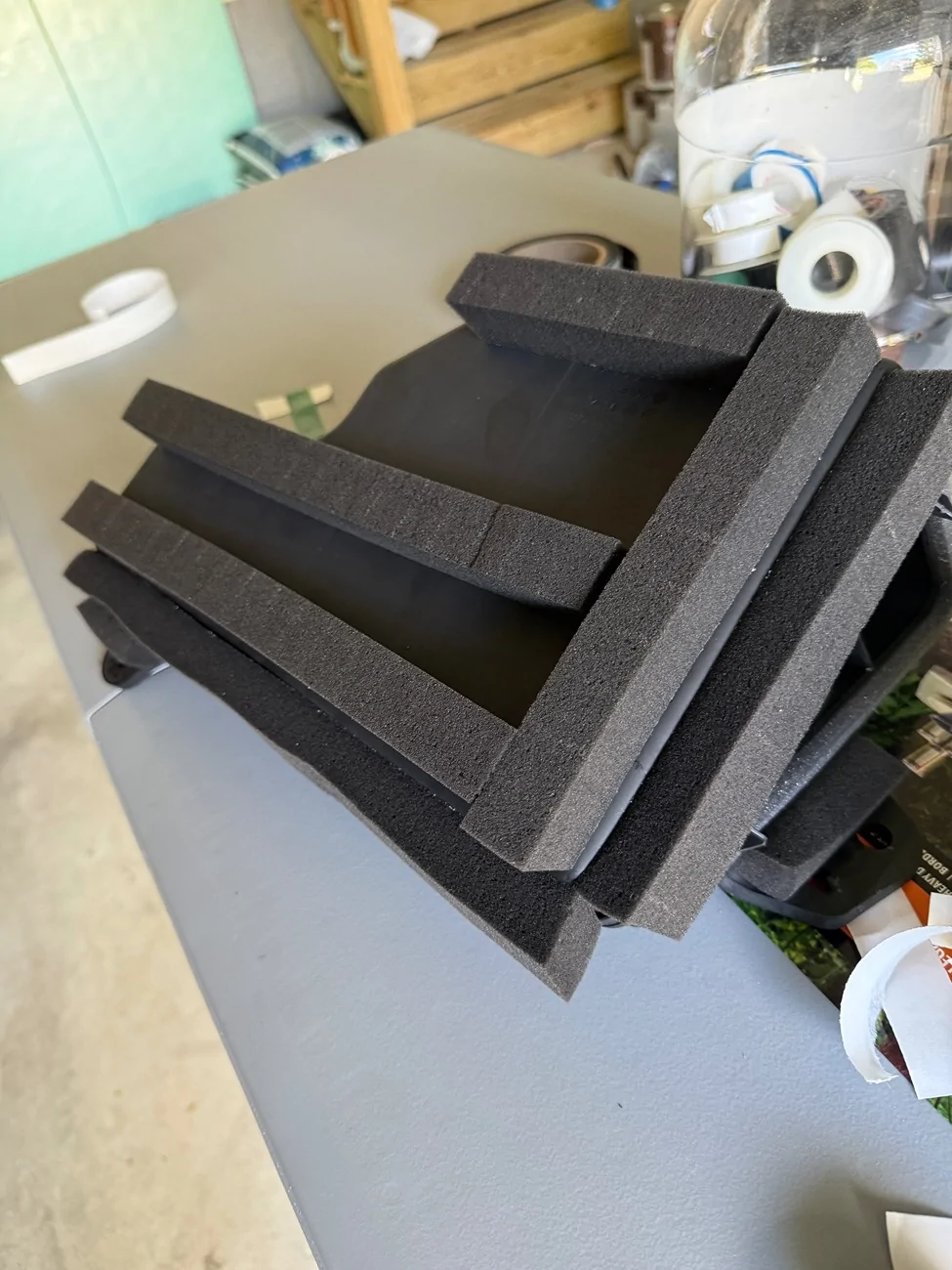

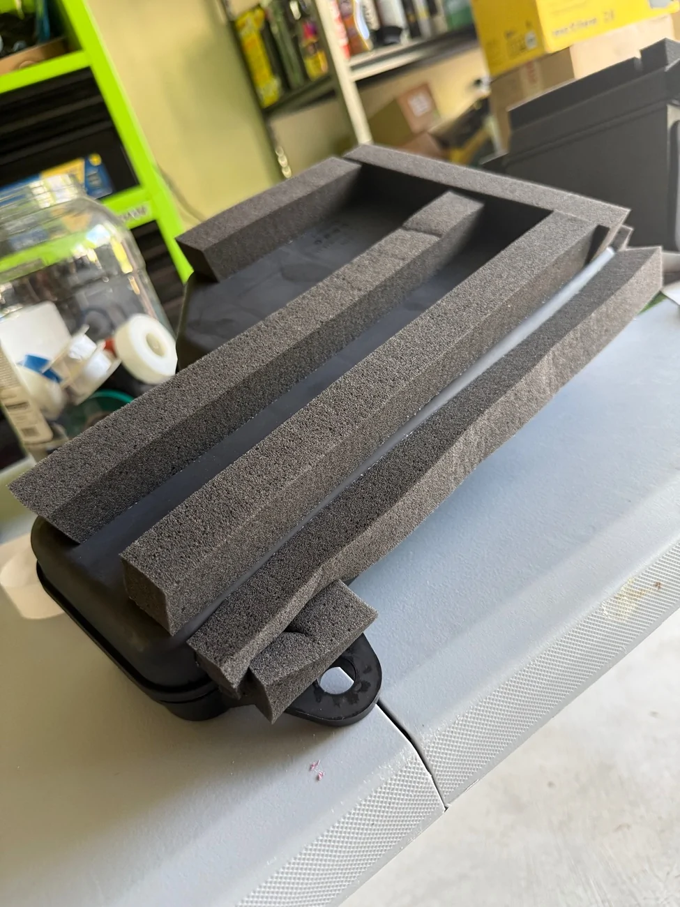

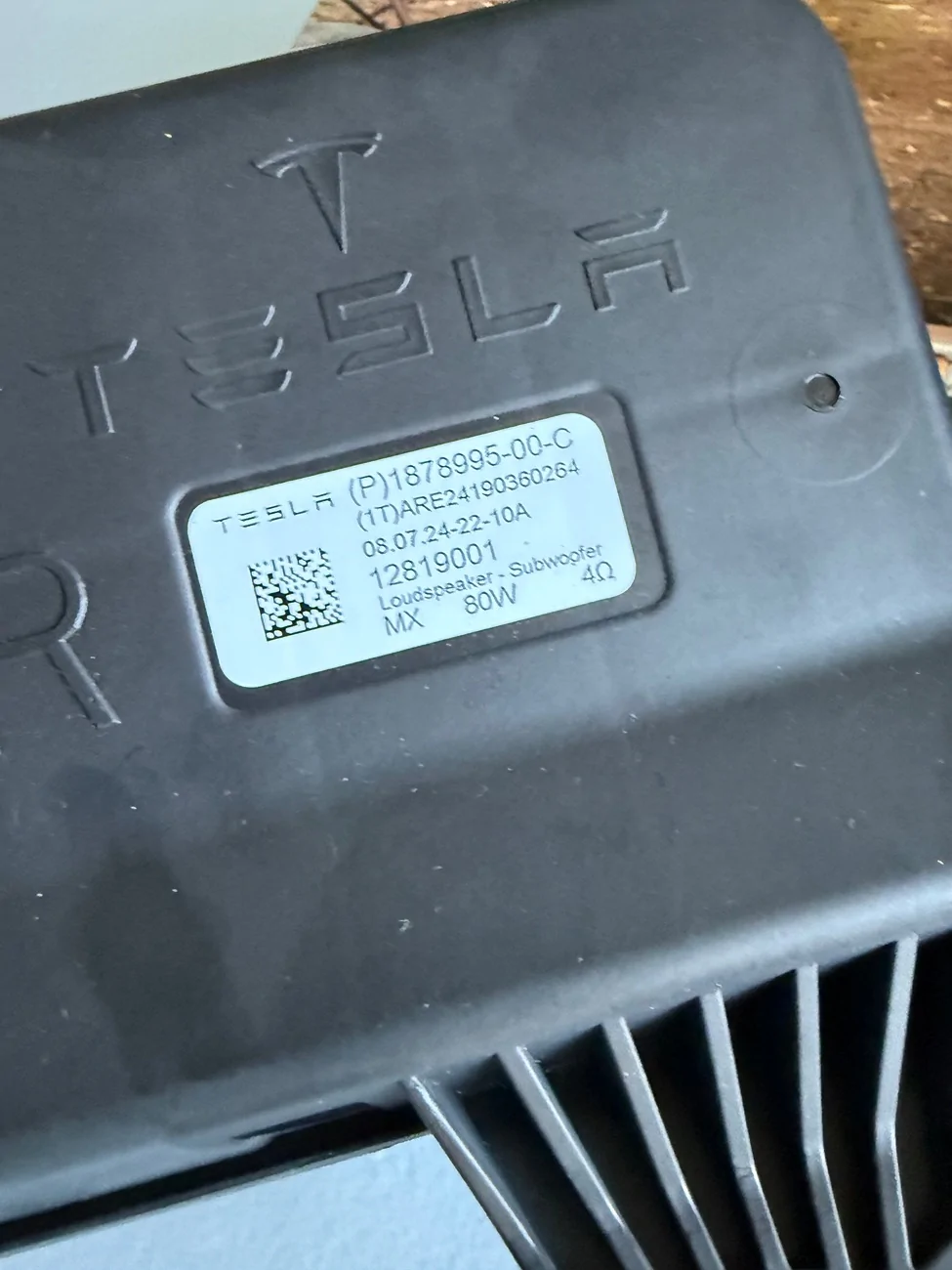

Finally took the subwoofer completely out the truck today to add some backing foam.
There is now no rattles coming from the housing . I may have went a bit overkill but more is better sometimes.
Also hot a chance to actually visually inspect how the cybertruck port opens to the frame of the vehicle to use the frame as displacement for the subwoofer.
Interesting design for sure.
here are some pics of what I used and how I applied it to the enclosure. Also a pic of the port that opens to the cybertruck frame.
