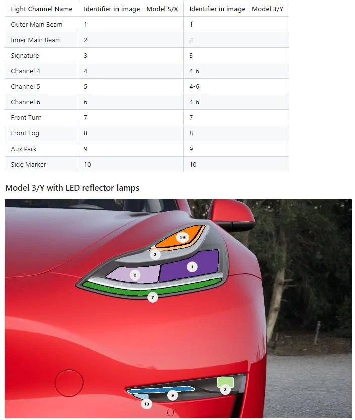

There are more light shows here
https://teslalightshare.io/
It's very fun, easy to create one. Just a little time consuming. It's important to understand the mapping of the light channel to the Cybertruck. Then you just turn on/off each channel based on the music track.
Any tricks to getting light shows to work on Cybertruck? I have tried everything!
